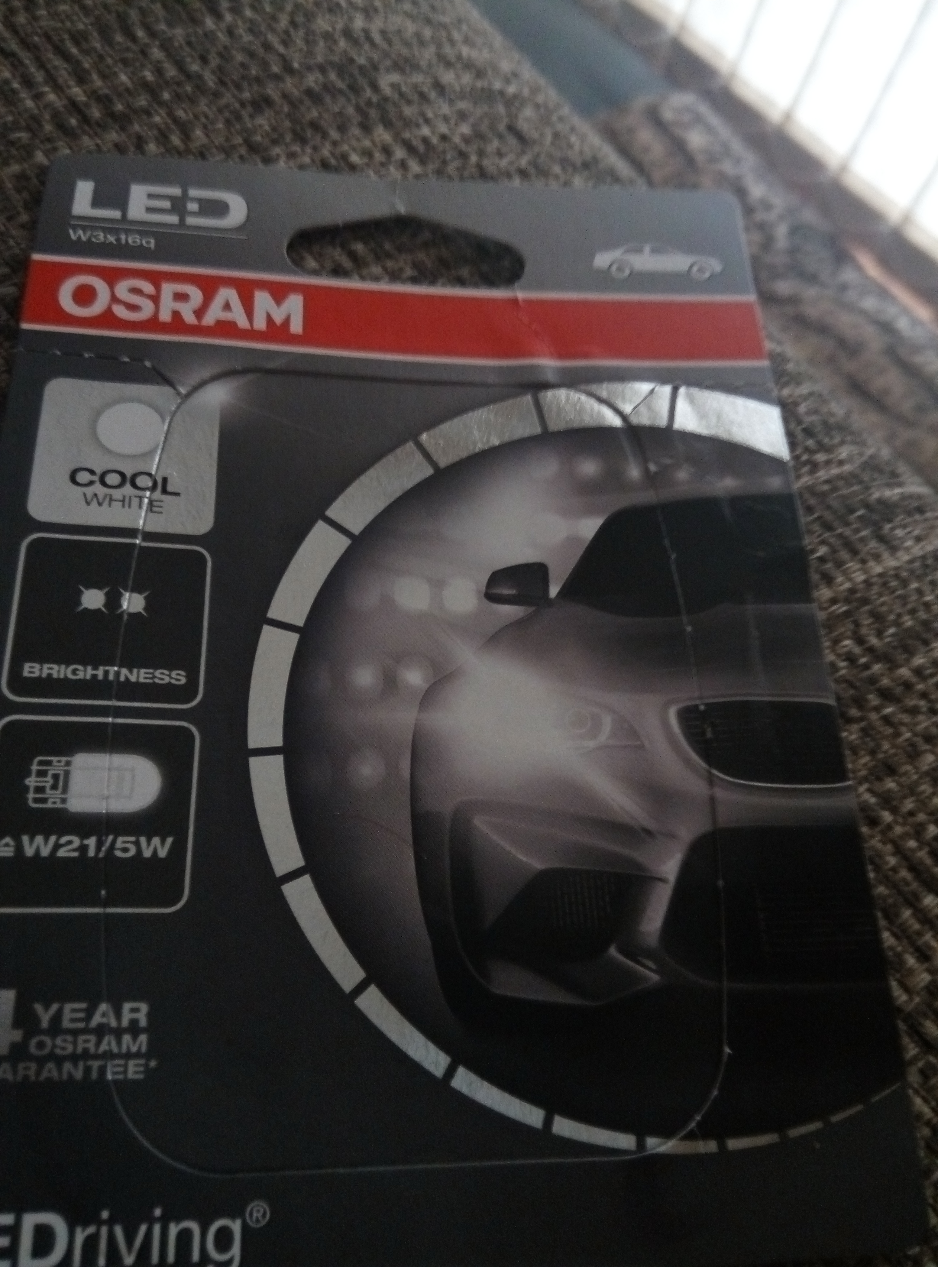

LED DRL's not working as side lights....
So, I went for a DRL LED Upgrade from Osram but there is a problem
They work brilliantly as DRL's but when I turn on side lights and headlights, they stay off.
I presume I've bought bad bulbs but does anyone have any advice on what LED DRL's would work??

These are the exact bulbs I have, they work absolutely fine. Has the sidelight fuse blown?
Do yours reduce in brightness as they need to when on as sidelights?

They do. Only 2 of the diodes light up when on as side lights. Some Citigo’s list the fuses differently to others, there was a thread here somewhere about it.
I've tried turning them through 180 degrees and no joy. Same with the fuse, checked and all ok with no breaks. They've been swapped out a the moment for some cheap Halfords bulbs which came on, no problems.

I think you have purchased 7715CW-02B instead of 7915CW-02B. I bought the latter and don't find them very bright, trying Twenty20 Cree LED now which look better.
Checking the packaging, you're right. Damn & blast.
