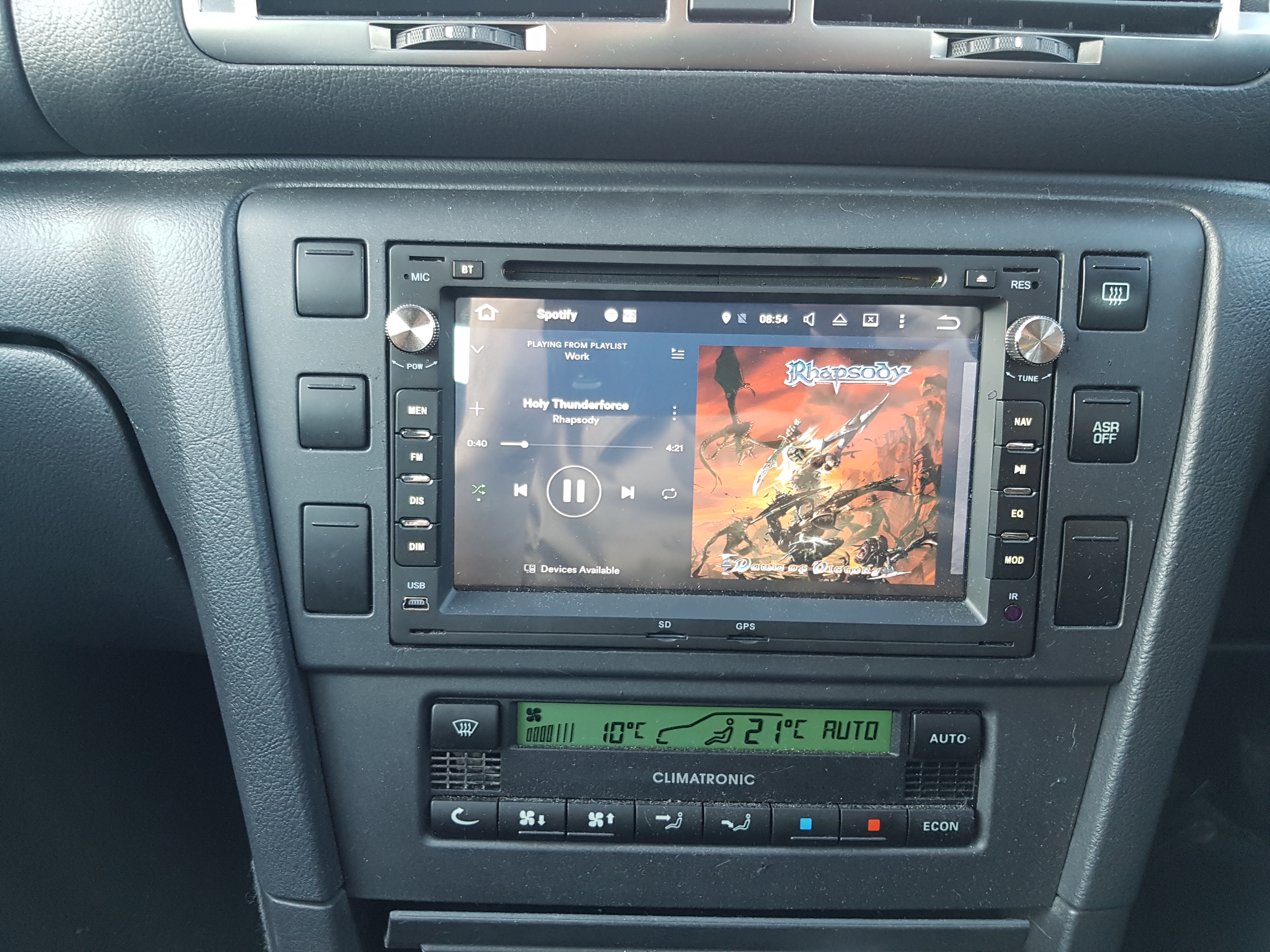

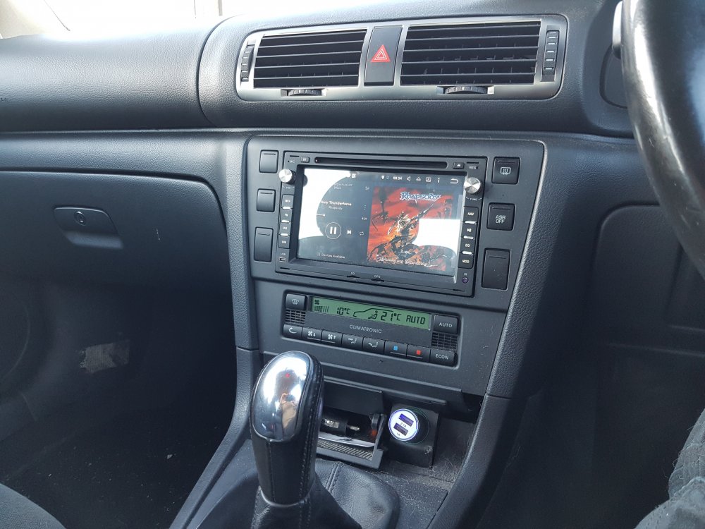

Can you post picture of it installed?

Here's some pictures. One thing I forgot to mention, in order to fit all the extra wiring you will need to remove the bar at the back which helps support the oem radio. I managed without removing the cage, but will be a lot easier with the cage removed. I imagine this would be an issue with most double-sized units, especially if you want to keep steering wheel controls.
It looks better than I expected!
