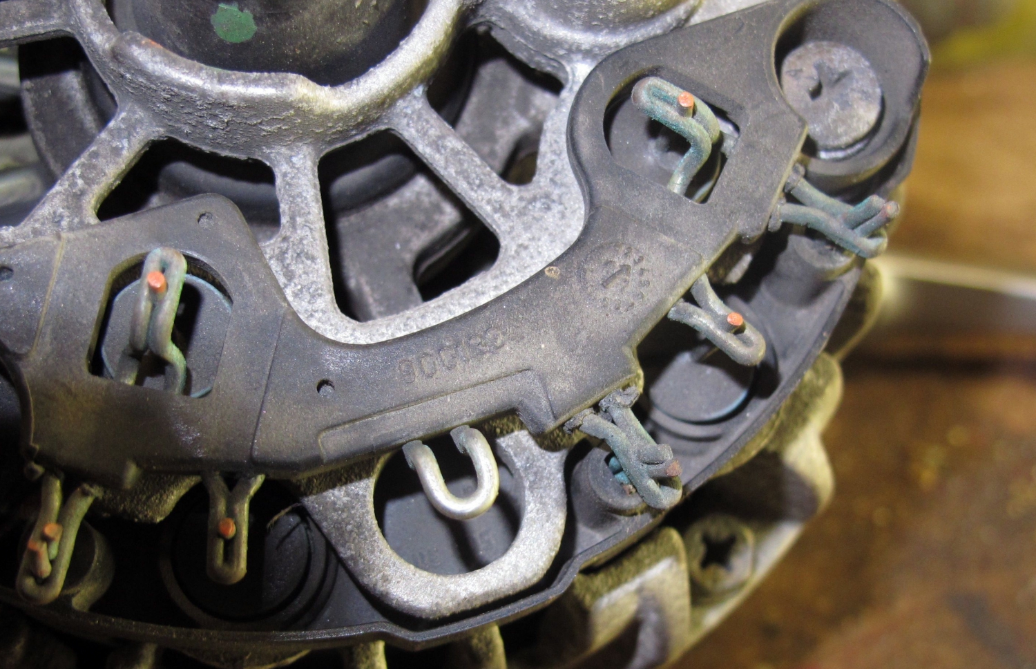

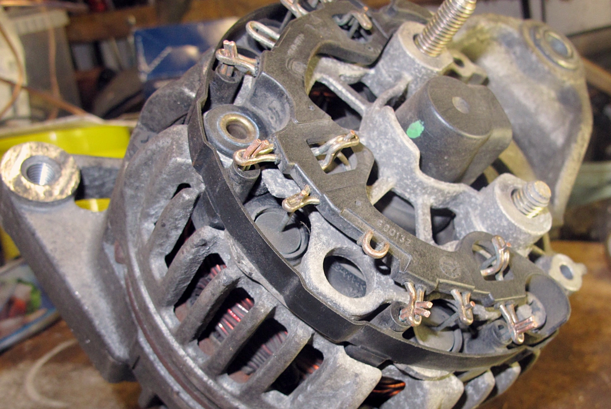

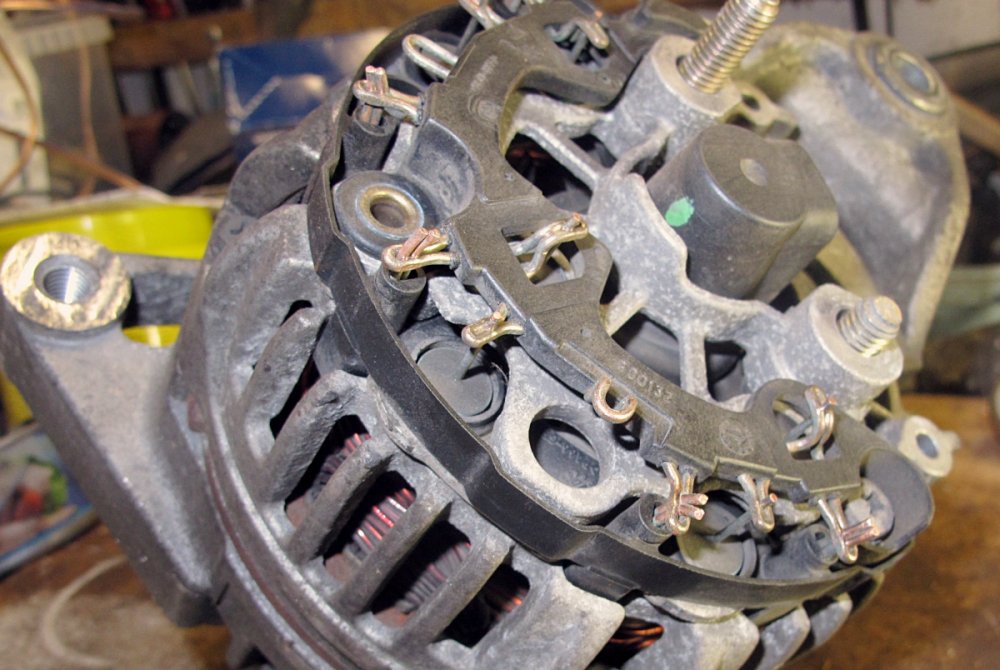

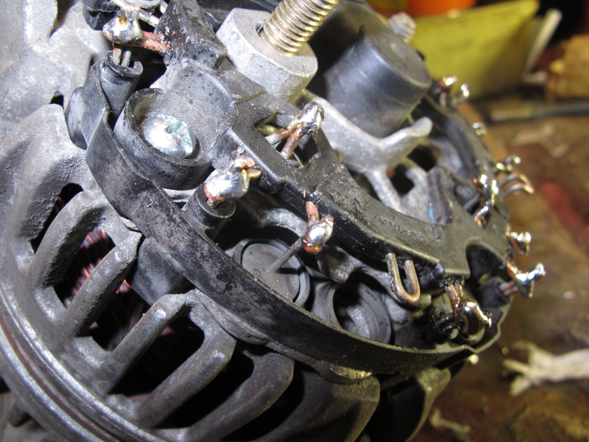

Flickering is the right word I think? To day:
After searching for hours on the web for flickering - shaking light I found only a few sheep who had switched dynemo and regulator for stable tension and stable light.
So today I took out the dynamometer, since it did not help a new controller for a while back.
Checked the links to the diodes, which were clogged, considering that our cars are in a humid climate?
Steel brushed clutches and cleaned with knife, as there was a lot of corrosion. Did not think of measuring once, as my voltmeters have so much internal resistance that they would not give results with Ohm measurement.
Could be powered by, for example. again a light bulb, to measure voltage drops in millivolt. Do not know if I had a rash or become wiser?
Since the excitement is variable, it would be equally good for her to measure the measurements, even with a little power review. So I went straight to the point.
After a good cleaning of the couplings, I went on a big soldering and solved all twelve points. Had to repeat the cleaning on some, even though I used soldering water, indicating corrosion pores in the strands / joints.
Was pleased to have checked with double eyeglasses.
Afterwards the lights were stable and fine, so I had fun with me.
Was on the verge of ordering a new dynamo, I have to admit. But today I had good time and warmth in the garage / workshop.

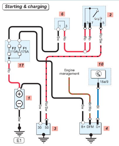

I have a question... Do anyone have a electrical schema that shows where the two small leeds go from the generator? I´m thinking to use one I have extra in an Old Volvo ti get more effect so I can use lights in the middle of the day?
One goes to the battery, The hose have ground, but I should have one for start it - DF+....  My be one is D- and shall go to ground?
Manual or other tips?
Is this any help? ...
