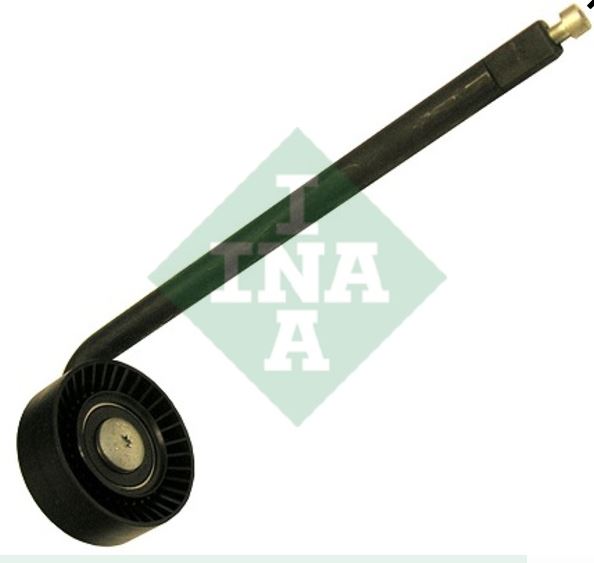

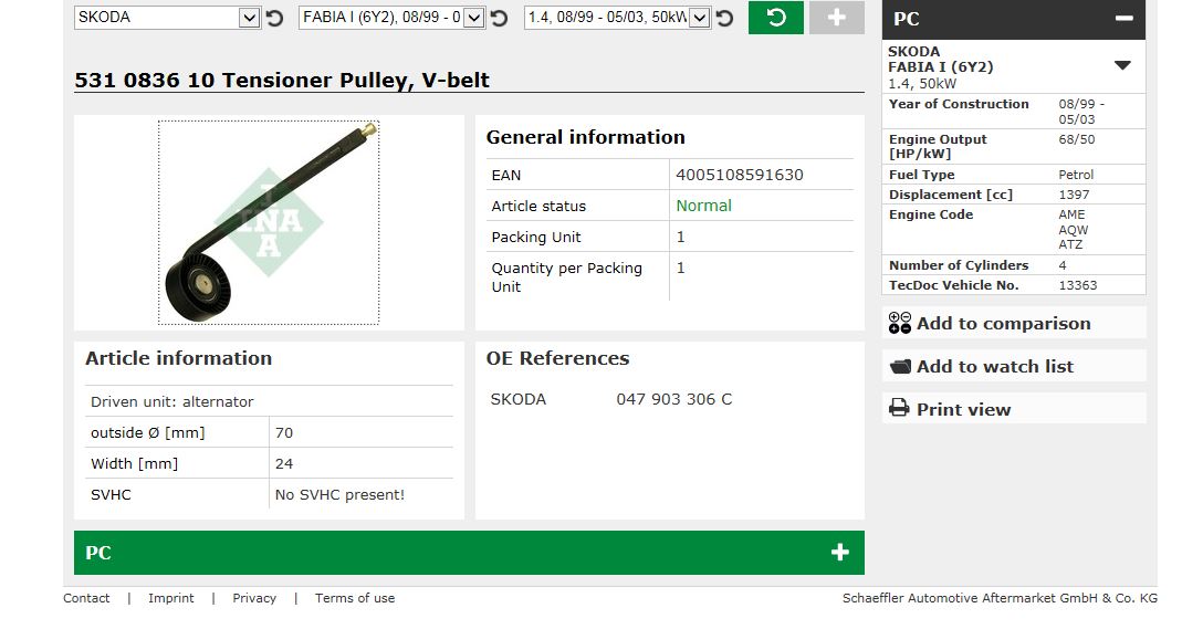

Is this the one?
closer view
nope, definatly not that one....

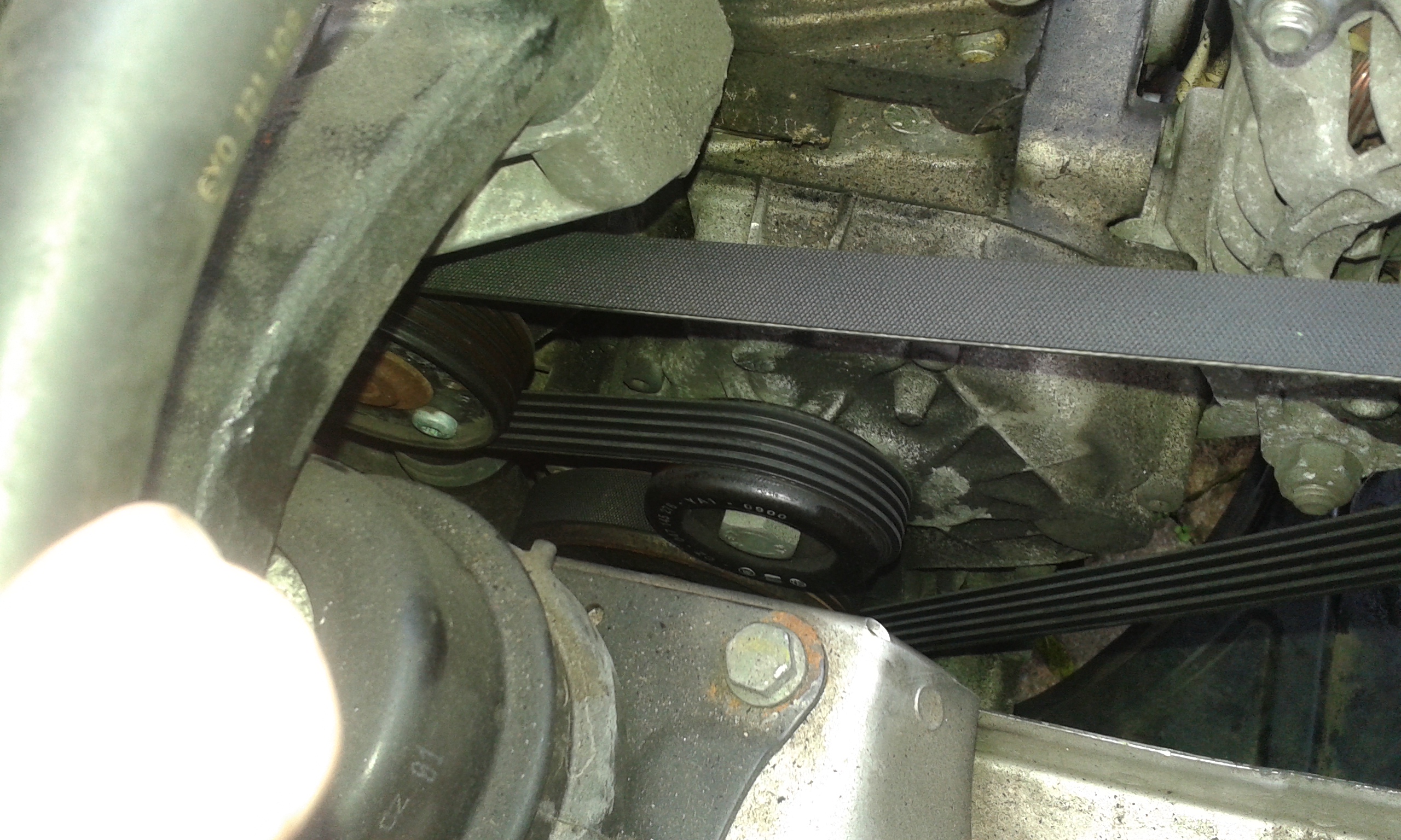

20171004_150500.thumb.jpg.fc2621cdb9ce5363bd4736e2e102629b.jpgas you can see, this literally has a single bolt to the engine, no groves, just a roller pulley and a bearing.

Looks like there's a part number on the outward-facing side. Can you get a phone camera down there?

My eninge is also AQW - non A/C, and I replaced the idler this year. The part number is 047145276. Apparently it fits some VW Lupo models too.
Edited by TMB
I made a tool to get the bolt out and back in again as there wasn't enough room to get a spanner or socket on without dropping the engine. The pulley slides off easily once the bolt is out. If you need the tool I will happily post it to you. Skoda say to use a bit of thread lock on the bolt when replacing. And the bolt thread is left-handed!!

beautiful!! part ordered. and THANKYOU for letting me know its a LHT!!! i would have seriously killed it/needed a helicoil if you hadnt informed me :D
it seems this is an incredibly generic part used by lots of manufactors!! and yes, the part number is in place but half had been scratched off!!!! all these supposed mechanics who have worked on this car in the past should be shot. brake pins rounded, thermostat housing glued... you name it! its a 47k mile car with few owners and all serviced by "reputable" mechanics... she has a good home now!
