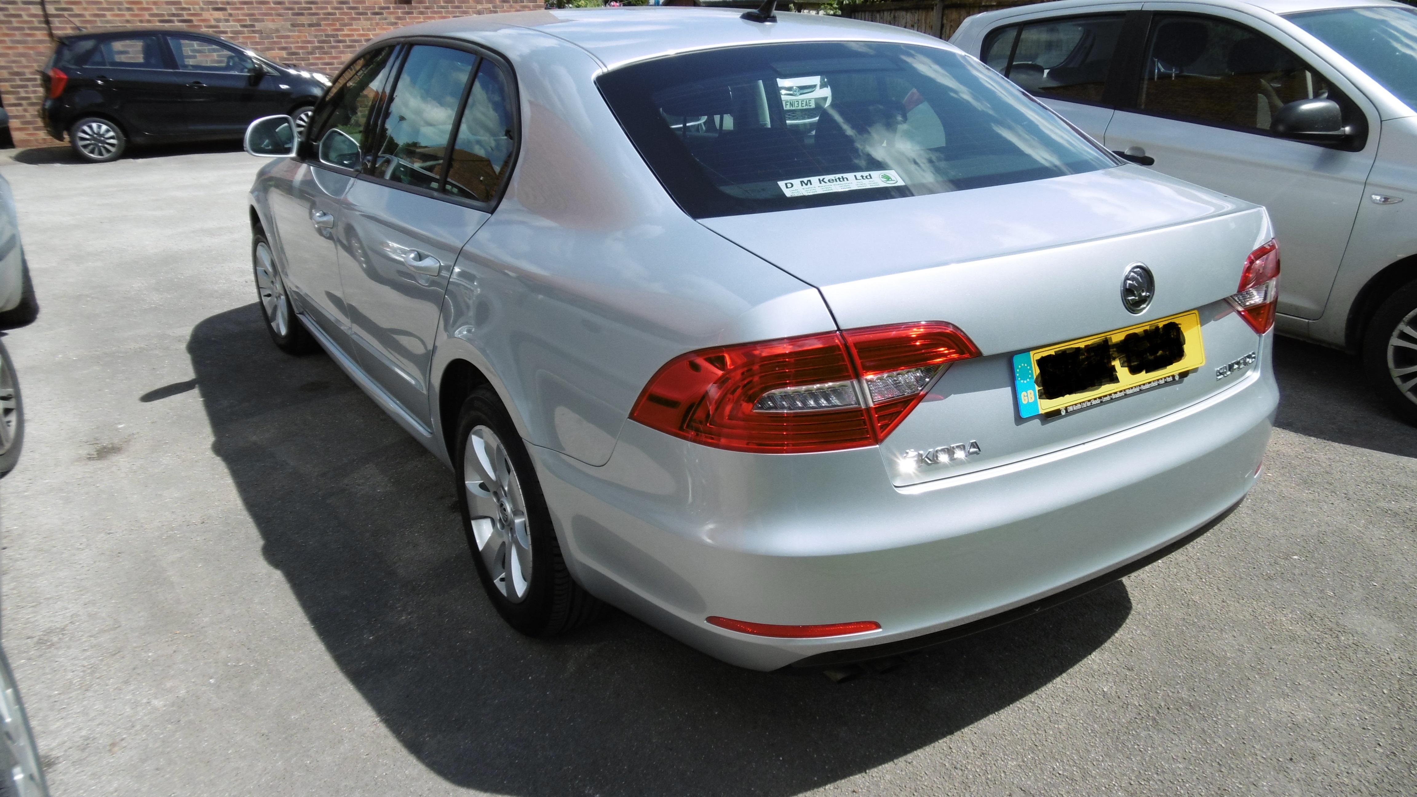

Spectrum alloys on Superb II:-
Edited by bigjohn

Thank you for the photos,They look ok. I have time to source alloys and tyres to suit. and run the 18"s in the meantime as they have almost new tyres fitted.

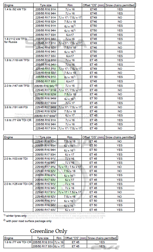

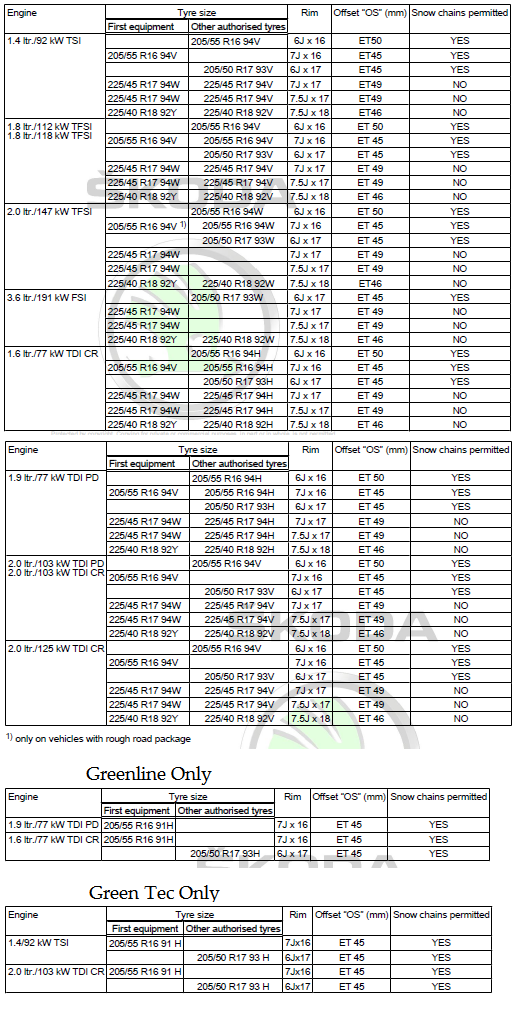

These are the approved tyre sizes taken from Skoda's service manual.
Pre Facelift (2008-2012 model years)
Facelift (2013-2014 model years)
Really useful - thankyou
