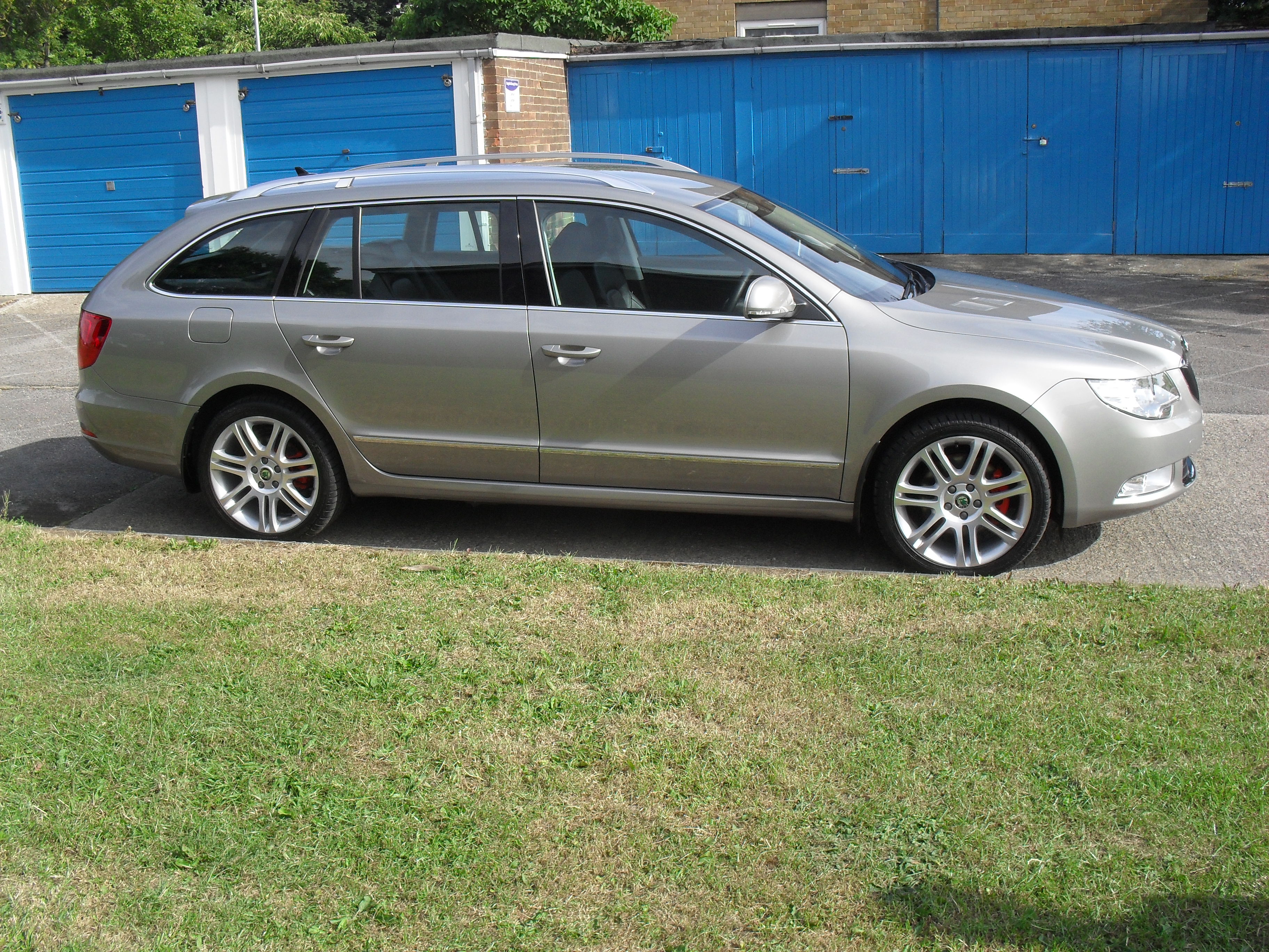

here is my 2013 superb it is one of the best vehicles i have ever owned, it is achieving 52.9 mpg at 66 mph on a journey with 4 occupants it is a 2.0ltr diesel. does anyone get this kind of mileage from there 2.0 ltr superb

Same colour as mine! It’s is indeed a lovely and underrated car. Was you car affected by the emissions scandal and if so, did you have it sorted?

Which wheels are those? I just have the poverty spec 16" Spectrum alloys
The Superb II is a great mile muncher - very smooth, refined and suprisingly economical (considering it drinks from the green pump) - touch wood no problems yet.
The only minor grumble on my part is I sometimes wish the seat base was a little larger for my big 6ft 4" frame - I never get back ache (which I did slightly in my Superb I) but after a long run without stopping it can slightly "dead leg" me. My fault for being "bigjohn"
I have those wheels on my Elegance - Themisto's. From my experience I would strongly encourage you to stay with the 16" wheels - much better ride that the 18's!
Just my opinion - you pays your money & you takes your choice tho'
Drefaldwyn
Hmm, yes the ride on mine is fab. Could also be due to the tiny/light engine. It's also very quiet since fitting Crossclimates

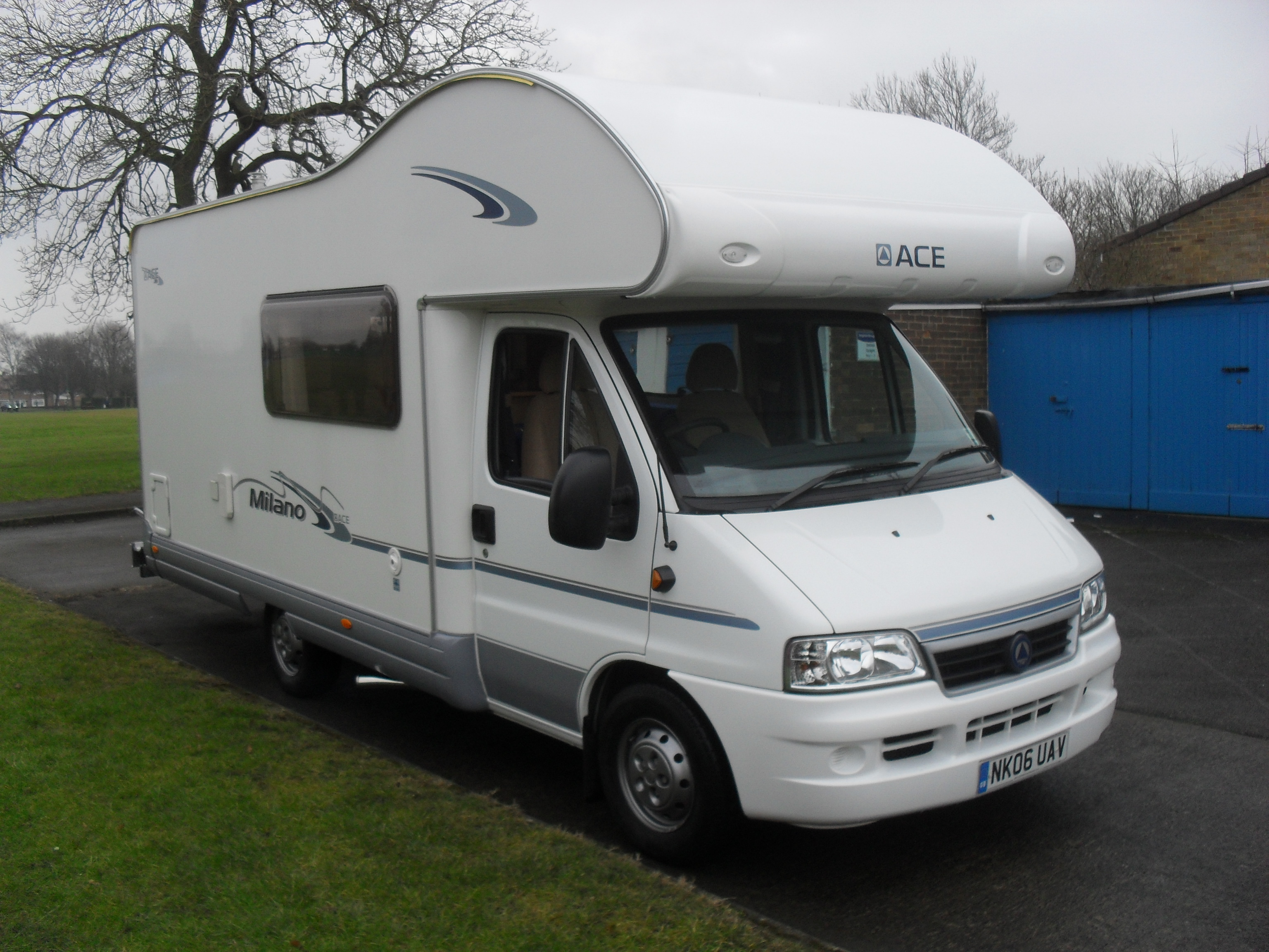

Hi Tan, it was supposed to be one of the affected ones, i did get a letter to have it done, it was done at Derrick slack skoda (Middlebrough), i have no after effects to date, but i did take it to an independent garage in Darlington who do all my MOT tests on my motorhome and car, they did an emissions test on for free and it was (clean as a whistle) the tester said, two days later i had to go to my inlaws in West Yorkshire as they are both in their eighties so i filled the car to the top with diesel, wrote down the miles and traveled down there and back the same day covering 154 miles, so i went back to the garage in my tow where  fueled up on the outward journey and filled it up again, i then did the mathes ie; divided the litres and the milage by 4.54 litres it equaled 52.9 mpg at 66 mph on cruise, i only do these speeds on the A1 as there are long roadworks on this road and it is very very busy.

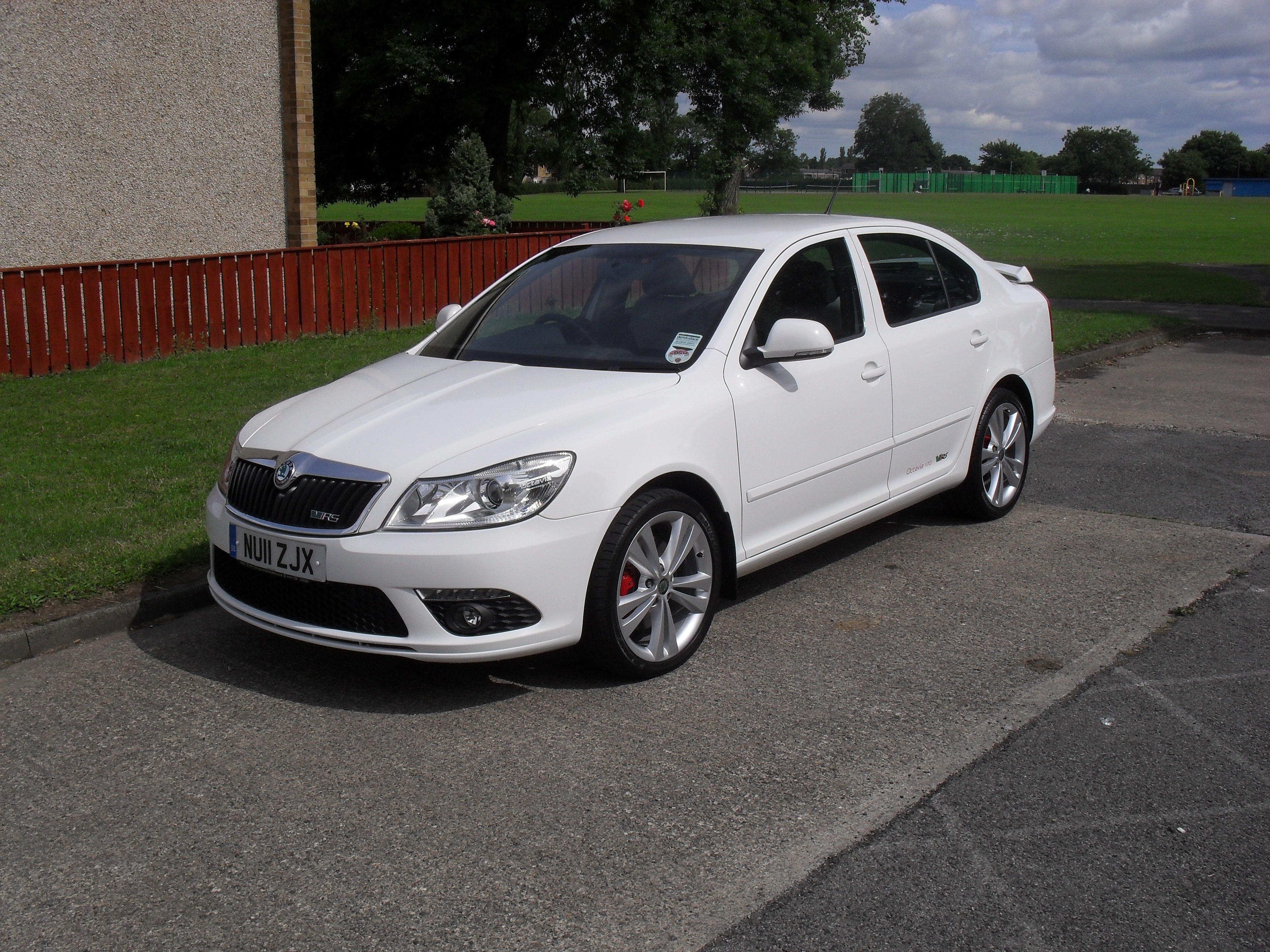

so i am very happy with the car, but i have noticed one thing that may be nothing! the car has a grunt acceleration, and the fuel economy is the same but it the power is much better. i have inserted my old car the Vrs which i also loved, but i sold it to by the Superb as i was then buying a caravan, but two weeks later i sold the caravan as i stood to make £1,950, on it, so i bought a younger motorhome which is also pristine, the pictures of it are two weeks ago, but i have had it now for three and a half years. catch you later Tan62

the vrs comes with 18" alloys when new, i painted the calipers with hammerite smooth red and i also painted the bearing hubs too, this does actually helps to keep the alloys clean i have done this on most of my cars, and it look very good and sporty, the paint is ok and it the heat does not affect them.
