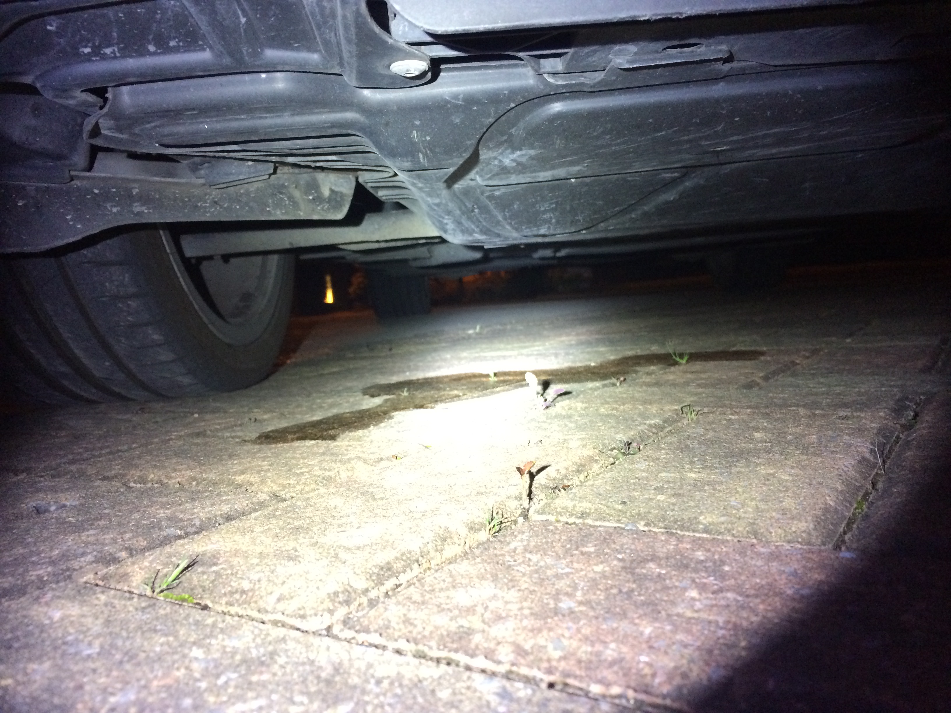

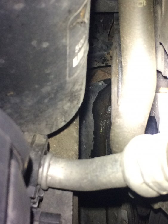

The attached photo is seen left of the engine, as you stand in front of the car. The other one is under the car, not as much water as I'd have thought.
(car not under warranty)
Could the water under the car be the aircon doing its job?
On turning the key, it beeps red warning message Check coolant! Read manual! I am pretty sure the coolant should not be this much below the minimal mark. So I don't think that's condensation on AC.

Are you 100% certain the water on the floor is not AirCon condensation? This was my first thought as I'm sure I've seen the same under mine and my coolant level has never needed topping up.

Just checked again, no water in the expansion tank, a small puddle under the car. The underside tray I photographed above is even more wet. There is definitely a leak developed yesterday.

Took it to a very local garage after topping up. They took the undertray off and found coolant  to be *freely running* not dripping from the timing belt area when the expansion tank cap is taken off. It appears to come from behind the aux-belt, where timing belt should be.
So hopefully only need a new timing belt + water pump.

The only seal in there is the water pump seal. Fairly common fault.
The water pumps sits right next to the timing-belt. Ensure that they change the timing belt as it may have been spoiled by slippery coolant.

If you remove the plastic under-engine-tray you may well see where the leak is coming from. Failed water-pump seals tend to leak slowly (drip, drip), so you may be lucky and just have a loose or split hose. It could even be a radiator leak which a bottle of Radweld can patch-up.  RAC man should have been able to identify exactly where the leak was coming from. When my water-pump failed Skoda Assist sent a Greenflag breakdown man who said that looked like water was leaking from the water-pump.
