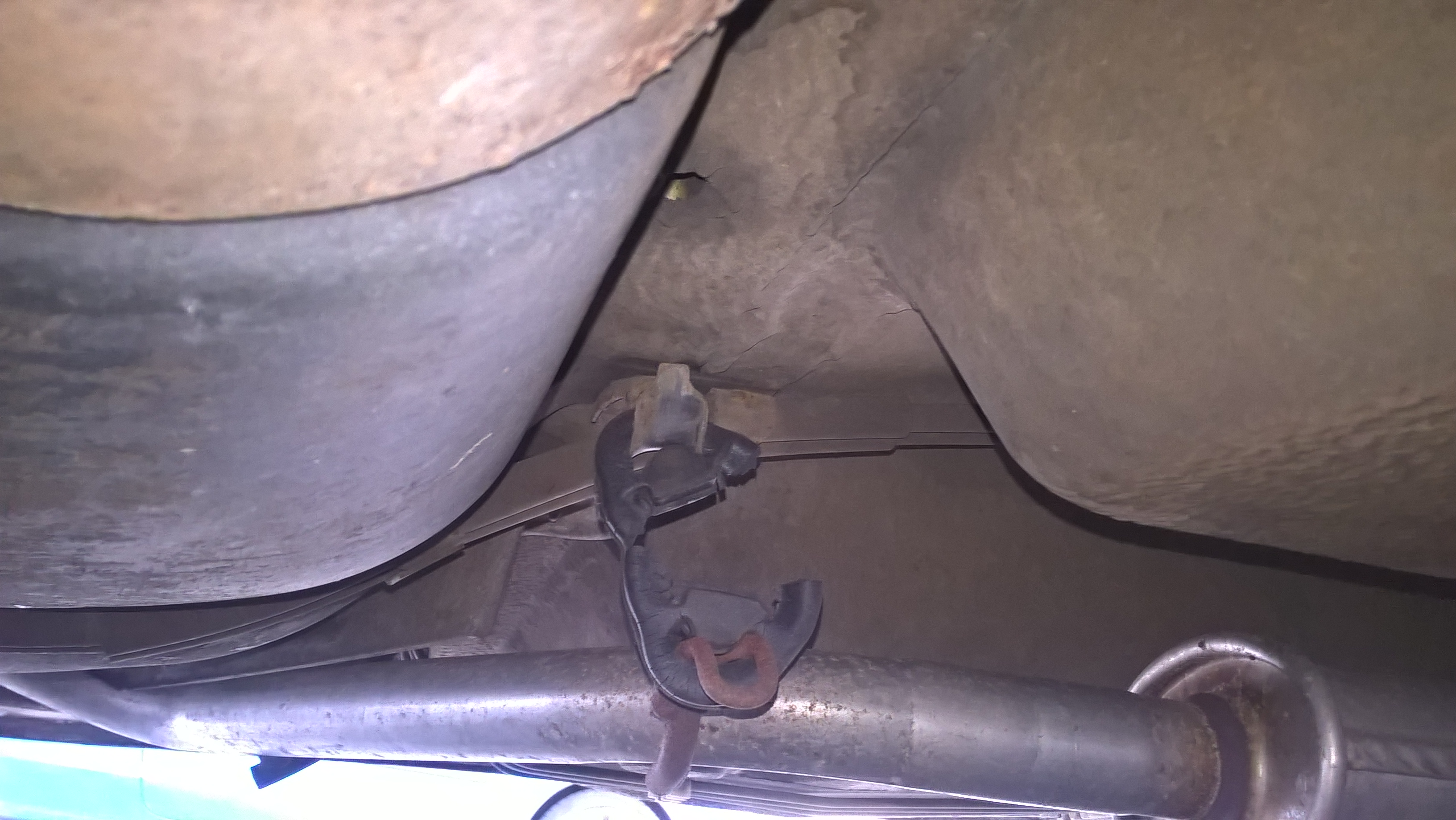

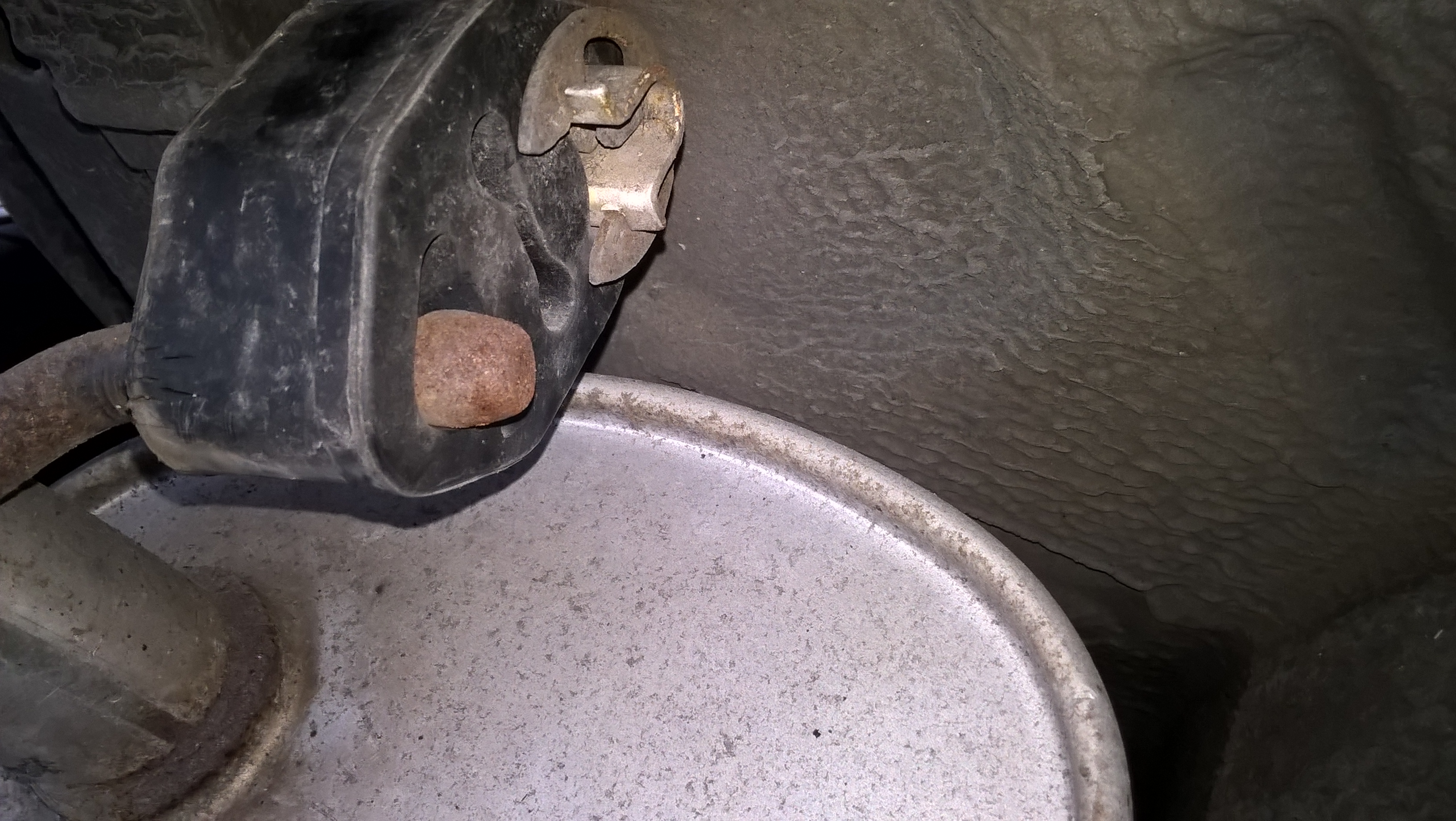

In case you have not checked your exhaust rubbers! My Felicia has done 73000 miles (17 years old). I had a rare occasion where 3 passengers were present in my car, so the rear was obviously much lower than when its just me. I heard a terrible scraping vibrating noise, upon inspection you can see the exhaust rubber to the front of the rear silencer is hanging by a thread! Resulting in vibrations on the exhaust and rear axle :o

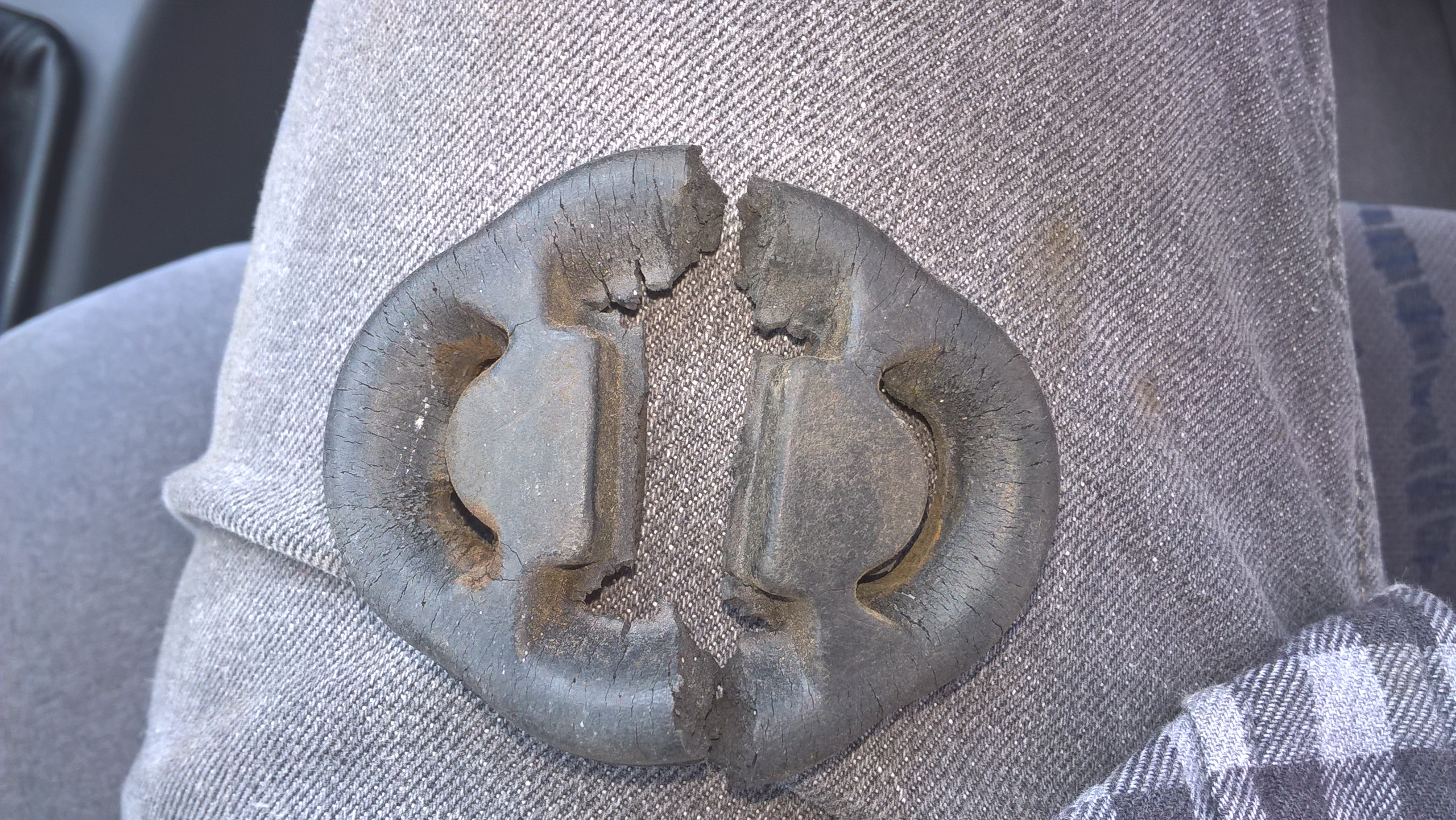

all three rubbers are hard and perished, so if you want to replace yours do all three. The two at the front of the rear silencer are slightly different to the one at the rear.
its necessary to slightly bend the retaining clips to remove them with a screwdriver (be careful not to snap it). I simply bent them back with pliers to ensure a tight refitting. In the picture you can see the old rubbers, the rear one is cracking with age so I replaced as a precaution! So if you have not checked under your car for a while, have a quick look, seeing as all fellys are old now B)
Hopefully these pictures are useful for reference.
