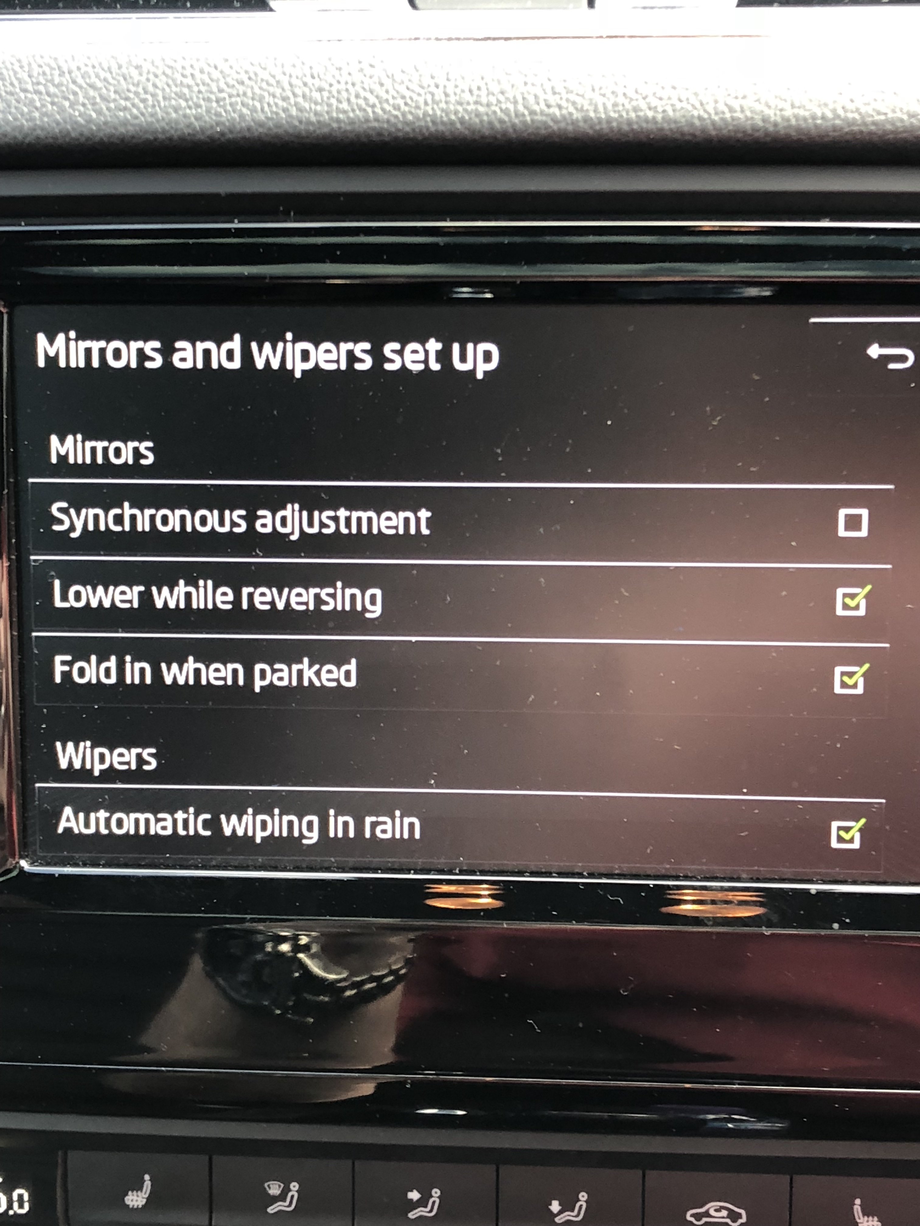

Can folding mirrors be deactivated Via the Car Settings on the Radio, untick a box,
Not on a MK2 Octavia as there are no 'car settings' in the infotainment system ;)
You can on a MKIII,  " Simply Clever "    :dance:

Auric's  Mk111 post showing how  to bypass folding when parked up just makes me realise how old the technology of my FL Mk11 is. I suppose on a Mk11 this can be done by maxi-dot, an option I don't have.

it doesn't as the parked option is for folding when locking the car (both mirrors)
as you only want one to fold vcds is your only easy option
