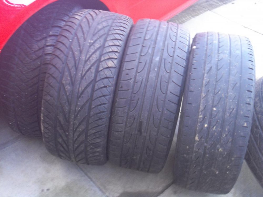

These are Goodride 205/45 R17 on Gigaro rims,
 no bigger than Pirelli Zero Nero 205/40 R17's on the same rims.
What 205/40 R 17 tyres have you fitted now.
From Left,
On car Maxxis Ap2 205/40,  Goodride SV 215/40, Pirelli Zero Nero 205/40  Dunlop Sport Maxx 215/40
Edited by Headinawayoffski
