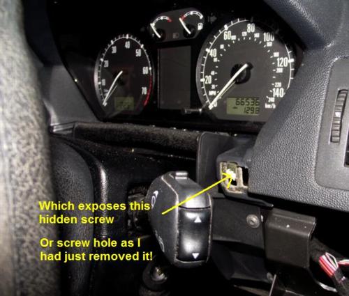

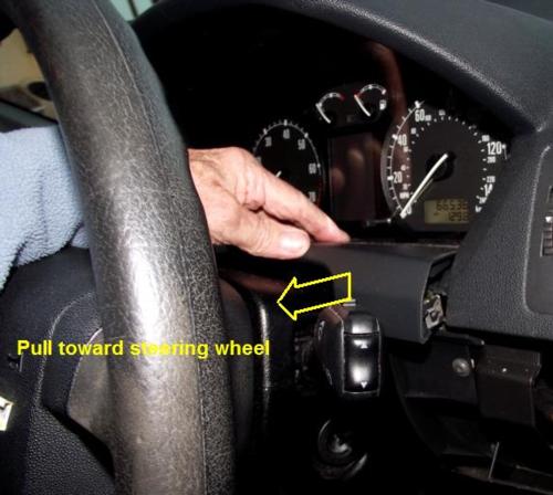

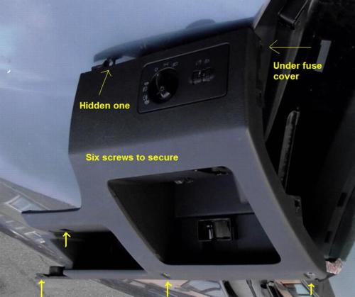

Least simple bit was wrestling the lower dash panel off. Did have a look in Haynes and on here for clues to the mystery screw but no go. So heres a couple of pics.
First lever toward the steering wheel the little panel that forms a shelf between the instruments and the steering column. Its held by a spring clip each side and must move toward the steering wheel, not upwards.
This reveals the mystery screw. There is another slightly hidden behind the fuse cover which is easy and four more along the lower regions. Total 6. The panel then slides toward the seat with some wiggling.
You will need to detach the plugs to the lighting switch and release the OBD" port. Refitting is the reverse of removal. Roughly offer up the panel at the top. Connect plugs. Then tunnel underneath to find the large spring clip
