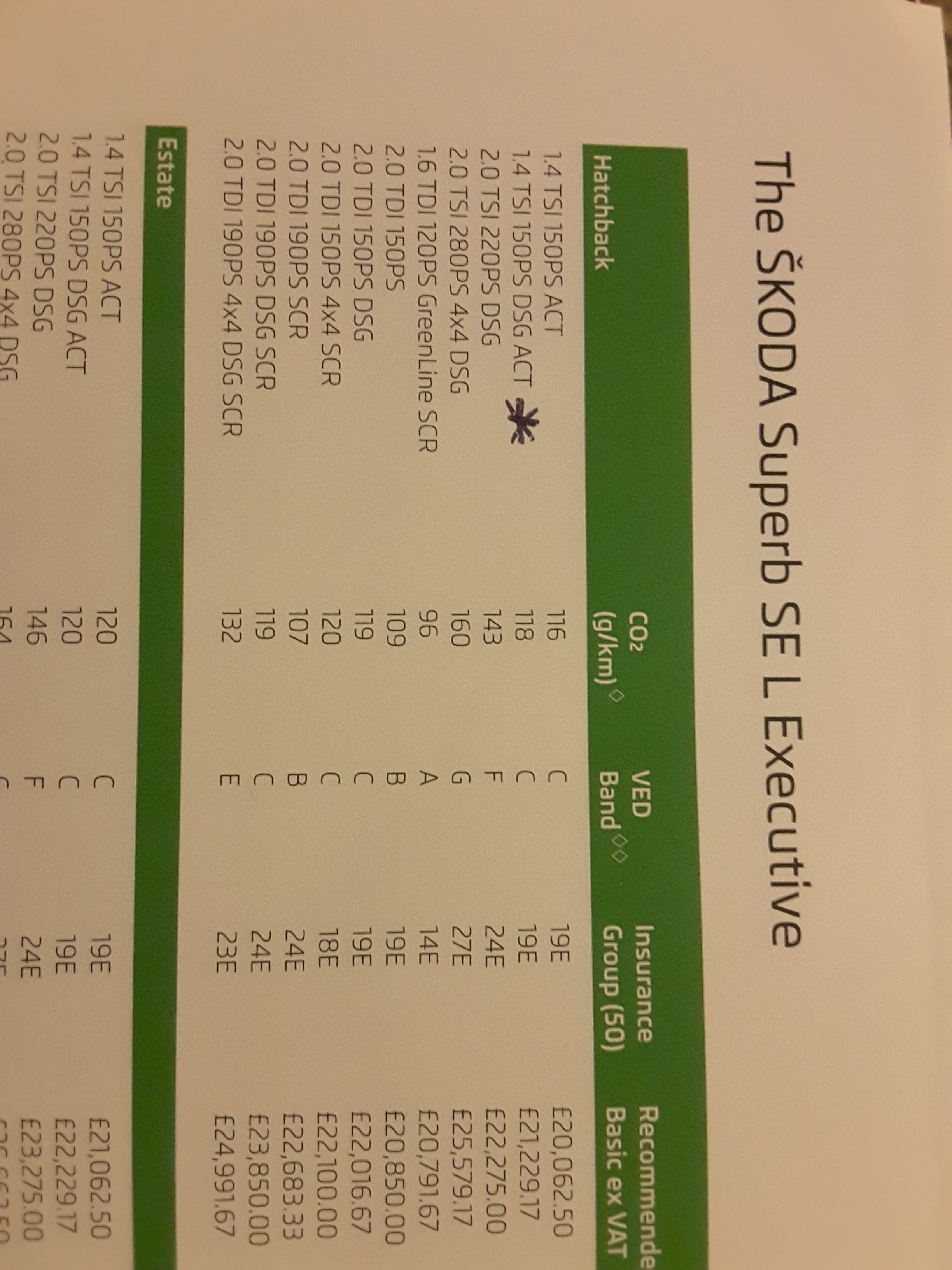

I am sure the 1.4 is ACT as I looked it up in the brochure when I was deciding.
Try looking at the top of the 1.4 engine in an Octavia (easy enough as Skoda don't fit a cover like VW or Audi do) - you won't see the solenoids that deactivate 2 of the cylinders, they're definitely not there on my 2015 1.4TSI.
I haven't got the car yet, two weeks away but here is the brochure picture.
That’s a Superb brochure though...

The 1.4tsi engines fitted to the Octavia mk3 have never had ACT functionality, however the ACT versions are fitted to the Superb mk3.
