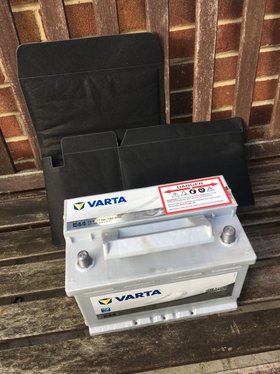

It's getting towards that time of year when batteries start to fail again.
Mine has been playing up for a while, beeping on start and displaying an ESP error typical of a battery issue once or twice a week.
So I decided to bite the bullet and swap it before it failed on me.
This is where I found the car was fitted with an 027 type battery rather than the 096 that most sales sites suggested it should have.
My car is a fl 2010 vRS CR170 TDI estate for info.
So I'm posting this information to help others, as it took me a few Google hours to work it all out.
Details:

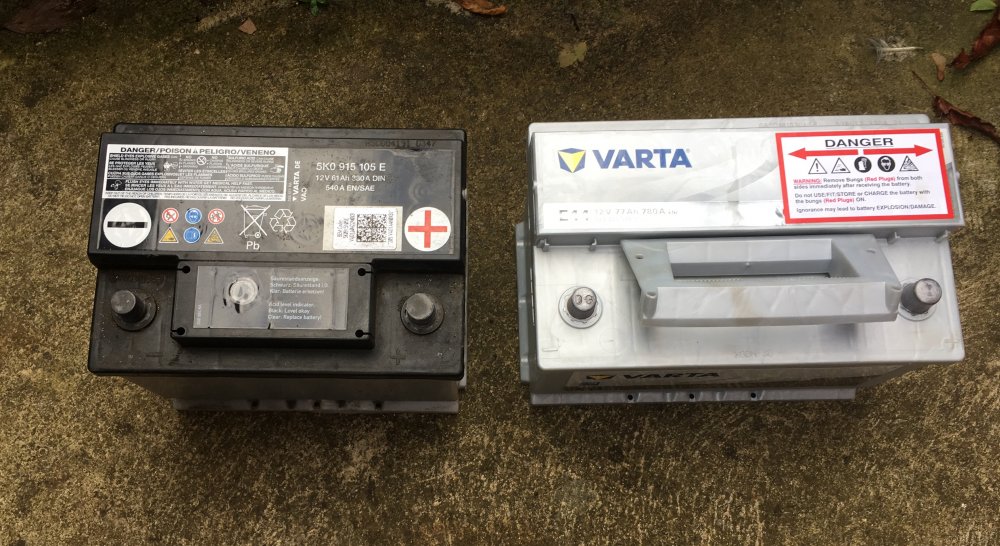

027 type battery dimensions
L = 240mm
W = 170mm
H = 190mm
61Ah and CCA 540A
096 type battery dimensions
(I fitted an E44 varta item, other brands and details are available, I wanted the biggest it would take)
L = 278mm
W = 170mm
H = 190mm
77Ah and CCA 770A
The 096 does fit straight into the battery tray of the FL VRS, please check your own car to ensure fit.

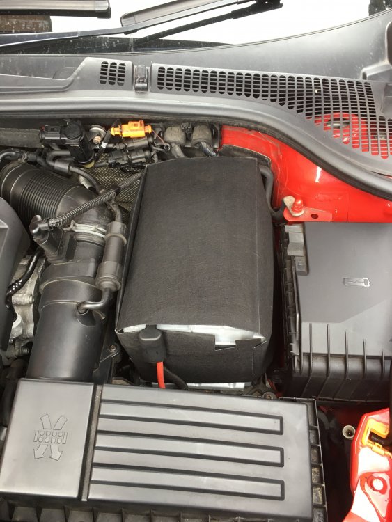

The main issue for me was that my existing battery jacket won't fit as it's designed for the smaller battery.
027 type jacket part number:
1K0915411A
096 type jacket part number:
1K0915411B
Hope this helps a few out.
As with all guide type posts, it's done at your own risk, OP accepts no responsibility etc etc etc.
Thanks

Just successfully fitted a 096 battery on my 60 reg 1.6TDI DSG and wondering where you can source the battery jacket mentioned in the OP? I haven't had much luck googling around and was wondering if anyone has a good source?
I sourced the bigger jacket off eBay (new) with part number 1K0915411B
You should be able to get one from a dealers with that part number though.

I've just swapped my 027 battery for a 096 too.
Fitted perfectly however like the op, the original 027 battery jacket did not fit.
I'm undecided whether to order a 096 battery jacket, order the above battery box or leave as is.
I think the battery box looks better then the jacket in the engine bay
