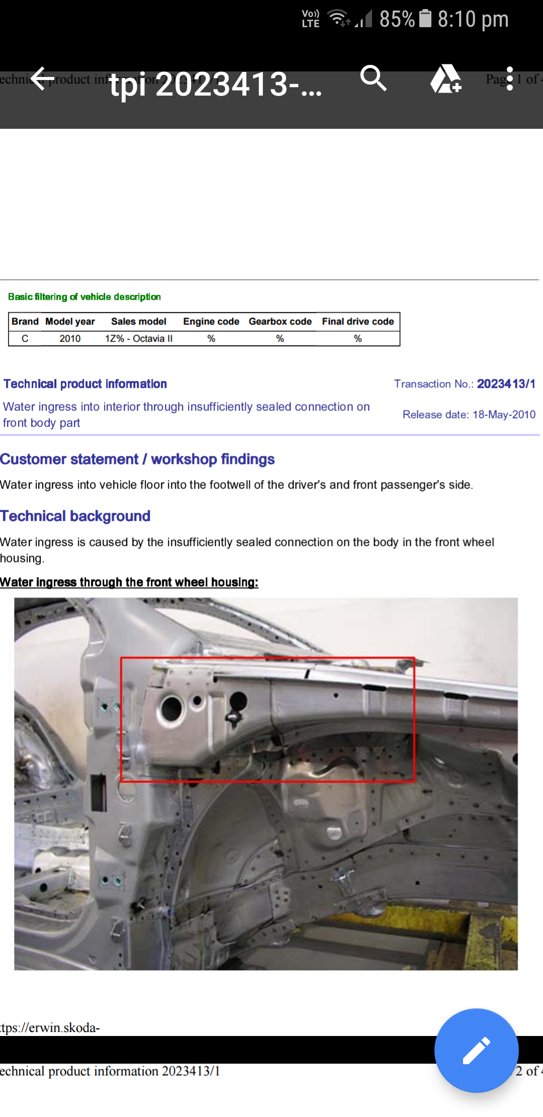

Hi there does anyone no if this is manufacturing fault.
If it is and it's what's up with my car Skoda said they would fix for free.

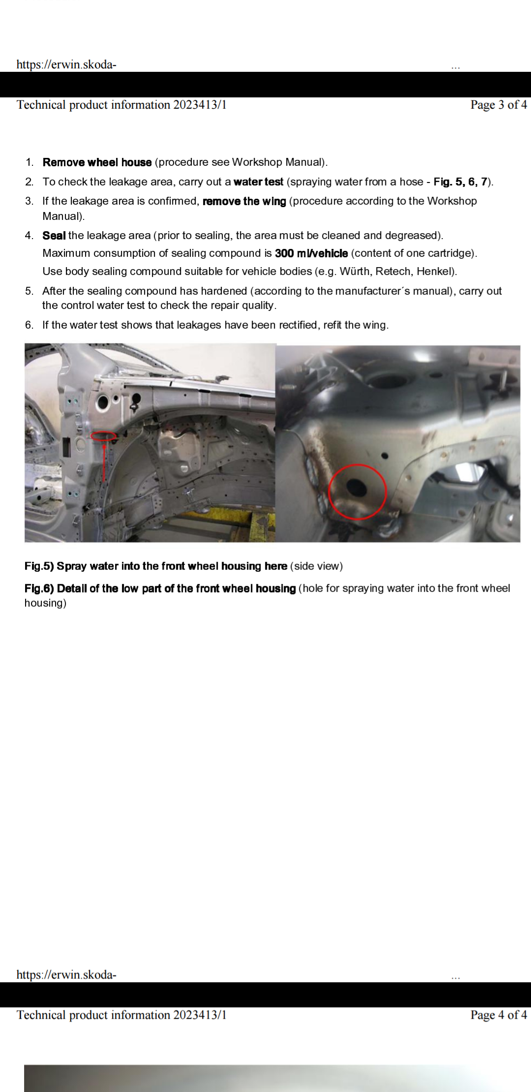

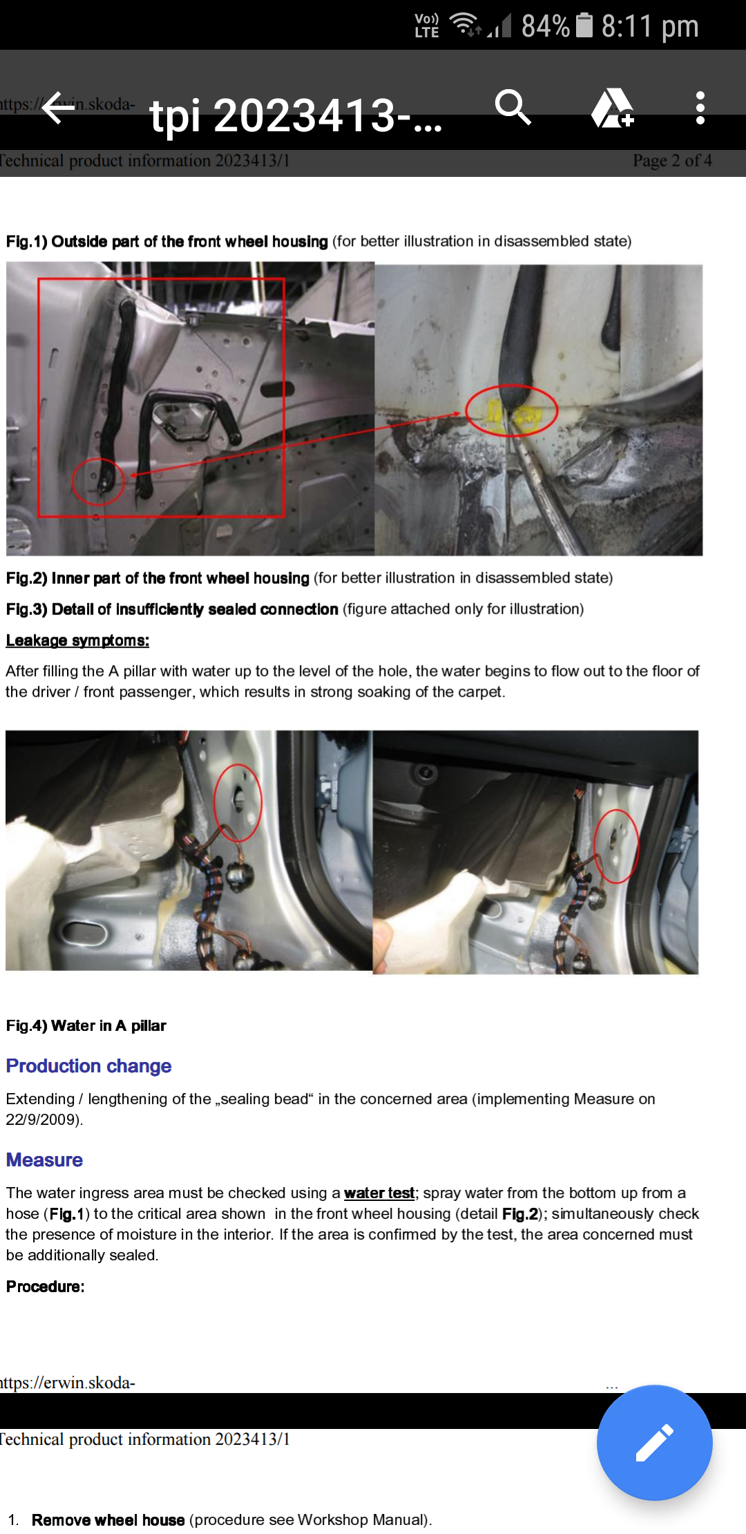

I would say so, seeing as Skoda are issuing a Technical Bulletin to its agents. (It was always the case when we received similiar instructions from Ford when i was in the trade). Indeed the article admits to "insufficiently sealed connection".
