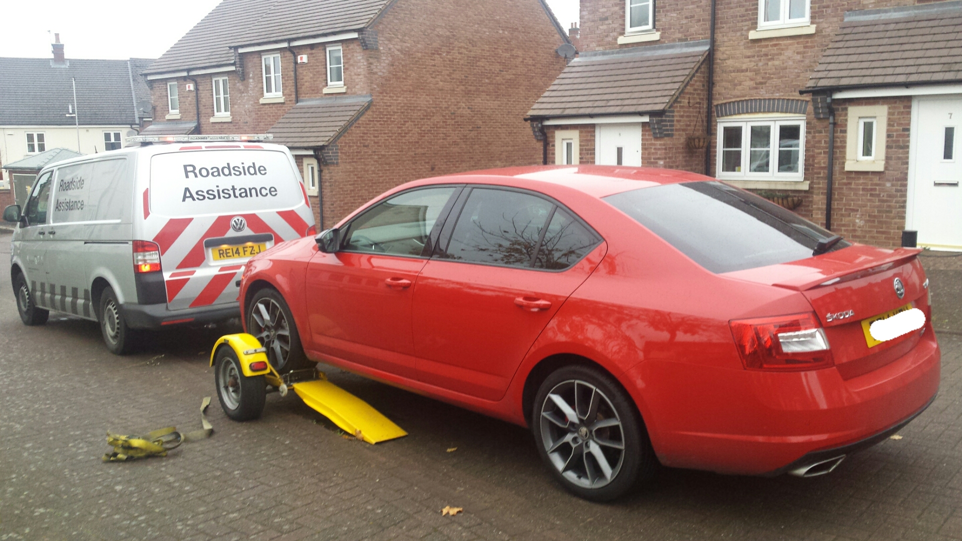

Well I've only had my 14 plate TDI vrs 5 weeks, had the waterpump replaced less than 2 weeks ago and its overheated again !
Called Skoda assist and they sent the AA out and the guy thinks it could be a thermostat problem.... the new waterpump could be defective, although unlikely as it overheats slightly different....it now goes all the way into the red and you have to stop, when before it sometimes it wouldn't reach the red, but would always come back to 90c, but now it goes all the way into the red and alarm goes off !
I have to say, im pretty impressed with Skoda assist and this is going to cost Skoda a bit of cash as they have to recover my car from my home and transport it to Skoda Coventry, its not that far about 10 miles and i have a third party hire company supplying a hire car tomorrow morning at 8am so i can get to work...hopefully all goes to plan and its a easy fix on my vrs and its all covered by there warranty !
