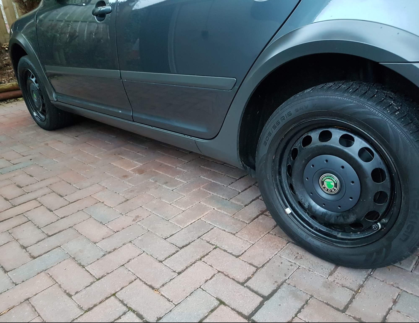

I found in the 2-3 years of using 17" cold weather tyres on the original alloy, the wheel arches jammed with compacted snow.
Since swapping to the smaller and narrower 16" steel wheel and cold weather tyre combo 4 or 5 years ago, I haven't suffered that problem.
And yet the rolling circumference of the 2 is almost the same...............................................

Maybe it's down to the narrow wheel/tyre, the snow is different, or any combination of a 1001 other things, whatever the reason,  that is what my personal experience has been.

I fitted a set of these (via eBay) on my 'steelies'. They have lasted longer (4 years)  than I gave them credit for!
Personally, I wouldn't be that fussed about the VW logo. I only fitted mine as the wheel and hub were both black and I just wanted to break that up.
