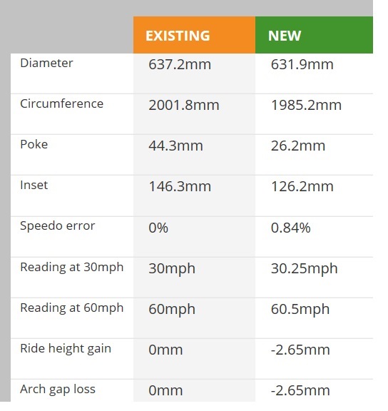

I assume poke is how far it sits out in the arch? and I assume inset is something associated to this ?
Edited by Gissin

To avoid putting the Speedo out on vrs, 16's should run 205/55/16
Looking at Gissin's post from Will They Fit, it looks like that's the tyre size he's put into the calculator.  I went with the OEM tyre size for my winters as it saved a lot of hassle with my insurance company at the time.  They weren't bothered about the fact I had winter tyres on, merely that they were the same dimensions.  225 45 17" for both sets and they were happy.
