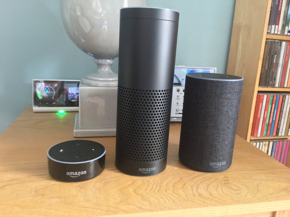

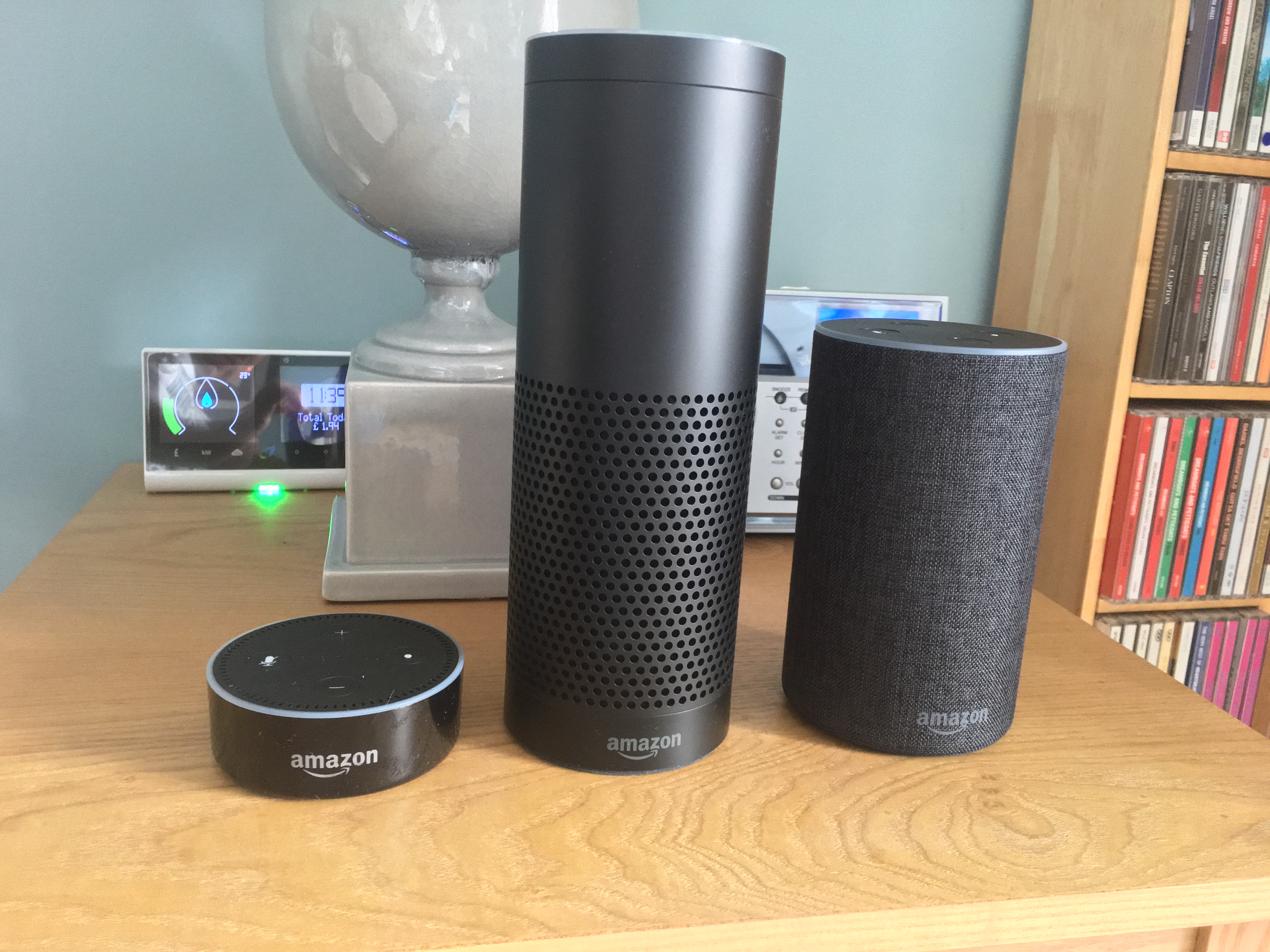

I had an Amazon Echo Dot in my home office, which was replaced today with one of the new smaller full Echo units that just started shipping. In the picture below you can see the Dot alongside the full-size mk1 Echo we have in the living room and the new smaller mk2 Echo that is replacing the Dot in my home office.

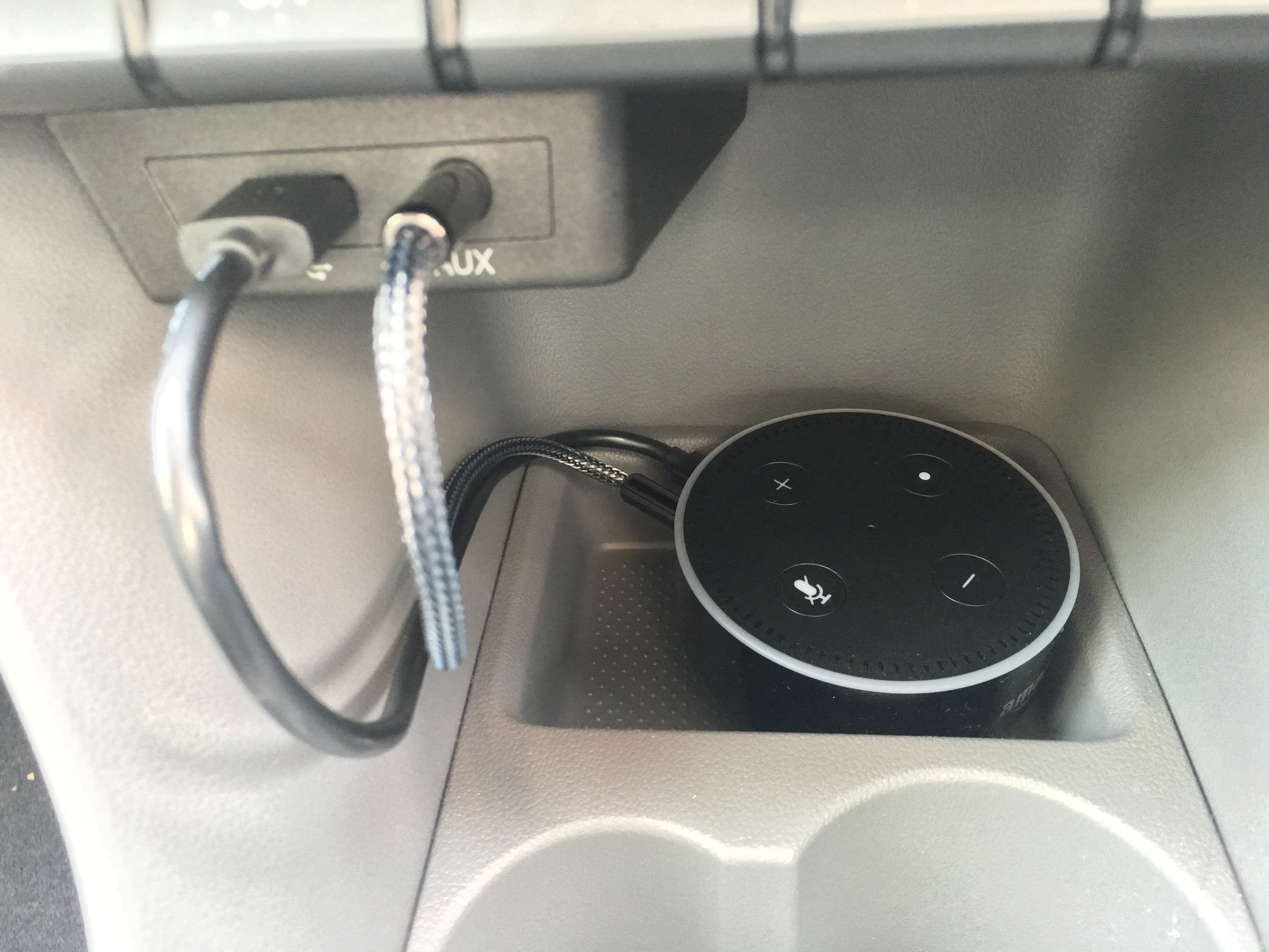

Firstly, the MDI interface USB port is capable of powering the Dot. This is good as many owners here will know that the MDI interface on the Mk1 Rapid and Spaceback is a temperamental pain in the arse when used with phones. Using it as a power source for the Dot is hopefully going to be a better use for it. The 3.5mm input connects to the same on the Dot for audio, keeping the Bluetooth interface free for my iPhone to connect on both the A2DP and handsfree profiles.

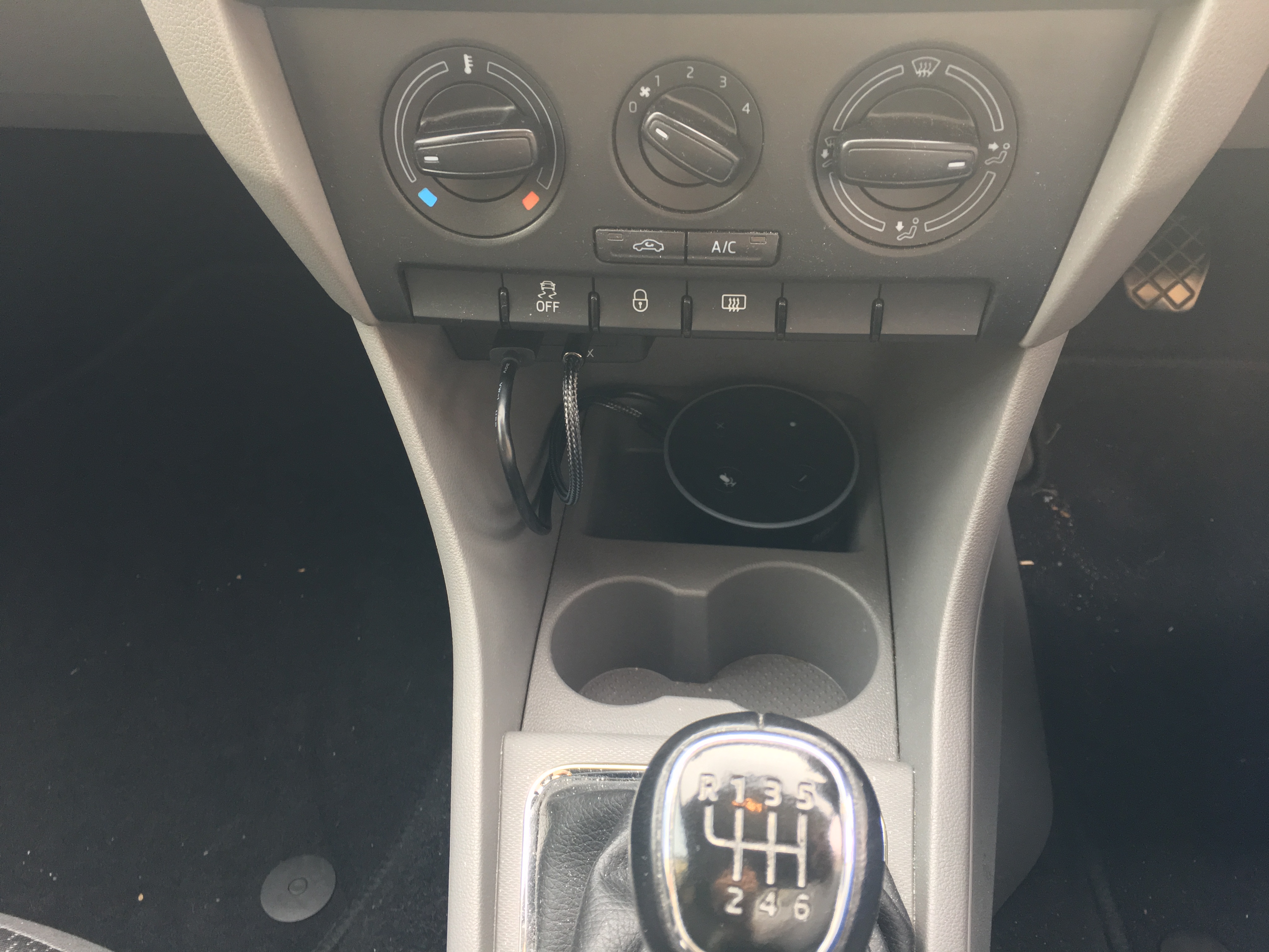

After some experimenting I worked out that you need 25cm USB and 3.5mm cables to get the optimum balance of connectivity and no excess trailing wires. Also, the Dot is slightly too big to sit flat in the coin tray below the AC controls, so you will need to put some kind of spacer under it. I’ve stuck an 8mm thick, 5cm diameter MDF disc to the bottom of the Dot, with a couple of sticky pads holding it all in place in the coin tray. The fit is now perfect.
The end result looks like this:

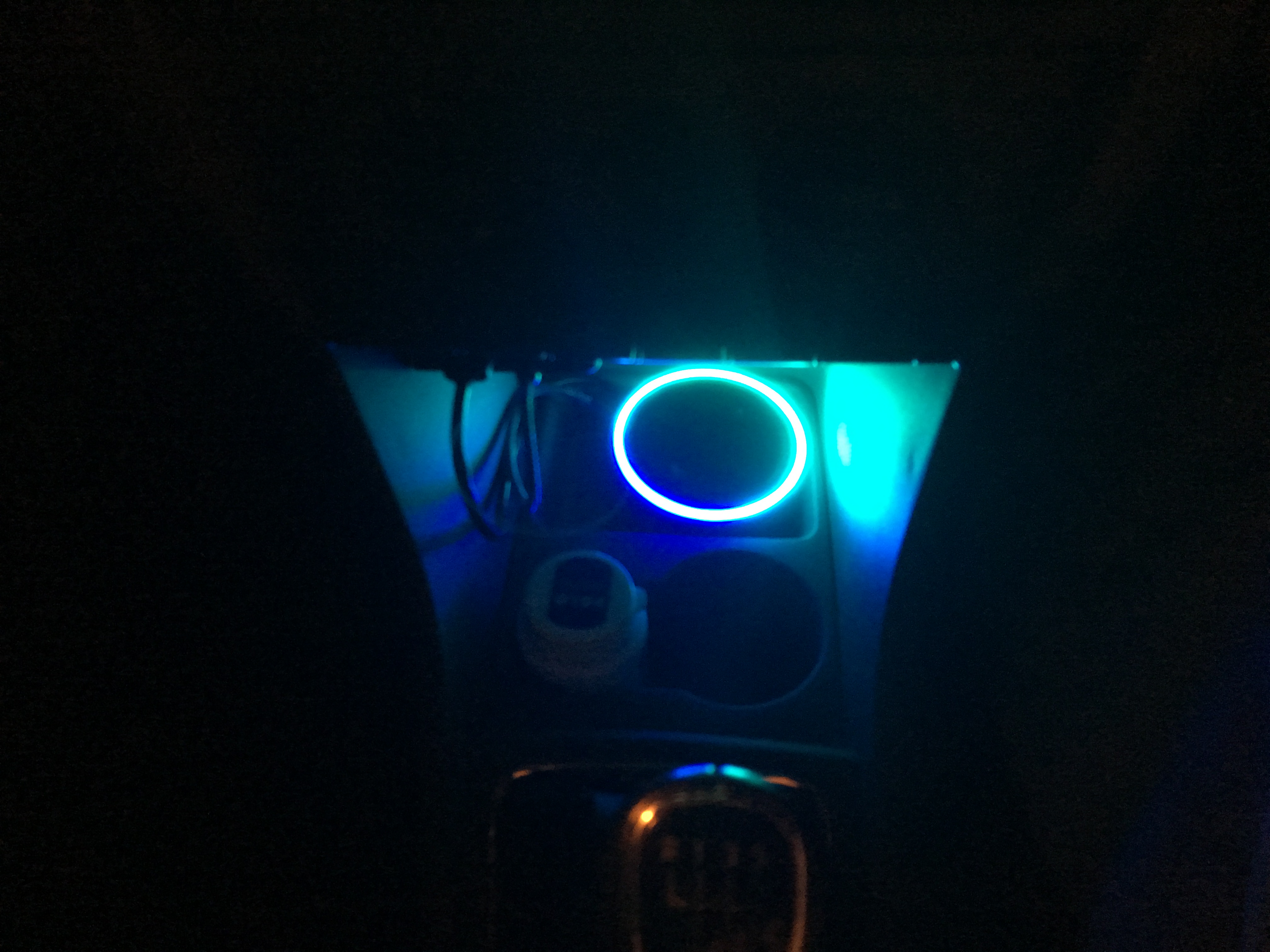

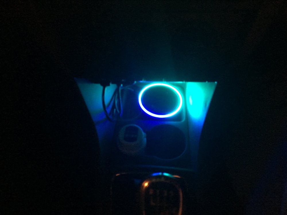

Here’s a pic of the Dot up and running, streaming music as I drove to Waitrose earlier this evening:
