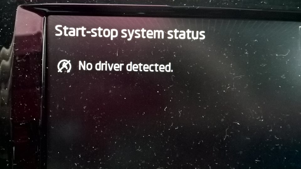

when i clicked on the information the screen told me there was no driver detected does anyone know why it would show this if i was in the car
