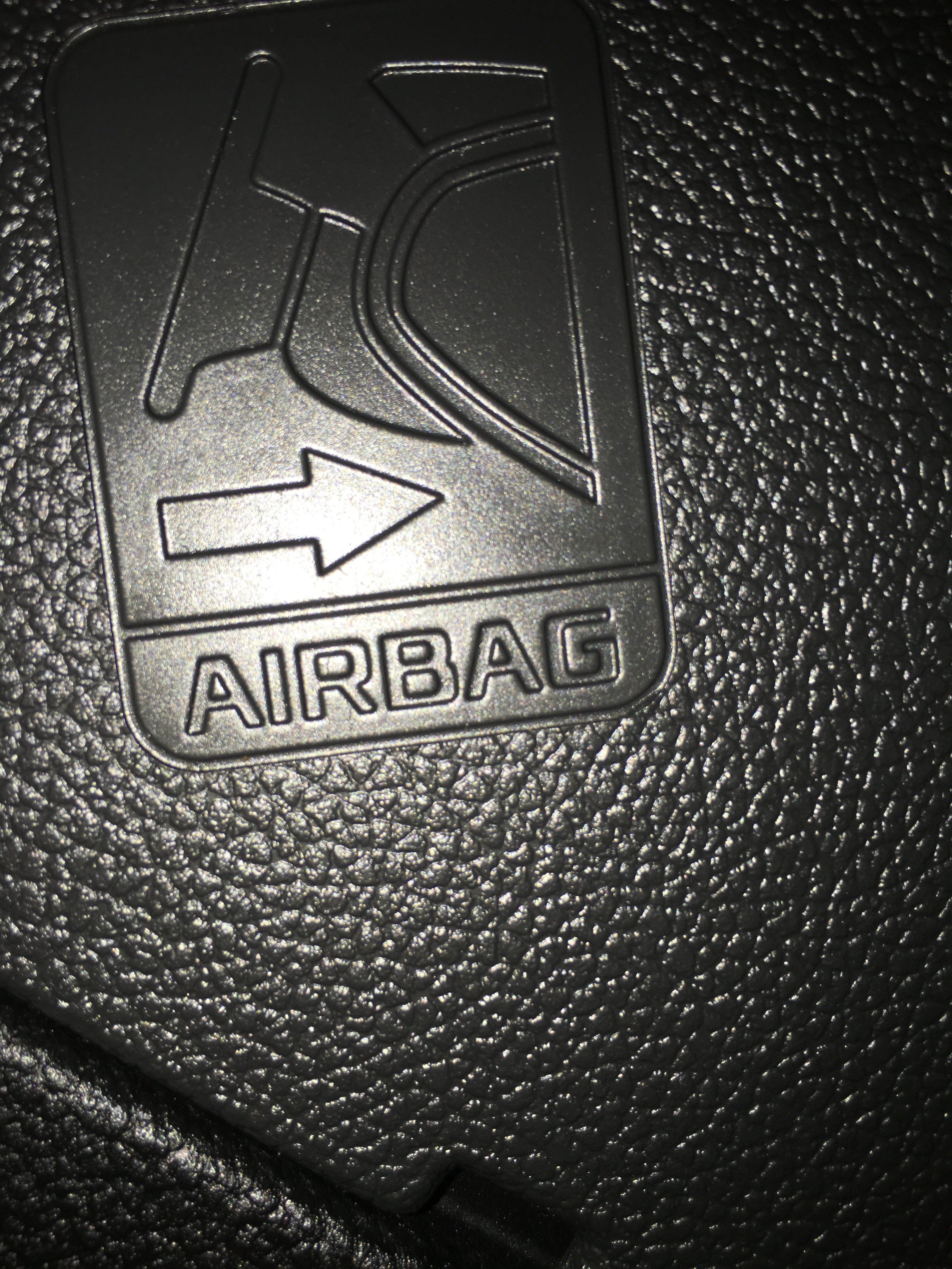

I have  opened the panel on the left of the dash  but I don’t see any fuse panel.  I was thinking of opening the right side panel next to the steering wheel but there was a Airbag symbol on the panel cover and I wouldn’t want to mess with that.

I don't know why there would be an airbag symbol on the panel as there should not be any airbags there.
Thank you Roo for your reply.
Concerning the airbag,  please see the picture I took of the panel.
Does anyone know why the airbag warning is there?CE76747D-79F4-4DD1-BF26-97E2DB565AAF.thumb.jpeg.1302f4d206d649802d003d77391c1e70.jpeg
Does it have a knee airbag at all?  it could be that as it's pointing that way rather than saying that the airbag is there.   If there was an airbag there it would just say airbag on it with no picture or arrow.

It is indeed a warning for the knee airbag, but unless your changing fuses with a hammer it's location isn't going to impede access.
