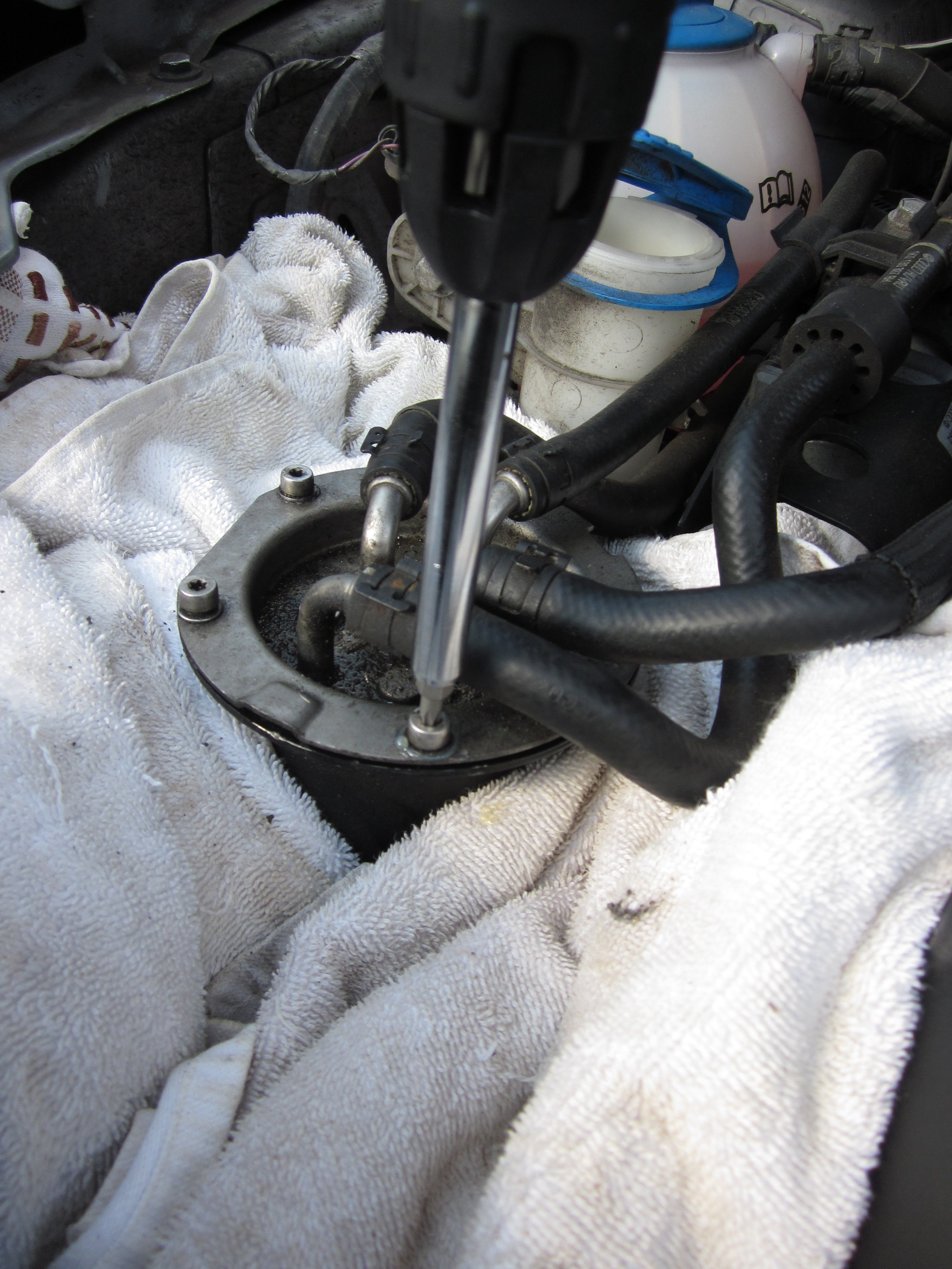

If the diesel filter housing is leaking, I would have thought it would run down the vertical sides of the housing, (and smell a lot) rather than filling the lid. The pipes on the top don't need to come off to change the filter (for me, anyway).
If it is leaking diesel, it can flick on to the auxiliary belt, which can rot and eventually fail, winding itself around the crankshaft pulley, which can cause the cam belt to fail.
So, might be worth keeping an eye on.

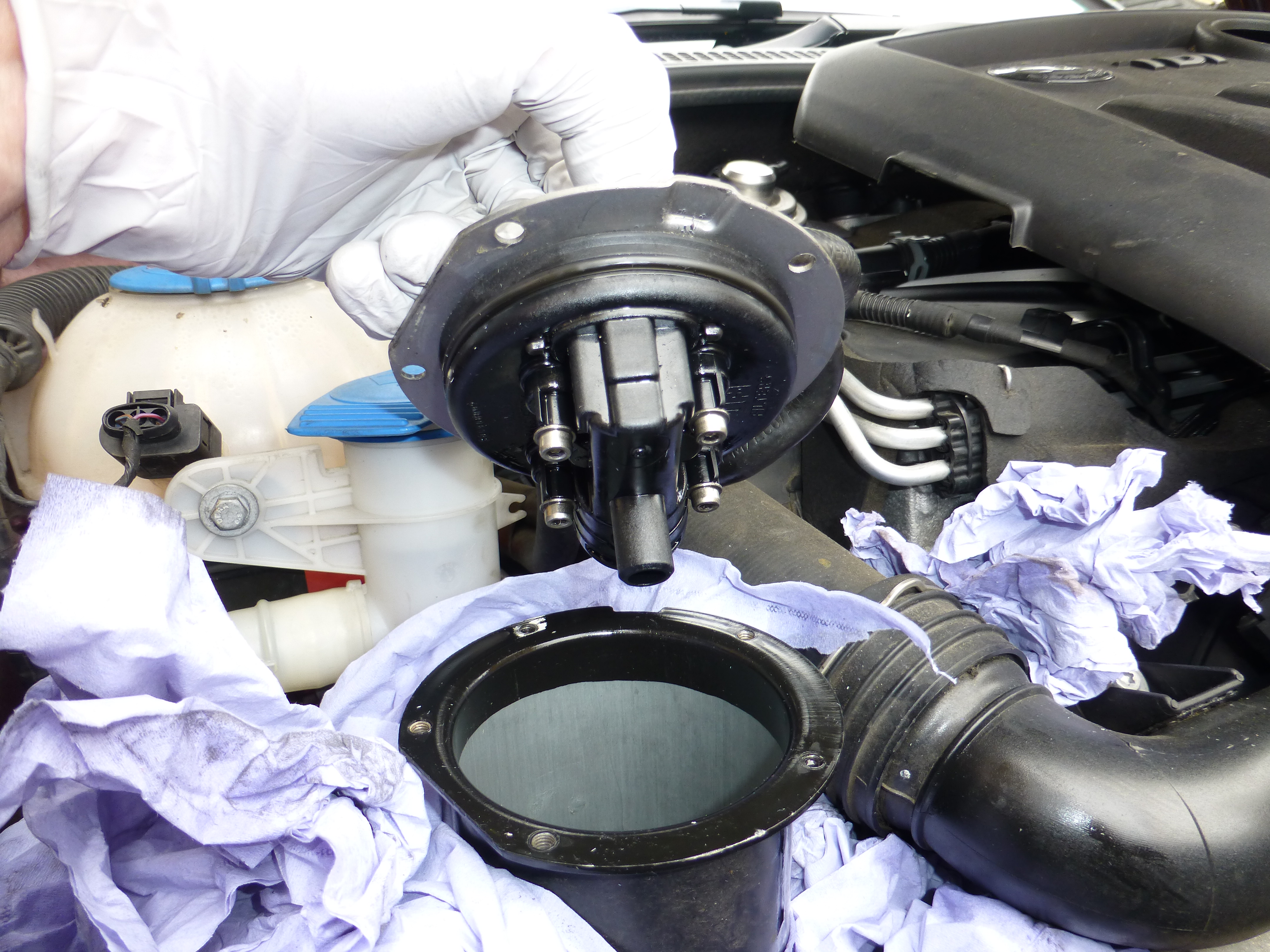

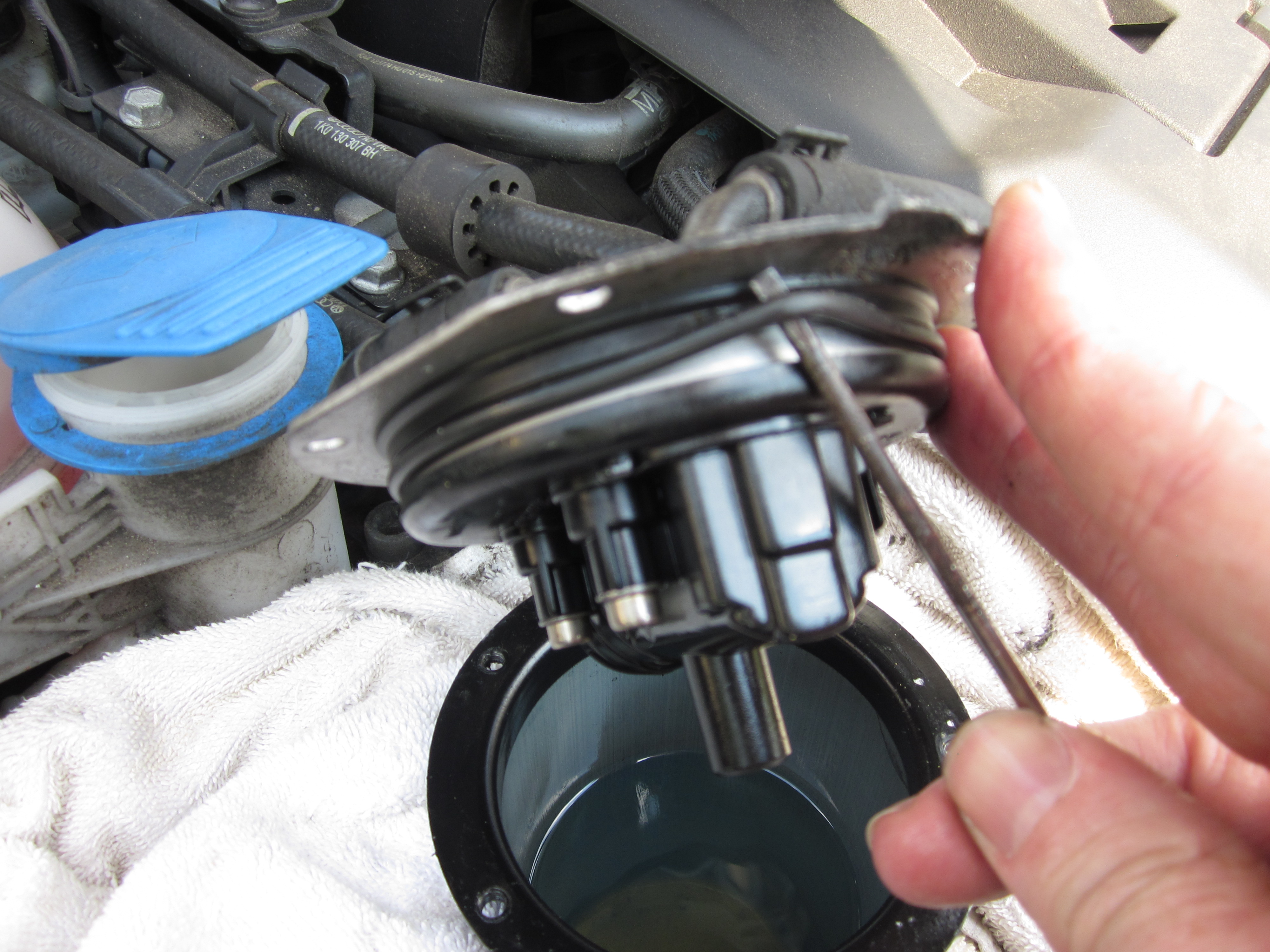

The large o-ring/seal is pushed down into the black-bowl-part, it sits in a rebate in the lid, I'd imagine it can twist whilst its being re-assembled, as it is a snug fit.
Hopefully this explains it a bit more.
The new filter hasn't been put in yet, in this picture.
