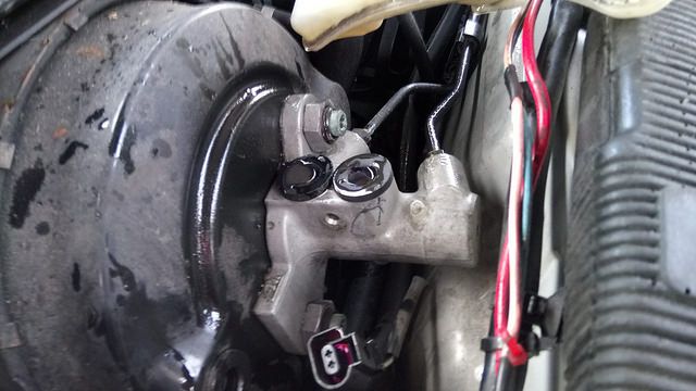

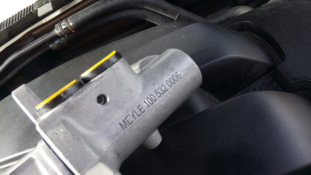

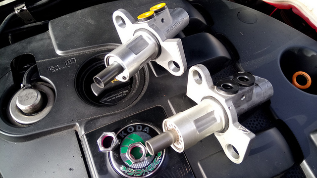

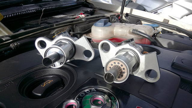

Have got round to starting to change the master cylinder. I knew there was two different types, and I knew I would end up with the wrong one. Yep its wrong........
And why did VAG make the dam thing nearly accessible, but actually not. Tossa's.
I've actually got it out. Getting the new one back in, when it comes, may be a different thing.
Great shots, there are tumbleweeds blowing through here lately, what was wrong/symptoms with the old one?
Soft pedal syndrome. Likely to be the seals gone.

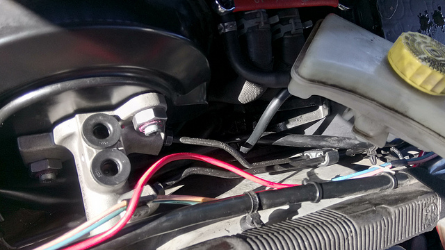

Well I got the new one in..... some how. Bumin tight.

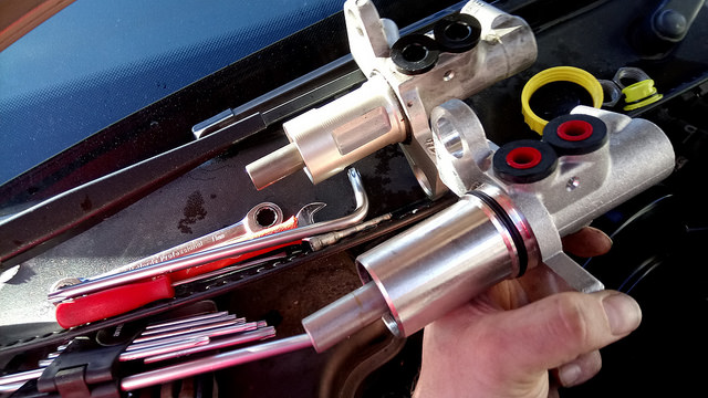

You'll notice the original one (on the right), has a circlip on it with out holes, to prevent you doing the cheap option of just changing the seals.
