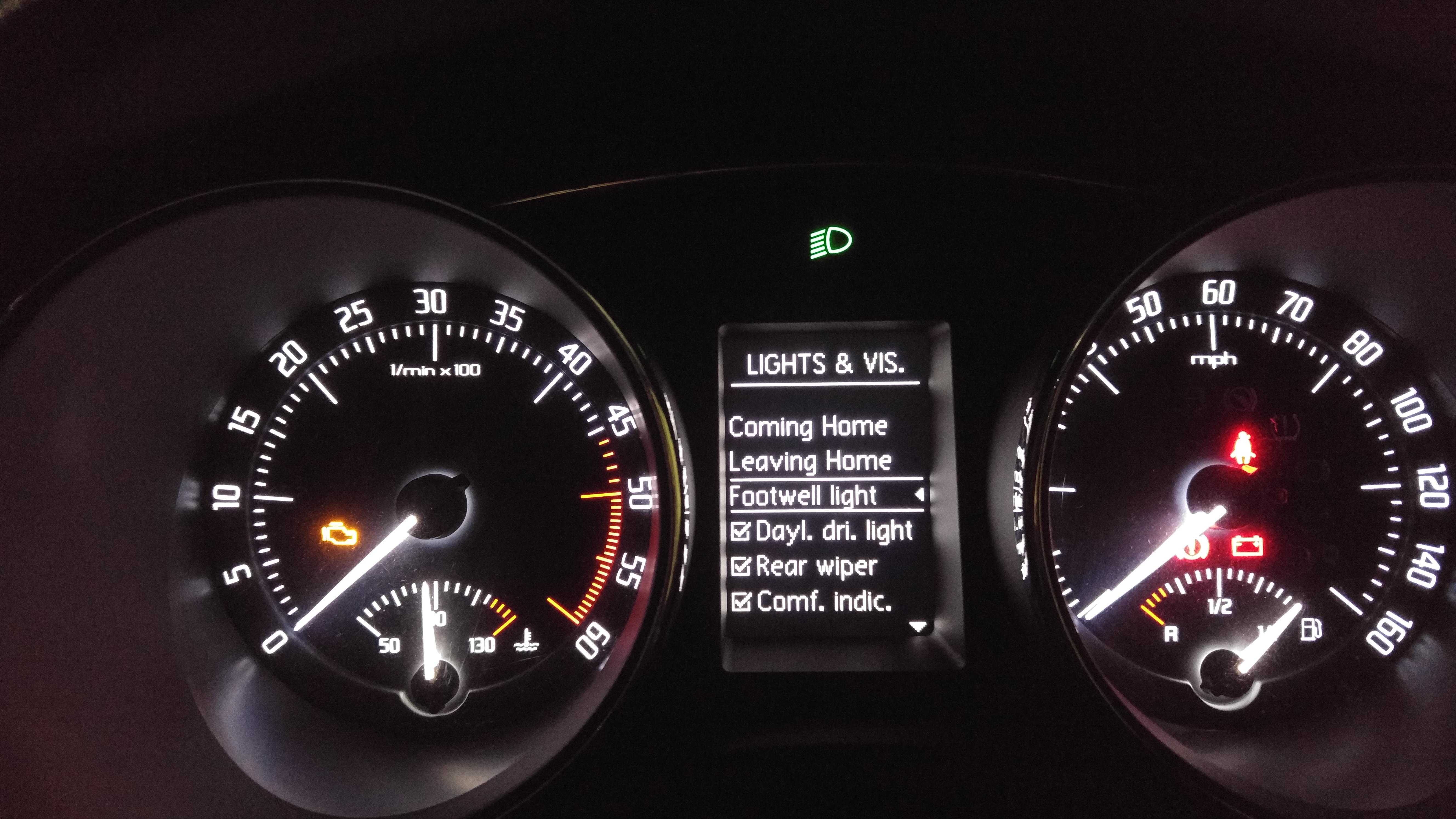

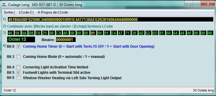

Mine need to be activated through VCDS. The option was in convenience and was the Footwell option 'Terminal 58d' similar to below, this then showed the option on Maxidot.

I found it the other day and turned it down as it was a little bright. It is definitely in the menu that can only be accessed when thew engine is off.

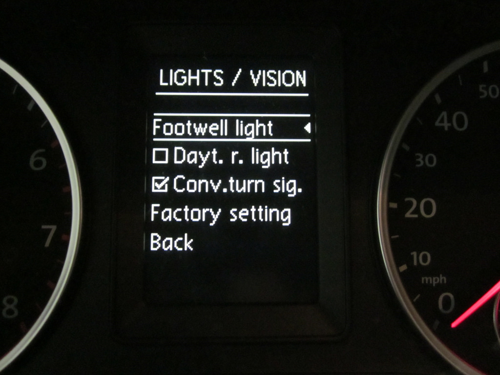

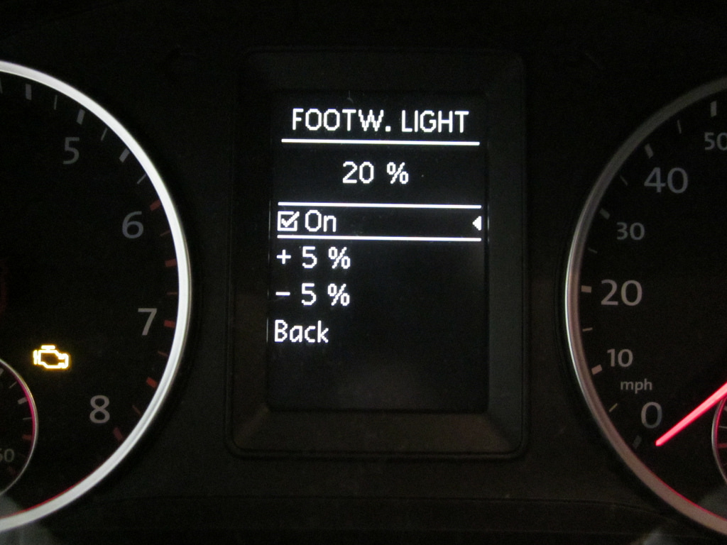

Is there not an option in Maxidot?  This is where I seem to remember doing it this way.....these images are from a VW forum
footwell2.thumb.jpg.ed920c76d4dd7b7e1ebbaca4d7620df4.jpgfootwell.thumb.jpg.61d1c6df85ec38b35c62ada708e110a1.jpg
Hi Roy,
Thanks for the images. Sadly I haven't got that option showing :-(
Then something (I know obviously) is wrong as that is standard on the Elegance or you are doing something not quite the same/correct/right. I am sure that you have tried it all but something simple is amiss here. I know having been there myself on many occasions :D.

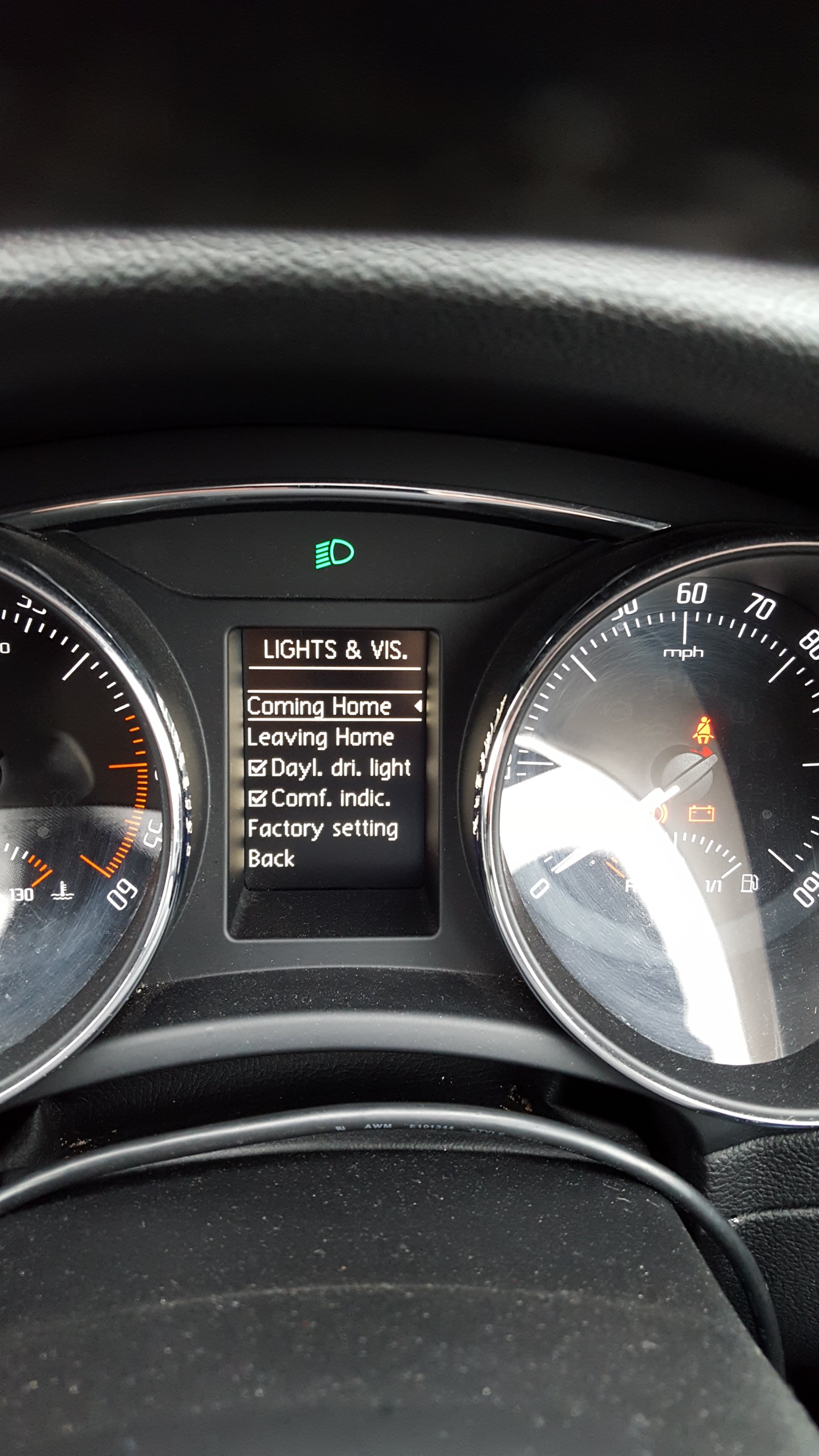

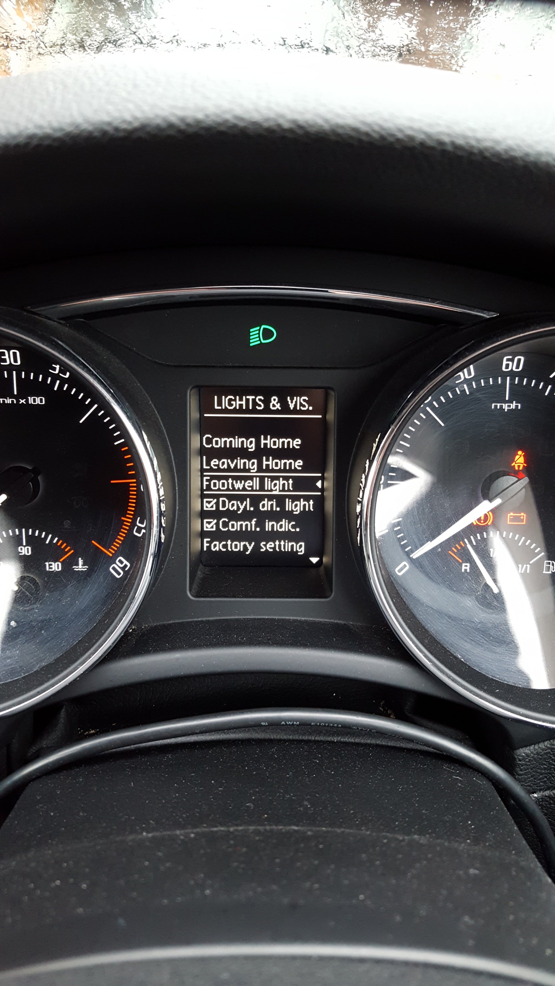

I thought it was me but I have searched and checked all sections and checked again.
This is what is showing on my 'Lights & Vision'.
Do the footwell lights when driving work off another fuse compared to when they come on when opening the door etc? I only ask as for all the fuse holders available, there isn't an excessive amount of fuses.
I doubt there is an extra fuse, I didn't add one when I retrofitted foot well lighting to my Octavia (similar electrically).
Can you post a full autoscan @Andy730 as this will show exactly which modules you have and how they are configured. It should help us offer better advice rather than guessing :)
The sequence for activating footwell lights is:
1. Select control module from VCDS main screen
2. Go into '09- Cent. Electrics'
3. Select 'Coding'
4. Long Coding Helper (if you've not already saved a scan, take a note of the coding before changing)
5. Go to 'Byte 12' and select 'Bit5' (Footwell lights with Terminal 58d active).
This then brings the option up on Maxidot.
Photos below with option de-activate and again once re-activated.
Mark.

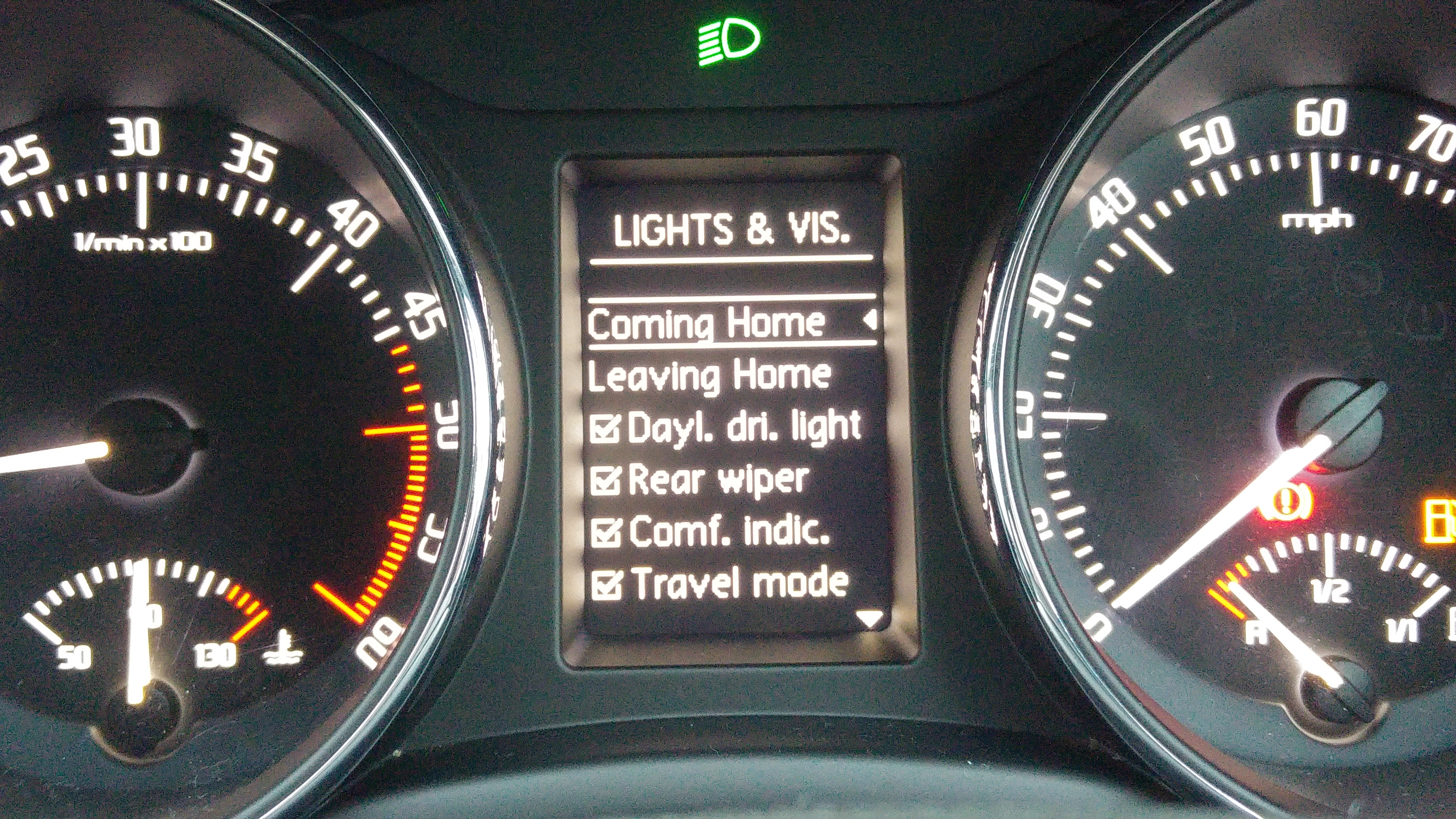

Andy, to state the obvious and again forgive me if you have already. In your picture have you scrolled down as it should be below that (travel mode).
Hi, no it wasn't in the options anywhere.
I had to turn it on.
Thanks so much to Mark for your directions. All sorted and working now.
It took a little working out to realise what to press to bring up Byte 12 but got there in the end.
I would have never found it without your support.
Thank you again.
Andy
