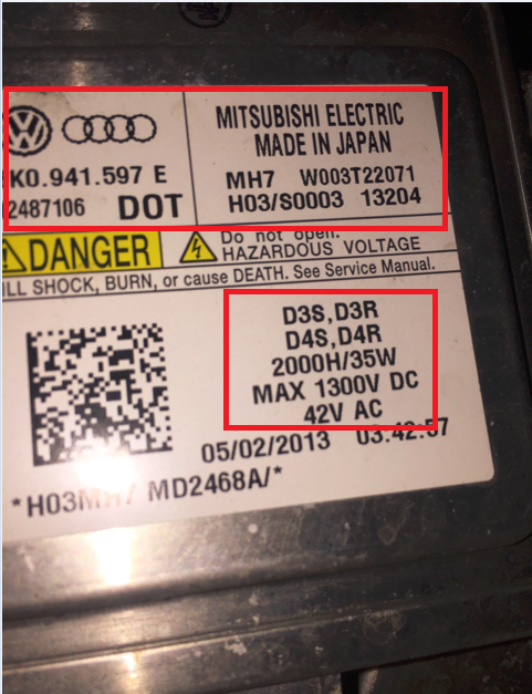

Hi Linni,
that's interesting that you are quoting D2S as the bulb type. I've just been looking at the rear of my headlamp.
I can see the Xenon ballast unit on the back of the headlamp unit. Its held in place by 3 Torx screws.
The Mitusbishi P/no. is MH7 W003T22071 and the VAG P/no. is 8K0941597E.
See attached picture of the ballast label, on my car it doesn't list D2S. But it does list D3S, D3R, D4S & D4R
I wonder if they fitted different headlamp units for different countries ? or for different models within the Superb range ? Mine is Elegance specification, not sure if you have that model in Estonia ? and I notice yours is the  L and K spec.
Thanks for the information about bulb replacement. All the videos I have looked at on YouTube, for headlamp bulb replacement for VAG cars none of them look like mine !!! All Superb and Octavia videos none show a ballast unit on the rear of the headlamp unit.
From just looking at the rear of my headlamp it looks as you need to remove the ballast unit, before you can access the bulb, but that's just a guess.
I expect you are correct about the need to remove the entire headlamp unit, that would be just my luck !!!!:blush:

Sorry, my mistake. Checked my online purchases and they are D3S.
