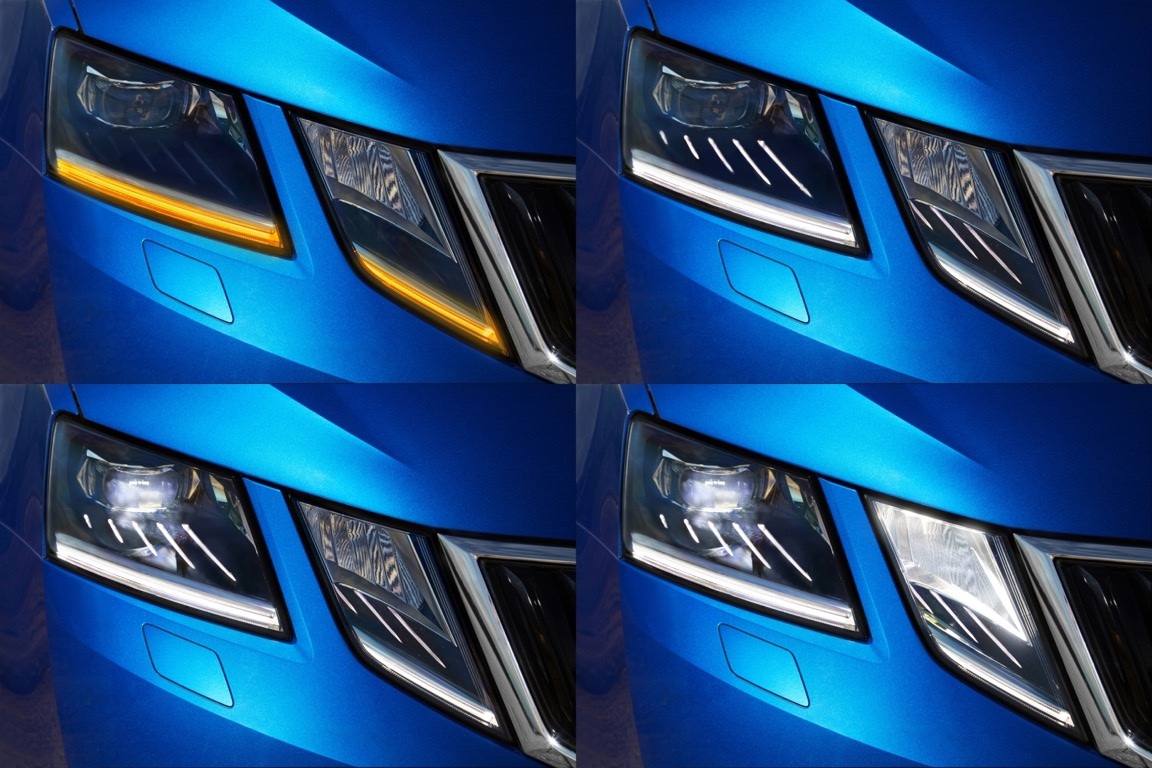

This is what the different lights look like on the full LED headlights
Thanks, Useful image!
Looking at those it looks like the DRL strip doubles as the indicator. I don't think it will be possible to do the in phase/ out of phase stuff that OP wants to do.

I don't want to do the phased thing I was just curious. What I would like to do  is a mod where the indicator sort of sweeps across the horizontal in the direction you are turning. I have seen this on American imports I believe ( not Skoda).
The DRL and Indicator strip are two colour LED's and sit below the chromed shelf that the sidelight eyelashes are on - I love those eyelashes.
I assume that having two LED strips per side ( one strip  in the dip and the other in the full beam section keeps the car usable for a while as replacement is not as easy as popping in a new bulb.
At best it's going to be an alternative flashing of white and orange, which isn't the same as a clear orange on, orange off that indicators are supposed to do.
Yes the DRL does double as an indicator strip but when the indicator for one side is activated the respective DRL automatically switches off so there is no white-orange-white-orange it is orange-off-orange-off if that makes sense. Once the indicator is cancelled the DRL comes back on.
