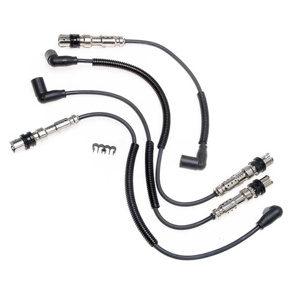

*that is apart from on early motors (pre 2012) failure of no 3 lead and as a result the coilpak also.  If the lead is not fitted with ribbed trunking (marten protection) as in later cars the lead often fails due to resting directly over the hot exhaust shield.
Ignition leads without trunking
https://goo.gl/images/zT5L5P
Ignition leads with trunking
https://goo.gl/images/YwuRU8

Some great information there on the HT leads- can’t for the life of me remember if they were sleeved or not, but will remember to check when I go see the car this weekend.
When I start the car, should I be able to hear the noise whilst sat in the car or get someone else to start it and listen from the outside?
The noise is loud you can hear it quite clearly it in the drivers seat. Metallic rapid ratchet noise like handbrake ratchet but lasting 3 or more seconds.
If needed, a new set of ignition leads with the marten protection trunking on is about £28 iirc from ECP, as opposed to well over £100 from Skoda dealer.
Easy enough to change provided you have a plug lead removal tool.
https://www.ebay.co.uk/p/Sealey-VS5293-Spark-Plug-Lead-Tool-VAG/1623343326
However the original clips that the leads fasten on that steel pipework are too small so a tywrap is needed to keep no 2 lead clear of that exhaust shield. My dealer just left it dangling and yes the trunking melted and welded on to the shield and burned out a hole. Yet another thing they did wrong......
Also when that original no 3 lead did go open circuit, it took out the 4 way coilpak, which skoda priced at something stupid like £260  iirc (you can get one from ECP around £60) although after a loud moan they gave me 50% goodwill on parts but not labour.

Xman, do you have part no for the leads?
No but a skoda dealer parts dept will tell you. Personally I tend to use carparts4less.co.uk (in the uk) just enter vehicle details....
Just noticed that the picture on eurocarparts shows the lead set with trunking AND a new lead clip. Those lazy ******s at my dealer must have thrown it away......grrrr.......
