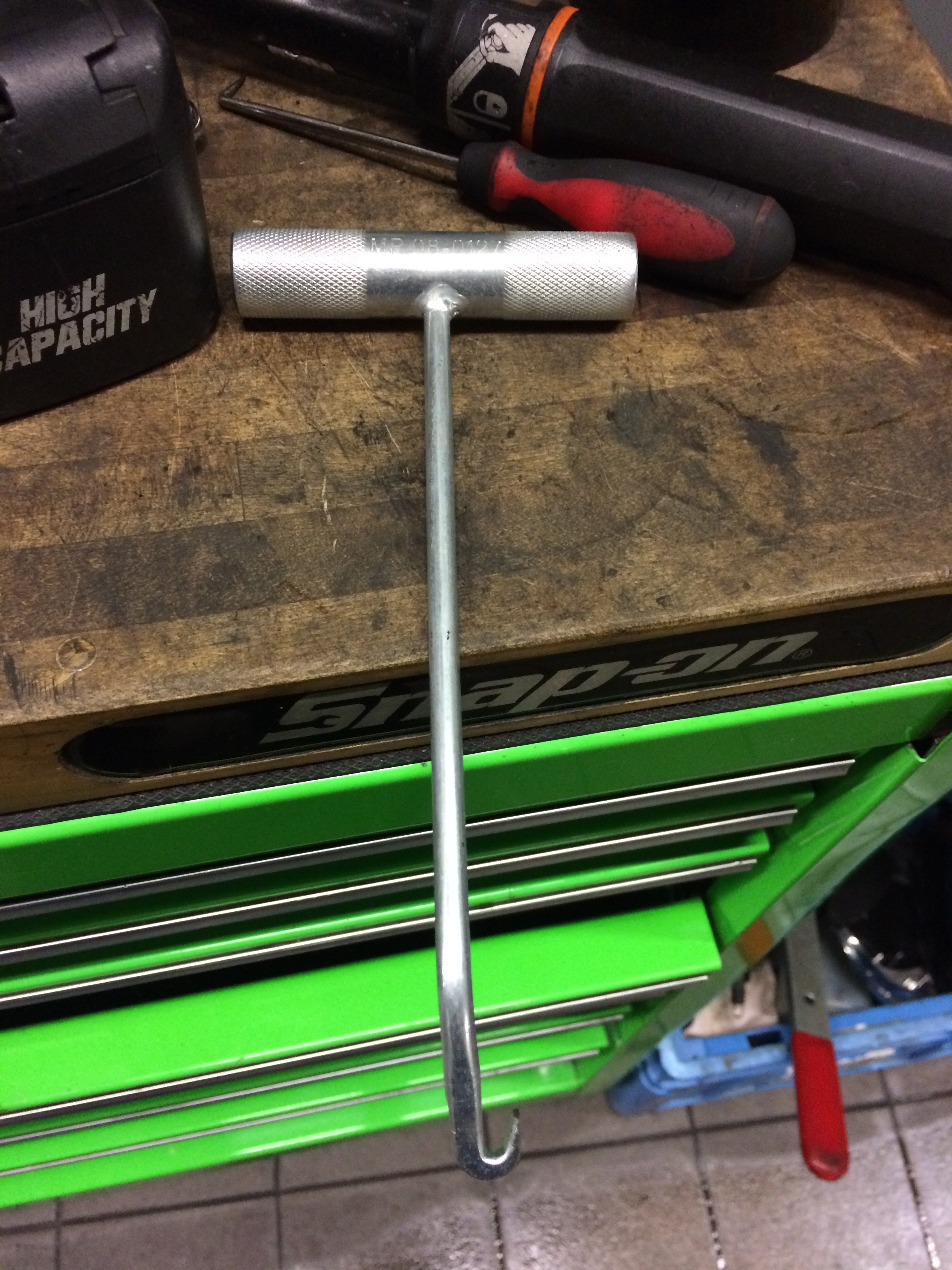

These help a lot if you do them regularly, especially on the bigger stufff.
I bought a DIYer/poverty version of that , the Tee bar on mine is a lot thinner than that one so a padded glove would help, in the end, after buying a new set of shoes at a special price deal via ECP, I got off with removing one hub nut to see if that let me see what I needed to get at to free things up a bit, that worked and I eased the adjuster up, did the same on the other side without taking the hub nut off, so I was left with a new set of shoes and a spare hub nut for, or when the next time. It was my daughter's late 2009 Ibiza and the handbrake was okay, but I knew that the last time I had checked these brakes the auto adjusters would not move at all, so I needed to do something out of common sense, before its next MOT.

Edit:- It took me about 35>40 years for me to wise up and buy one of these hold down spring removal/fitting tools, maybe I just enjoyed nipping my finger when using ordinary pliers, or spending hours retrieving the misplaced retainer plates, or just too many memories of doing this sort of job in winter and losing the feeling on my fingers and not knowing when I had managed to hold the hold down pillar or if it was rotating while I tried to rotate the retainer plate!

Never even thought of a tool like that. As we say in the council, learning has occurred.
Nothing's better than having the right tools for the job.
