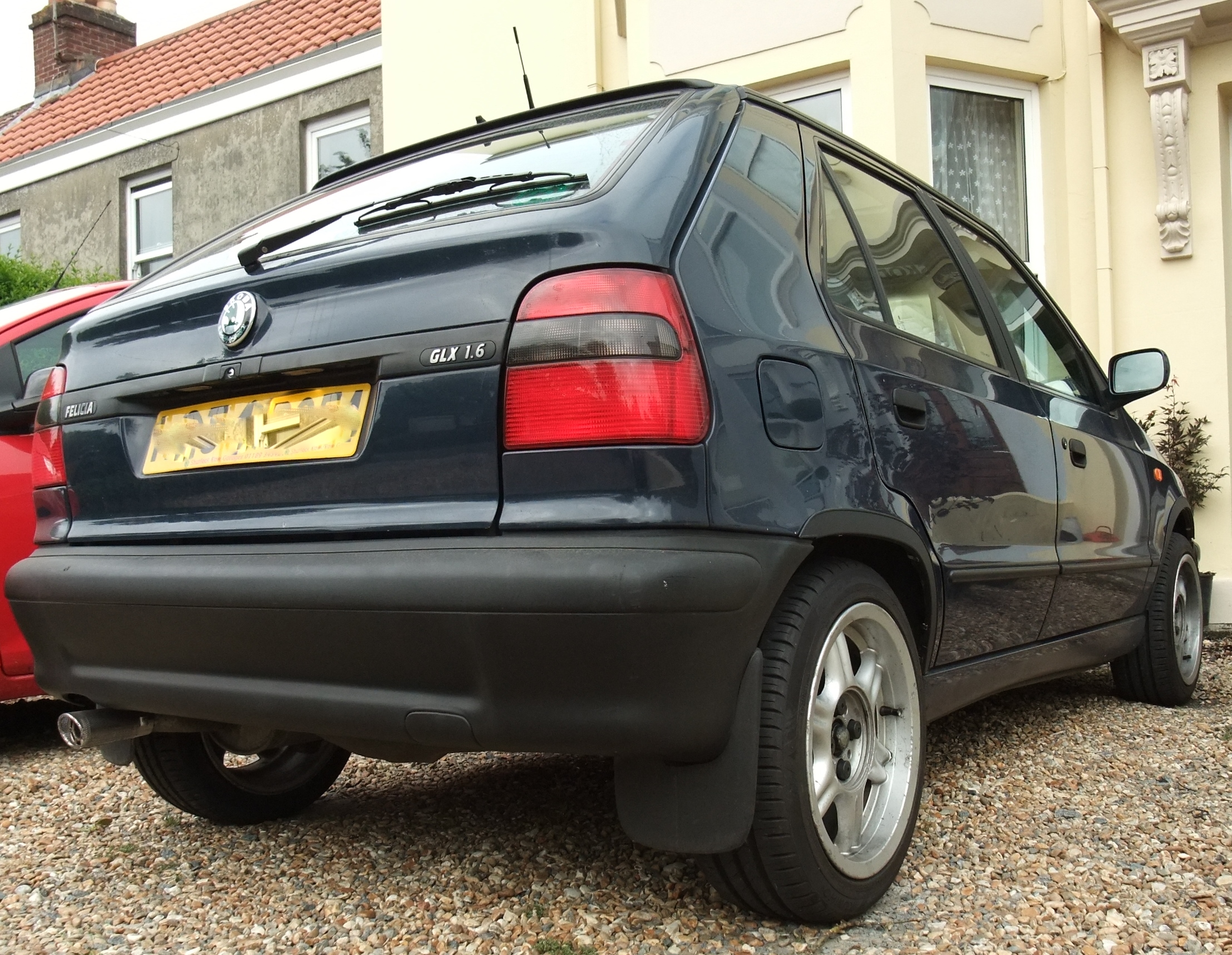

About the best i could get dodging the rain,  there's a couple more in my project thread or the appreciation thread.
I'm not sure why did you put wider wheels on the rear. Felicia has not rear wheel traction...
I know but the wheels were off my mk2 Golf as didn't have a choice at the time. I have grown to like them, though ideally i would have the same size all round not staggered. Might try and get another pair of the 16x9 for the front so i can put wider tyres on to help put the 1.8t power down.
@nu99et18
I like what you did, its obviously modified, but it isnt ruined, to the untrained eye it would pass as a stock car.

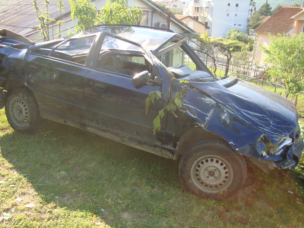

This is what im trying to avoid happening again, body roll that went into oversteer, then overcorected plus body roll, turned into more violent over steer, then overcorected finished as a complete 90degree turn, roll on a side, off the road and down hill into someones back yard. No one was hurt, except my driving ego

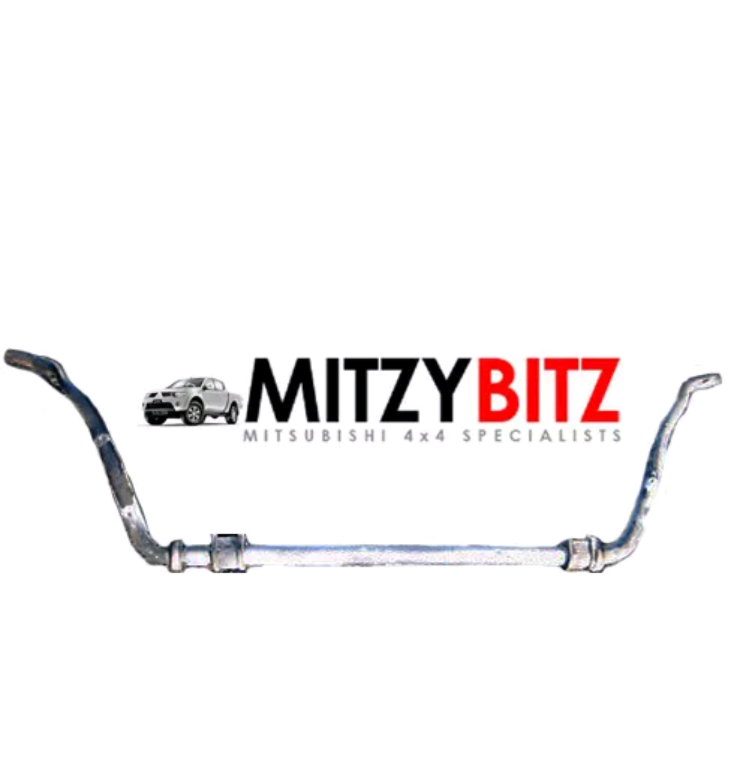

so that ARB from L200, do you know what model year was that one?
2001-2006 i think, looks like this

Nobody seen anything strange about the wheels on a crashed Skoda?
Yeah its missing a bolt
