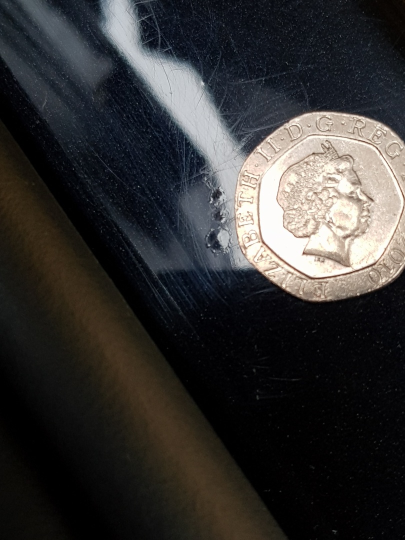

Hi guys quick update.everything is going good with yeti. Just after washing it I have found zinc incursion thing on my door sill. I went to skoda and they said that won't come under warranty as it's in a bit external area. They said sills and door shuts are a grey area and it won't get any worse so don't worry about. I don't really want new paint on my car for something so small witch is in a hidden spot anyway. My question is will it get any worser? And if it will get can I just chip off the head it and use paint chip over it.  There is 3 small ones the biggest Is only about 4

What has caused all those scratches?
Thats rubbish. You need to get them to accept liability before they burst. Once burst they will claim it is stone chip damage.
Don't touch it, as if you open it up you will never get them to repair it.
This is a well known issue and many have had substantial repairs, including in some cases all the door replaced.

Them scratches u could hardly see with naked eye. Zoomed in on camra with a flash. the plan was after winter getting it moped and detailed. The dealer offered to to do it but I said no thanks as a I no a guy.

The thing is i can keep pushing for them to do it. But if i can help it i would rather no new paint on my newish car as I have had problems in the past with new paint I don't want them to make a pigs ear of it. I would rather have as much factory paint as I can. That's why I wanted to know if this is likely to spread or get worse. Also they tried saying it was a bit of dirt under paint. I had to physically show them some posts and picture's of these forums.
Yes it will get worse.  & the rest of the panels need properly inspected.
& see what the 'Body Inspection reports' at Main Dealership Servicing showed.  Those Inspections are part of Main Dealer Servicing.
The repair required is to Factory Finish, or actually better because the finish now was from the factory and preparation fault.
So if new panels are required they get fitted and sprayed.
The whole procedure is known to Skoda UK because the fault is well documented and there has been a few years of dis-missing many owners.
Ok I'll give them a call tomorrow and tell them I'm not happy with there decision and saying it won't get any worser. New car experience had gone right down the pan. Mine is right on the door sill aswell. I suppose if it gets painted down there it won't be much noticeable

It will get worse. It will burst and then what is a bubble will soon become rust which once you have you will never get rid of without cutting out metal or replacing sections of the car.
As has been said the "it won't be covered" line is standard and many dealers trawl that one out.
INSIST they put in a claim to VAG on your behalf - no matter how much they doubt your chances of success. That's what I did - and guess what, a month later I had a Yeti with FOUR BRAND NEW DOORS installed.
And an apology from the dealer.
Just been dealers they took picture's to send off.one guy said he would just leave it as he don't think it will get any worser and the guy I spoke to yesterday. Stated the same he thinks it's just dirt trapped under the paint even after another long conversation about zinc inclusions, he reckons cause it's on the sill and not on the doors they have never seen it on a sill before.

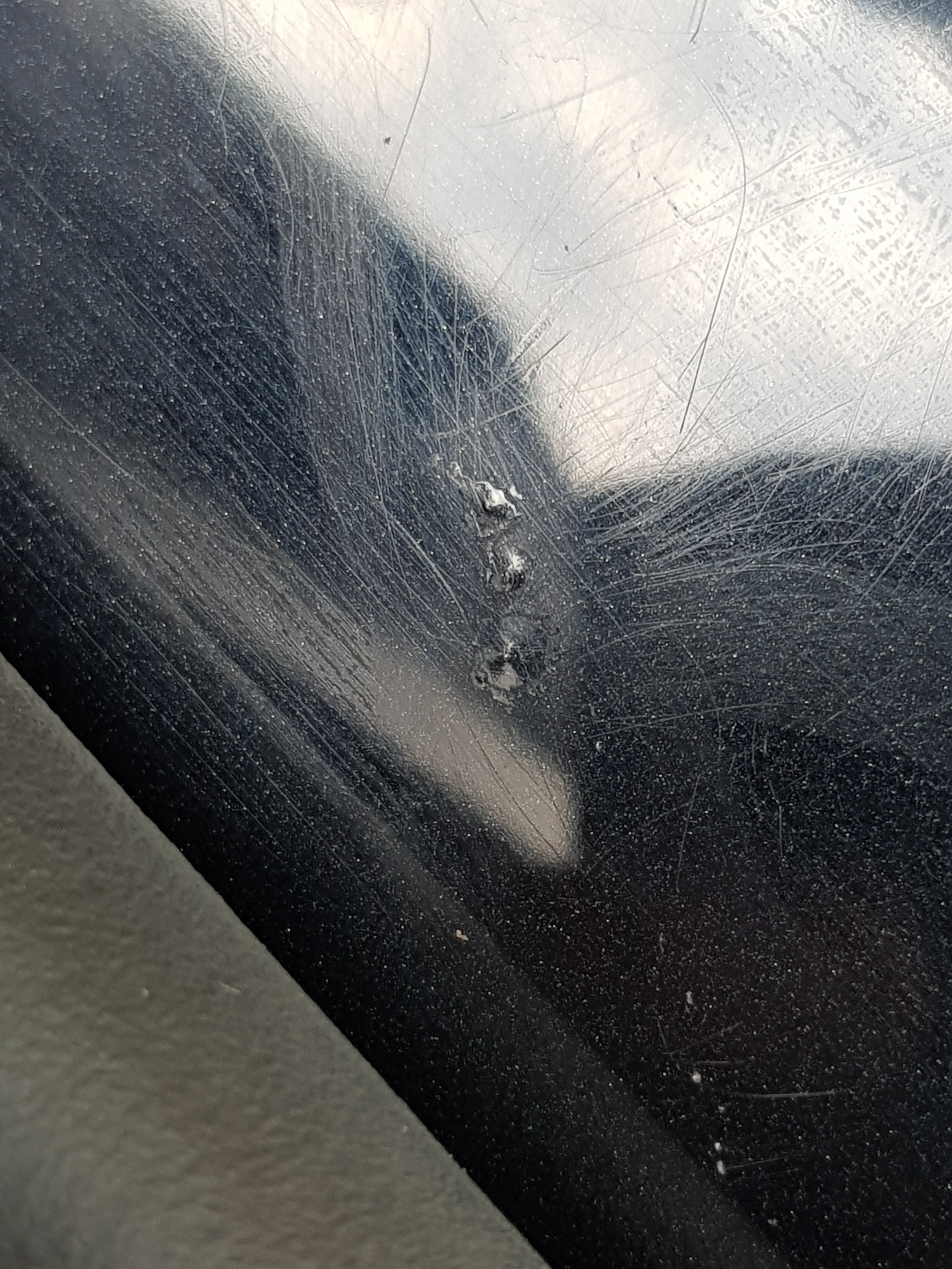

Better pic of it
Hi guys just a quick question If i get this painted what's the likely hood of this coming back?? This has got me so down at the moment I'm thinking of just get rid
Mine never came back (after 5 years)
