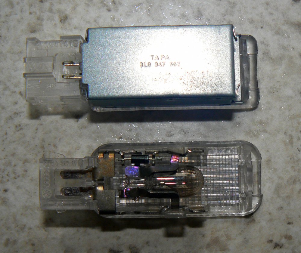

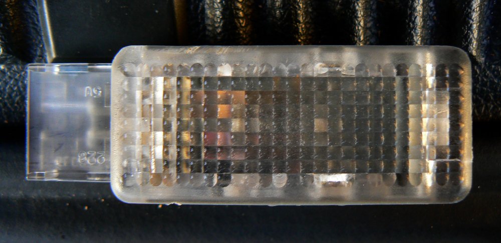

my boot light wasnt working so i clicked out the "bulb"
there doesnt seem to be any wiring attached to it even though the contacts show something was connected to the "bulb" at one time..
i wonder if there is a something which would have been attached to it to "fire" the lamp and controlled by radio wave..like the central locking..and boot release lock especially..and when the boot lid was released the lamp came on???
this situation along with the funny little push button "switch" on the drivers door is making me wonder if they are related

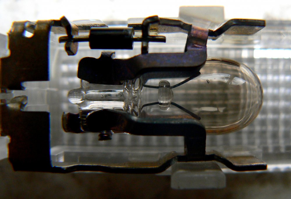

FURTHER TO THE ABOVE

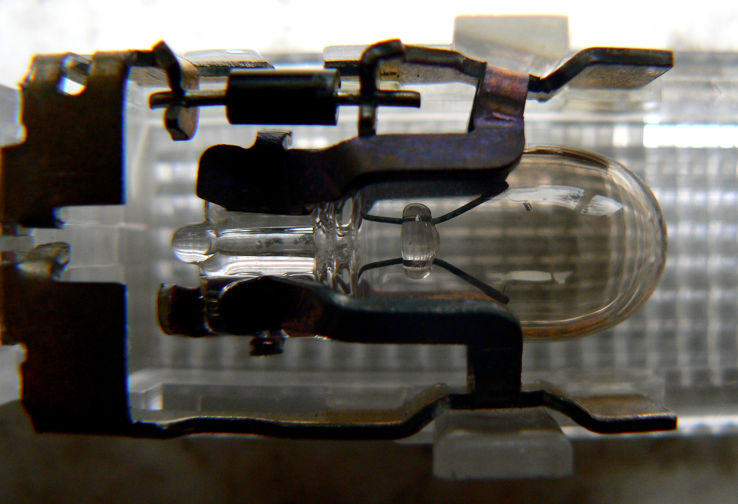

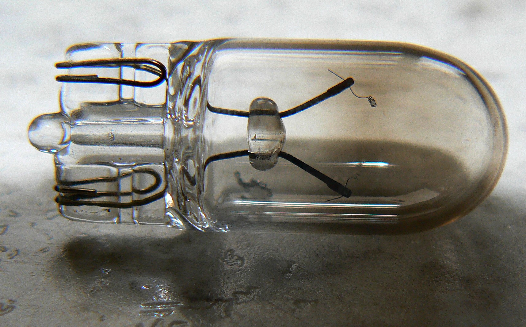

i checked out the glove compartment light..not working..bulb gone
managed to get it out...the whole thing...daft me i didnt know the bulb part pulled out
in the process managed to fuse the lighting for inside...buy one 7.5 fuse...and one bulb

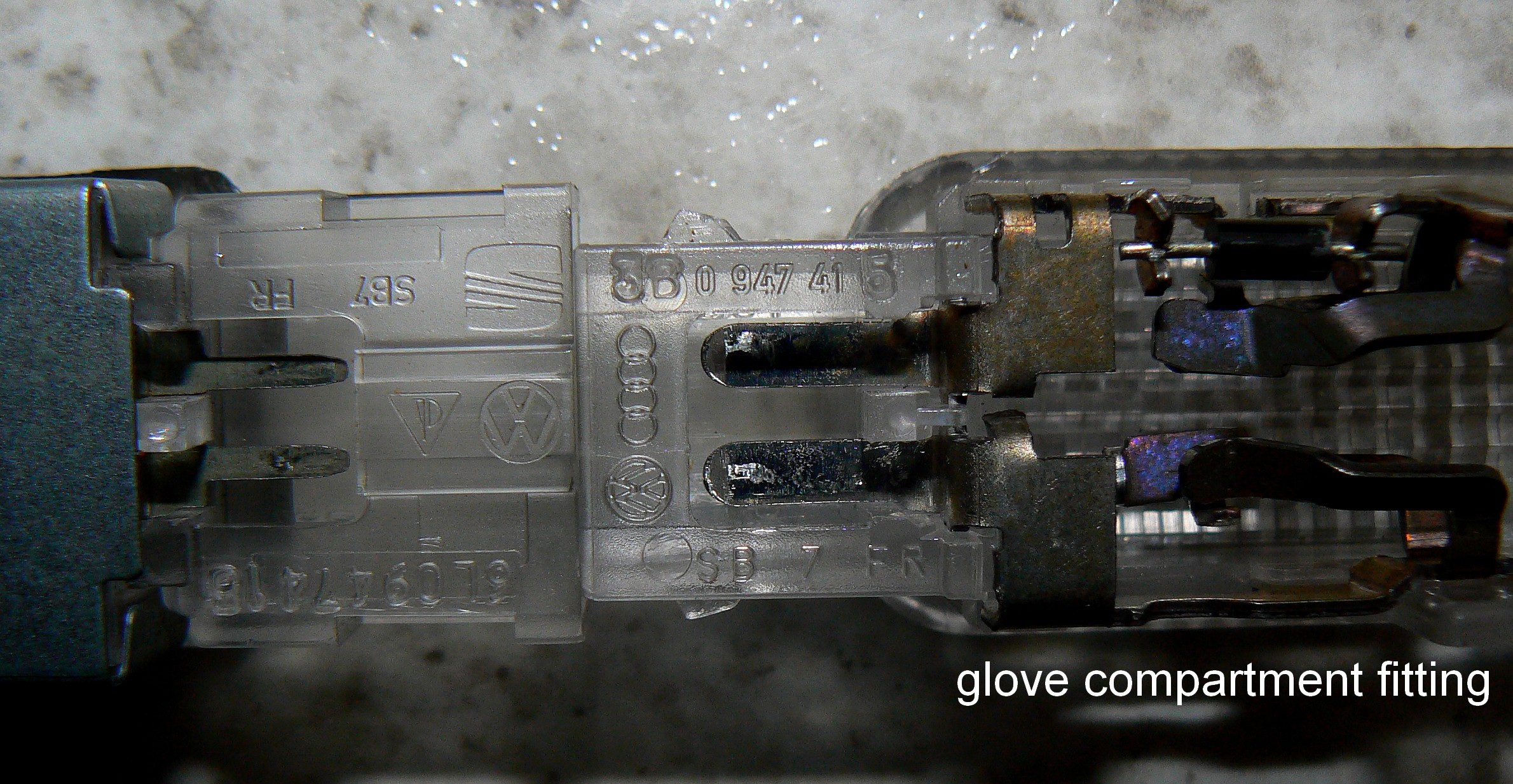

my handbook tells me this light and the boot light should be the same bulb

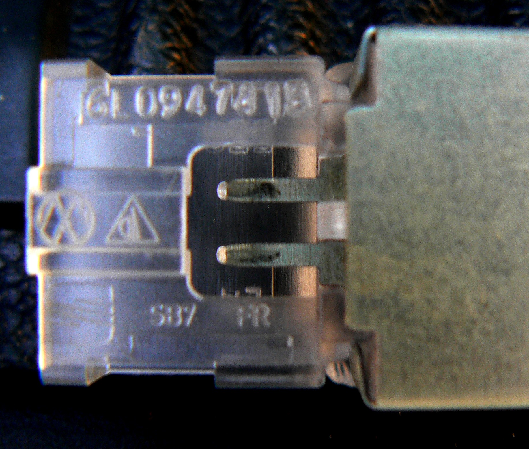

as you can see the boot fitting seems to be of a different type and not the same as the glove compartment
you can see the differing connection prong sizes and pitch....
my feeling is that the boot has been changed and the connector rewired to suit the larger prong bulb..? is this an led one?
still cant find any wiring up inside though ...
so i at least can get the glove compartment working and...next time remove the fuse prior to mucking about
cheers
geof
ps pics i hope will show the situation clearly

new photo
Hi, yeah very weird light and bulb combo... As mentioned, I have ordered LED fitments (Complete lamp) From China, a pair for around £8 so boot and glovebox hopefully LED'ed up soon. They will perhaps be more bright with less draw and less failure and fiddle! The whole lamp will plug in after removing the old one.

The boot is on a timer of about 2-3minutes after it’s closed.  I assume the glovebox is the same.
Oh!  Now I'll have to check my wife's 2015 Polo to see if it has a "closing delay" - more things to do !
No it isn't. The boot light goes off as soon as the boot is shut. Same with the glovebox light.
Don't believe me? Try it yourself with your phones video camera.
At least checking the boot light goes off on a hatch or estate is easier than checking that the light goes out in the glove box or  with a fridge.
(some that get a flat battery find it was due to a faulty glove box light switch and the light was staying on.)
