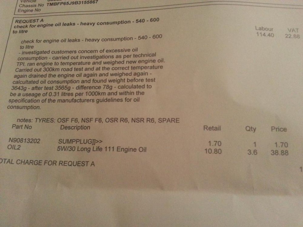

** Only the 1.2 44kW engine checked cold.,
 As to check 'Warm' that is wrong, it is 'Check at operating temperature' as in the VW Manuals for the same engines', as usual lost in translation, German, Spanish, Czech to English or US English'.**
See bottom invoice.
That was some Skoda TEch that seems to think 1 litre of Engine Oil weighs 1,000 grams,
which it obviously does not.  This was an oil user, they said within tolerances, it was not, the terst was rubbish, Skoda paid for a new engine.
