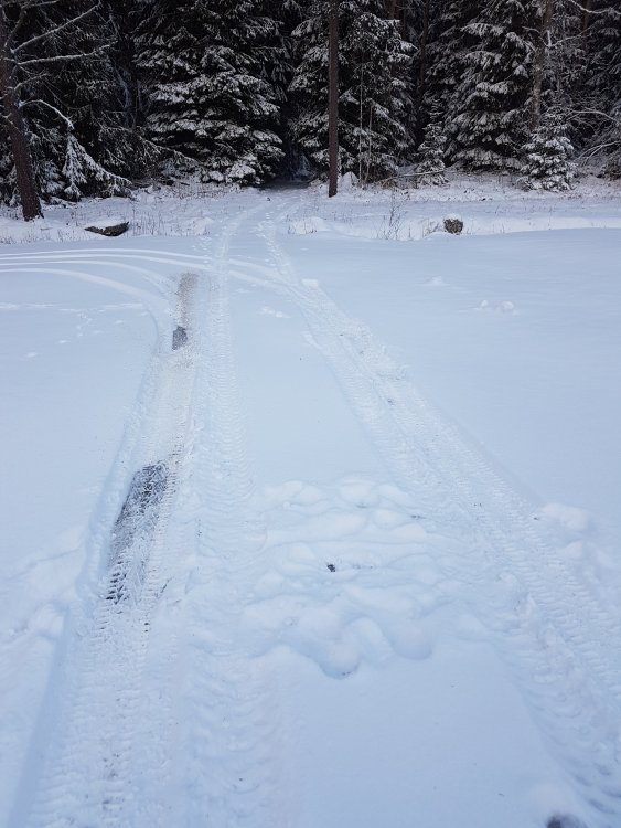

Tested the 4x4 system after changing a parameter in OBD11 to something with increased traction - I read about it in another thread. A little bit surprised of the tyre tracks. Both sides of the vehicle hade the same ground condition - powder snow on ice. Looking at the picture only the right hand wheels started to spin (left on the picture). Tried both before and after changing parameter.
1. Normal start full gas - front wheel spin before rear activated.
2. Launch control - I think front wheels started to spin before rear.
After parameter change
1. Normal start full gas - front and back reacted at the same time
2. Launch control - Front and back at the same time.
What's weird is that our XC70 also equipped with Haldex 5 has a lot less wheel spin both in speed and also from start. Must be different calibrations of the Haldex 5!?

I'm aware of how it's supposed to work. What I wrote was that by changing a parameter the way it works is altered.
Just came to think of that I had ESP in sport. That might be the cause of only right hand wheels spinning.
Good work confirming that there is a bit of front wheel slip built into the standard haldex map. Quite why is another thing though!

I think it's because of durability reasons. Volvo did get some criticism when they launched the Haldex 5 as it was a step down from Haldex 4 in performance. Haldex 5 just wasn't as quick in its reactions as Haldex 4 and allowed for wheel slip before engaging rear wheels just like Haldex 2 (maybe 3 also). Volvo listened and reprogrammed the unit to be fully locked at takeoff. I believe they made this change as the XC70 and it's likes are a popular choice (at least in Sweden) amongst people who also considers the A6 Allroad, Subaru outback etc. They simply can't afford to be "worse" then the competitors.
Skoda Superb isn't in that situation and doesn't attract the same amount of people who puts the four wheel drive capabilities in first place.
This last part just reflects my thoughts about why Volvo put some effort in it and who is considered as a potential buyer.

Adding my latest findings :)
Behaviour as described in my post above was indeed caused by turning of ESC to enable launch control.
When flooring the pedal with ESC on, gearbox in "S" all wheels are being engaged, it's a little delay because of the brakes being engaged etc.
