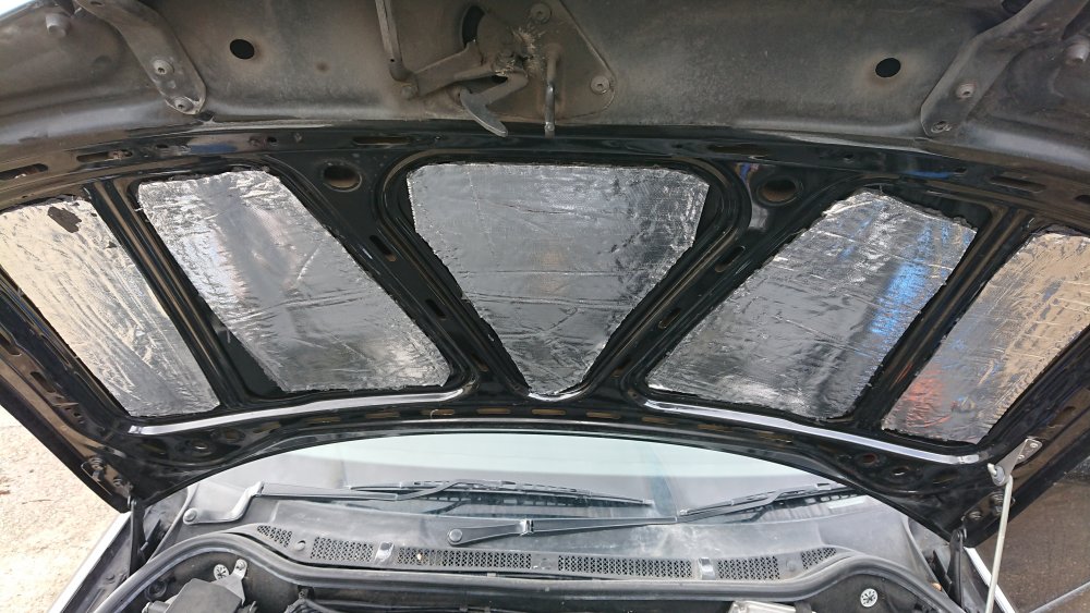

Thanks to all the lovely people on here, I've got all the additional soundproofing fitted under the bonnet. Really made a big difference.....

I've also put the bonnet pad over the top of the new soundproofing..........wish me luck! And, ordered some new clips (thanks for the link, TMB) as Captain Cackhand (TM) dropped four of them in the engine bay!
On the front, it's hard to explain - I'd liken it to gently cupping your ears - noise is still present, but it seems more distant..........
