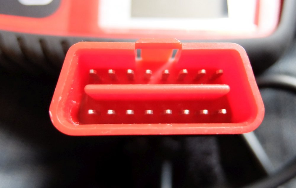

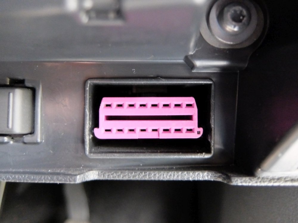

I tried borrowing a friends OBD2 scanner and found it would not easily fit into the Fabia's (VRS - 2013) OBD2 plug socket located next to the fuses.   Looking at the connections the Fabia has a rectangular outlet surrounding the internal plug whereas the  OBD2 scanner is of a trapezoid shape (this seems to be common)   and is slightly larger than the Fabia rectangular opening!  So is the Fabia MK2 OBD2 socket a standard size or does it require a non-standard sized scanner plug?

Thanks, it must be the plastic housing on the scanner plug that is just too large for the opening - I didn't want to start filing the sides of the scanner plug as it was not mine.

That is the point of the OBDll socket it is an standard size that all manufacturers use,  so even the size of the trim cutout should be the right size to accept the mating connector
I can only assume my Friends scanner has a slightly oversized connector that has not been made to the standard size :dry:

I know this is an old post, but it seems most folk are missing the point. The pictures clearly show the standard male plug hasn't a hope in hell of fitting the fabia/roomster female socket, which I found out yesterday. My brother has a Octavia and the standard plug fits fine.
Well if you think that the aperture for the OBD2/OBDE connector is tight in that picture, I can only say you should see the size of the aperture in a B5 VW Passat, luckily for me, I bought VAG-COM then updated to VCDS and also used a Gendan hand held scan tool and while it was a tight fit, it did fit in.
I'm guessing that some of these DIYer scan tools manufacturers are not making the back shell of their connecting cable out of quality/strong material so need to beef them up to avoid them breaking up - and in doing so making them less than useful for some applications.
Edit:- the trim designer that drew that detail for the MK2 Fabia must have been a clown though, it should be a bit leaning toward being trapezoidal to give the buyers of some of these cheaper tools a chance.

I found on my mk2 ovctavia it's not the size of the hole and cut out but the length which is the issue.
Some obd devices seem to have a shorter socket before the main casing which fouls on the surrounding and so the pins cant make contact for it to work.
Tried 7 different OBD devices and 3 were simply not long enough.
You can remove the plastic trim easily to alloy you access to the whole ODB port without the hindrance of the rectangle, Had to do it with mine.
