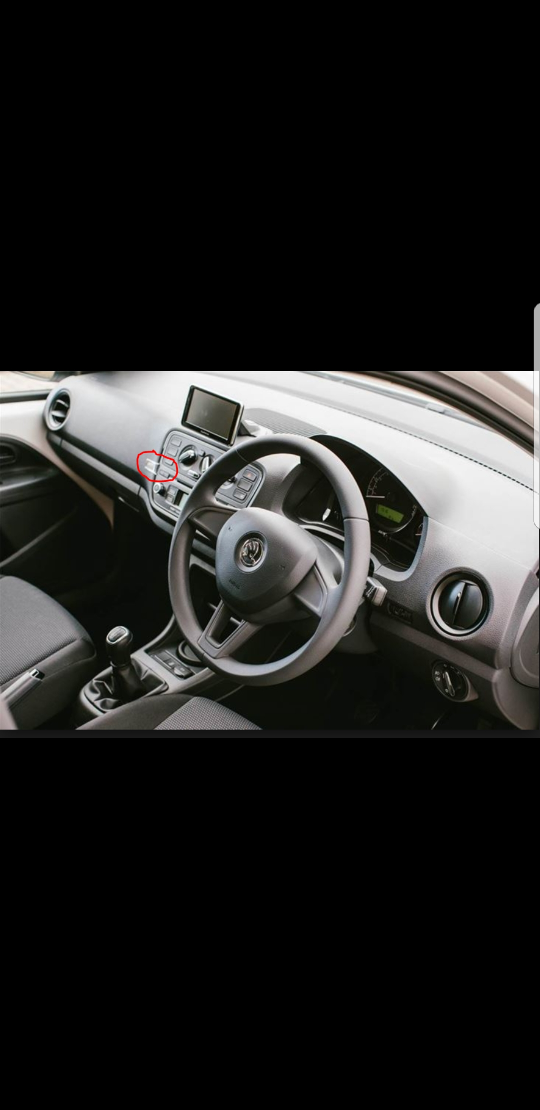

I was wondering if anyone has had any experience of replacing the photo holder in a citigo? (the plastic clip that sits on the left side of the dash board).... my dealership is wanting £30 just to replace the plastic clip!
If so, I would really appreciate it if you can give a step by step guide on how to do it? Hope it is a straight forward job!

I have just replaced mine for around £3. You have to remove the radio first. I bought a trim removal kit on EBay for around £5 which has a number of plastic trim removals tools and the radio removal tools - You also need a t20 Torx bit. There are good you tube videos on how to remove the radio - once out you will see that the clip sits on a little post behind the radio and is easily replaced. There is a bit of a faff pitting the radio back in as the harnesses need a little persuading to go where you need them to, but quite a simple job - if you have the right tools!

I had the same problem when bought mine Citigo - clip was broken. It is bit of a hassle to get it replaced as someone wrote it already, You have to remove radio unit and heater controls in order to replace this clip. Actually, just loosen the 4 screws holding heater control dials and pull radio unit slightly forward. Just be very carefull not to pull out Your heater controls to far out as one of the operating cables may come off loose.
VAG Part No: 1ST 857 956 (for LHD)
VAG Part No: 1ST 857 955 (for RHD)
