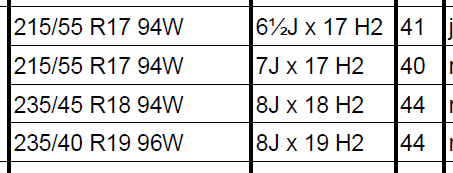

This document http://www.rindt-gaida.de/wp-content/uploads/2016/08/Serienreifen_02_2017.pdf (German Skoda dealer) was on the Skoda,de website.  Google describes it as "17 Feb 2017 - The TÜV technical monitoring Hessen GmbH, area auto service, has the compilation of.Series tires on behalf of ŠkodaAuto Deutschland GmbH created for the following vehicles: Škoda Citigo.(Type AA). Škoda Fabia. (Type 6Y). Škoda Fabia practice. (Type 6Y). Škoda Fabia II. (Type 5J).........."
I think this is the approved tyre/wheel/offset for the 280 engine
