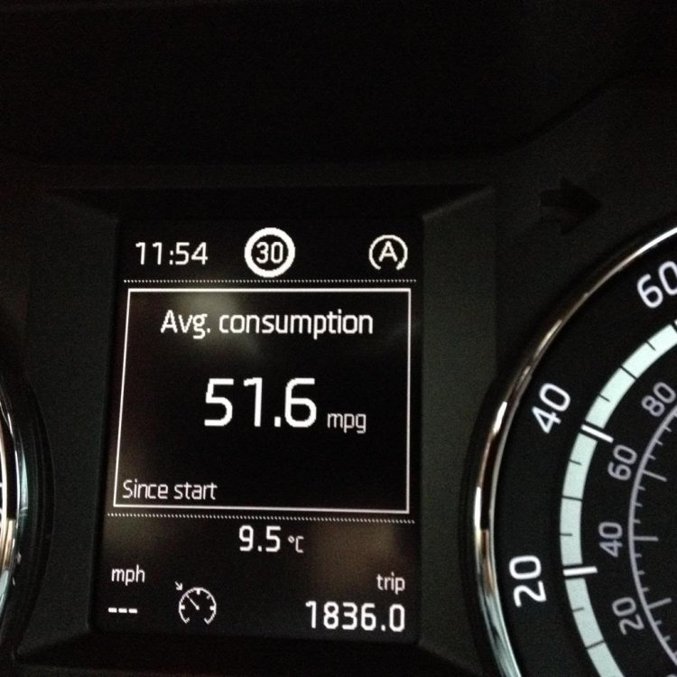

Howdy.. i own a 2015 Octavia 1.6tdi Ambition Combi, is there a possibility to add speed from the nav split screen.. where it shows speed limits from gps? kinda looks like this searched the forum and google.. can`t find anything..

No.. can`t say I have... I thought there was an option i wasn`t seeing to move the "split screen" info to the maxi dot.. or like to switch it instead of the compass or some such..
