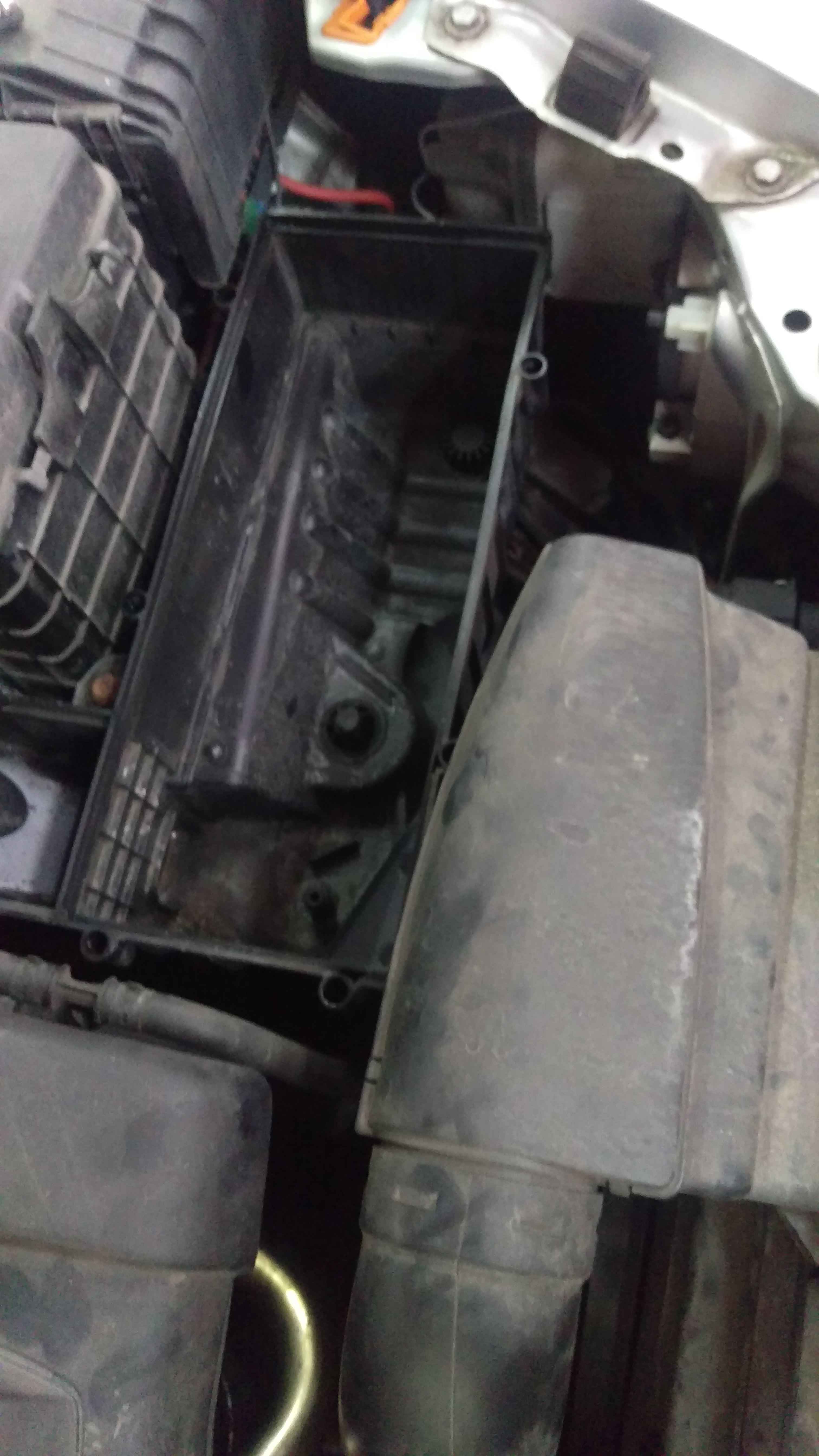

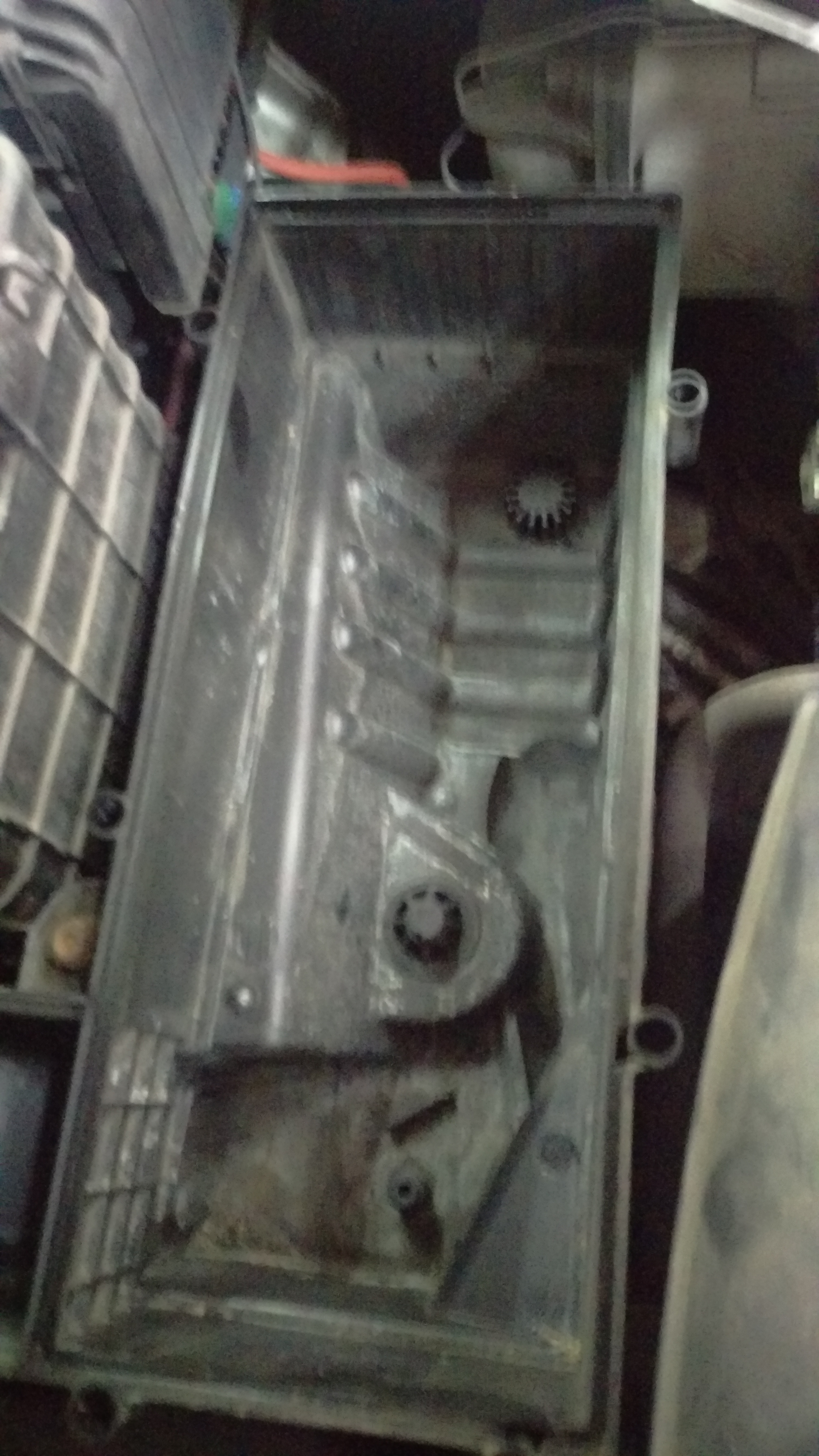

changed the oil and filter today so took the opportunity to have a look.  took the air filter out, also the plastic mesh bit underneath which just left the casing.  undid the torx screws, also the allen bolt behind but it wouldnt come off.  wondered about the 2 screws holding the front part of air intake, so i took those out too, still wouldnt budge.  didnt want to break anything but worked out it seemed to be fixed at one, maybe two locations at the bottom of the casing, some strange looking things.  ive taken a pic to show you.  could anyone tell me what i need to do please?
