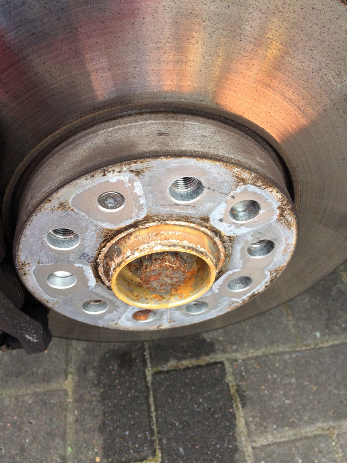

You are lucky that your wheels were stuck on the hub as  having only 50nm tq on the wheels, you could have been driving on 3 wheels!
Can I suggest that you clean off that rust on the hub with a wire brush and use some copper anti-seize on the hub - this is from experience.  I had the stuck rim as well but some gentle rocking got mine off and don't expect any issues next time when I rotate them after having applied some anti seize.

Indeed, I cleaned and greased the hubs. That’s a given.
I’m also not shy about cleaning and lubing wheel bolts with a wipe down before fitting.
And I do reduce the bolt torque a bit if I think there’s any lube left on the bolts.

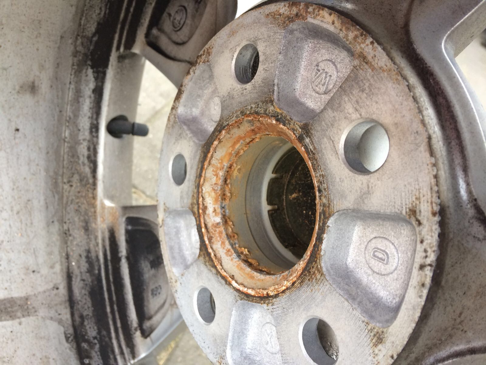

Many notice the White Spider on the Centre Caps, then the White Spider on the Diamond Cut VW Group wheels.
& go to remove the wheel, then find the Hub and Alloy have mated nicely, and that Corrosion welding the Hub to the Alloy with no barrier of Grease is causing the wheels corrosion.
It is just how it is with 2 dissimilar metals.  Nothing new, so most with a clue know what to do to inhibit this corrosion.
(not much you can do with the Not Fit for purpose coatings on VW Group Diamond Cut face Alloys, but the same is happening to the painted ones, you just can notr see it...)
The OP's Hub & Centre bore are not as bad as they can get when no Copper Slip is applied between the mating surfaces.
Alloy of wheels rather different from the Hub Material.  ie Dissimilar Metals / Alloys.
Those with the likes of a Fabia or Citigo with Drum Brakes and Alloy wheels really need to go check if their wheels can be removed without a Road Side First Responder with big boots and a BFH.

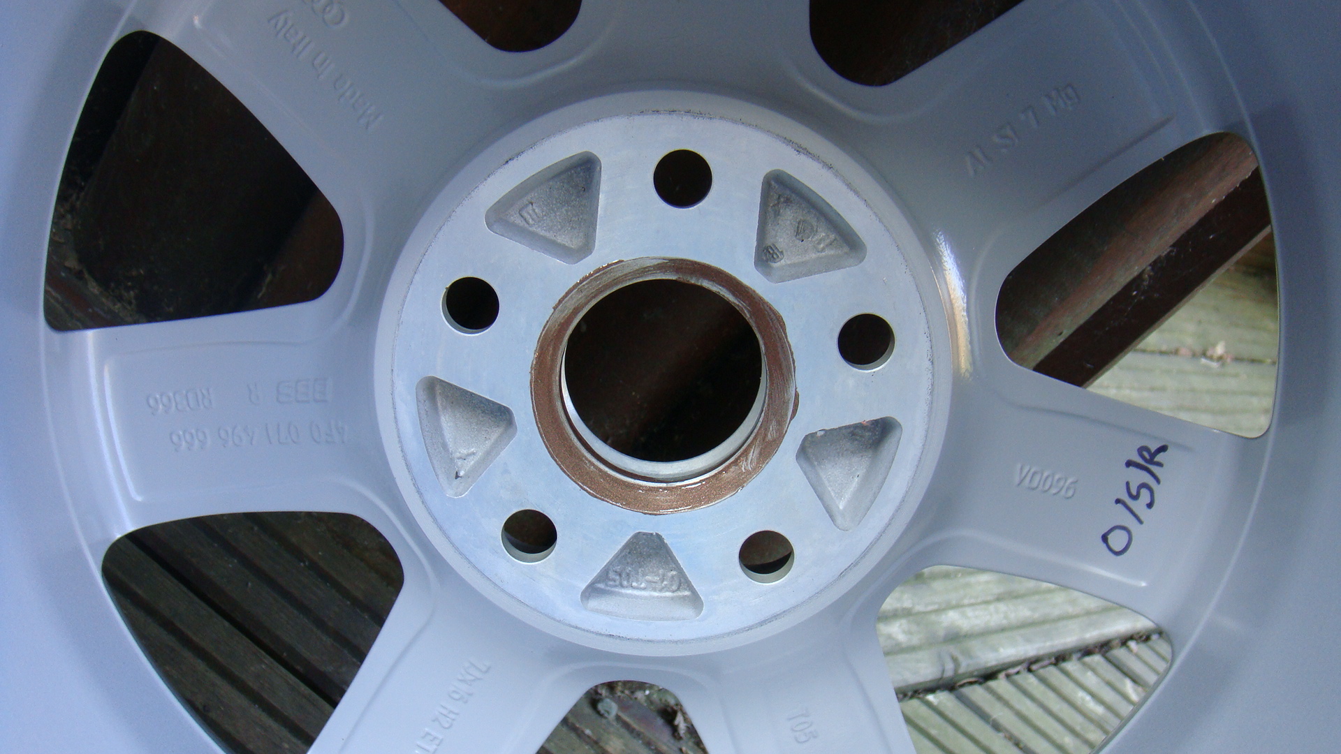

Only on the spigot, do not put any on the face that sits flush to the brake disc:
My 2p's worth...
Copper slip is about the worst grease you could possibly use between a steel hub and an aluminium alloy wheel. Mega electrolytic corrosion will ensue and pit the alloy mating face.
Copper slip is only any good on steel to steel interfaces.
Clean up all corroded surface areas with steel wool or Emery paper, wash down with brake cleaner then use a thin smear of something like brake grease (ceratec) only on the mating spigot surfaces and the outer few mm edge of the hub.
NEVER GREASE THE WHEEL BOLTS OR GET GREASE IN THE HUB BOLT THREADS, clean them with a wire brush and again wash off debris with brake cleaner
