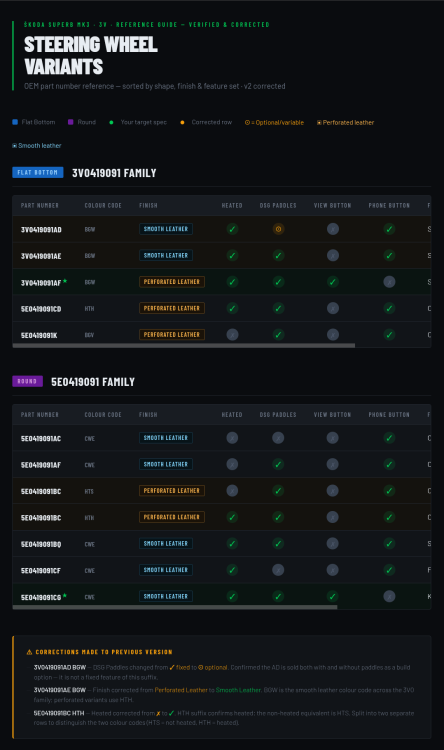

  • So, my friend John Claude made a chart. Steering Wheel Guide Link skoda_steering_wheels-1.html
  • I'm back with a another update! Version 7 - Download the HTML to view. Notes: Here's the verified V7 chart. Click the amber banner at the top to see the full changes log. Here's a summary of what was

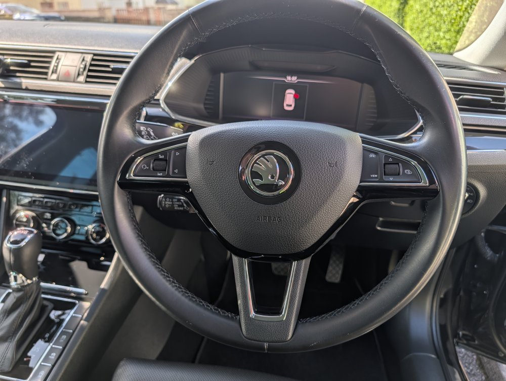

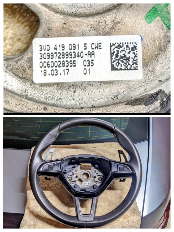

This was the original round steering wheel on mine (MY17) before I replaced it with a flat-bottomed steering wheel.
Thanks
I’ve found an M one which looks to be equivalent to your S. Fingers crossed.

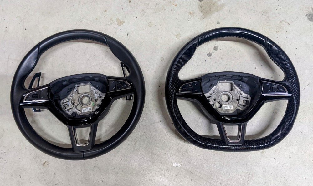

Here's a side by side comparison of the two I had/have.
Both very similar in feel and thickness.

Unfortunately not. All I did was search eBay until I found what I wanted and zoom in on the part number stickers in the photos.

That looks like useful info but seems to be displaying as html on my phone
Yeah, tried posting HTML... Didn't work. Adjusted now
Oo that looks good. Have you got a link to the page?
I've attached the Claude URL and a copy of the HTML file.
Feedback is welcome!
Ah ok. Might need some verification. Also missing some of the round ones but it’s good to have a list of most of them
