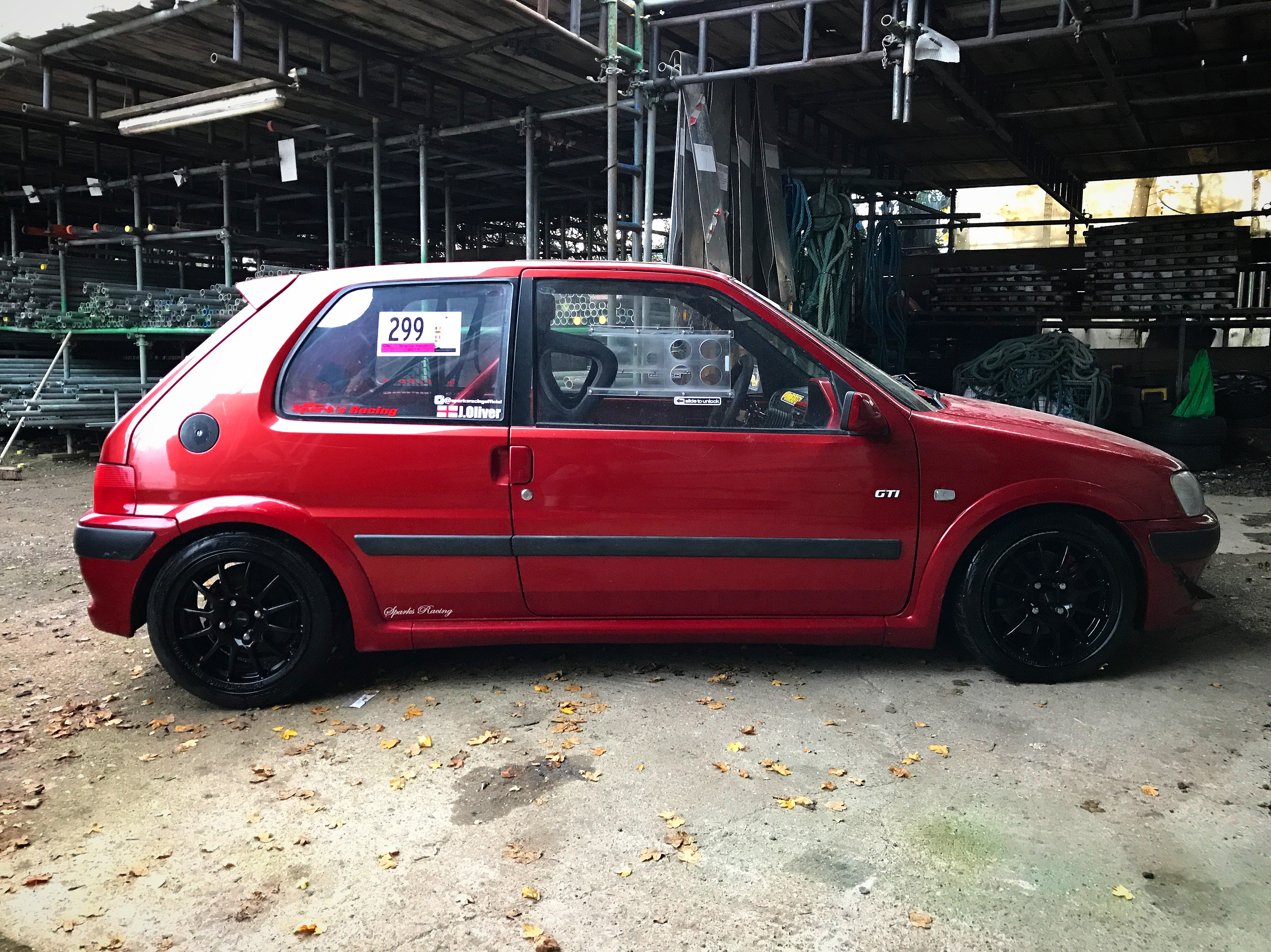

When the 106 was weighed/tested for 0-60 it was actually completed with a full tank of fuel and 4 passengers, the car was much quicker than first thought and if the tests were carried out with 1 driver and empty tank the insurance would be too high for youngsters who which the car was aimed at, google it, known fact in the 106 world. My 106 has one single carbon kevlar seat, the entire insides have been gutted, all glass replaced with Perspex apart from the front window, the inside of the door skin etc have been hole sawed for more weight reduction, it's around the med 800kg mark id say it's been on a serious diet. No carpets trim etc all ripped out, I would need to get it weighed to find out exactly.
my fabia rolled 166/325 with flash map, may be riddled with boost leaks as it does soot at the higher rpm over 3/4k
the 0-60 time in the 106 is much quicker than what they state, I also have a VTR gearbox in mine so it doesn't hit the limiter in 2nd til about 70/75 so it shaves even more time off 0-60. Much longer ratios than the GTi box, however it doesn't accelerate as quick as the GTi box so it's swings and roundabouts but I prefer the longer ratios on track. Brands hatch I barely get into fourth and that's just before paddock hill bend before I'm back down into 3rd, Lydden hill is only 2nd/3rd don't even get into 4th
That'll be why its quicker then
If you were to do the same weight saving to the fabia and sort the boost leaks it would feel quicker.
