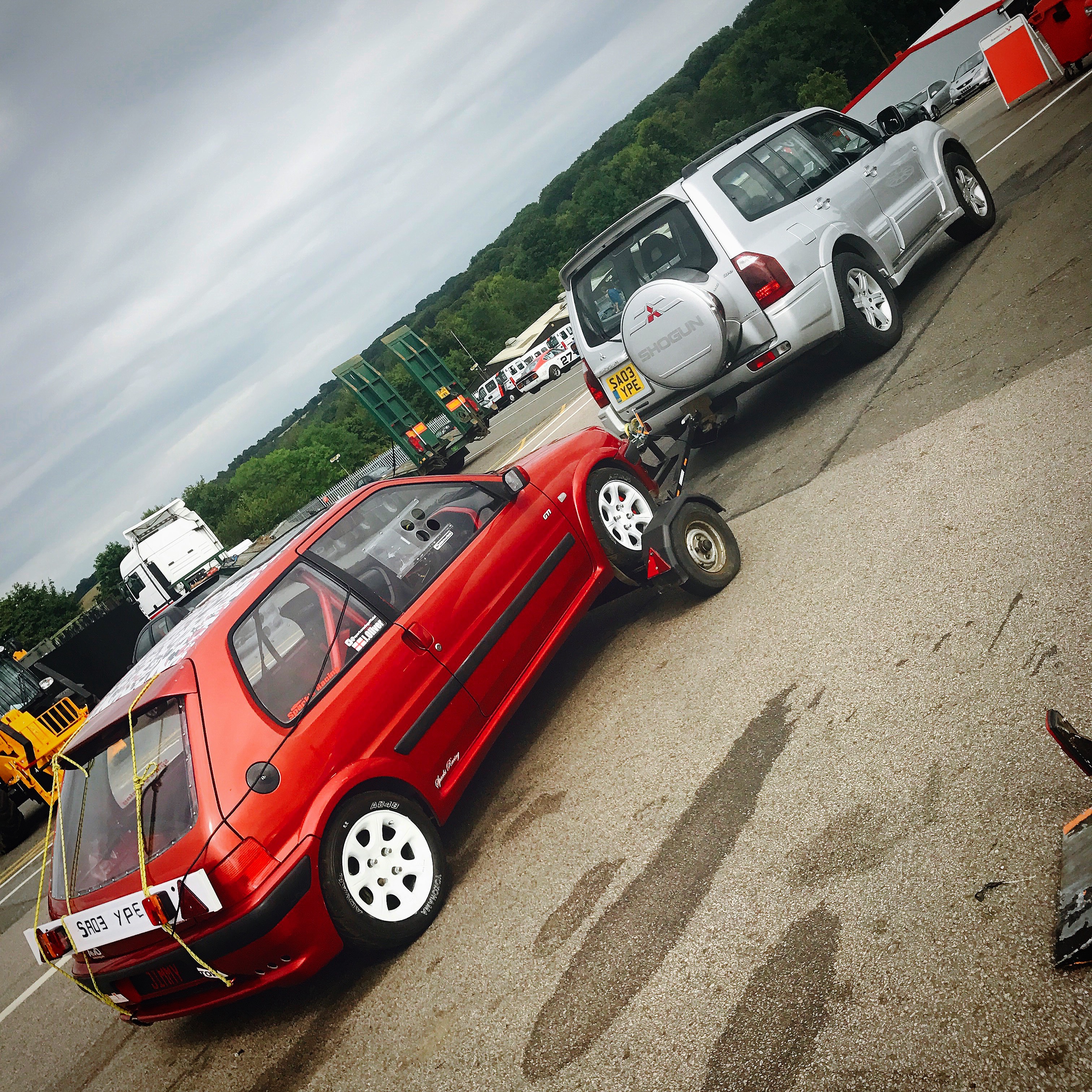

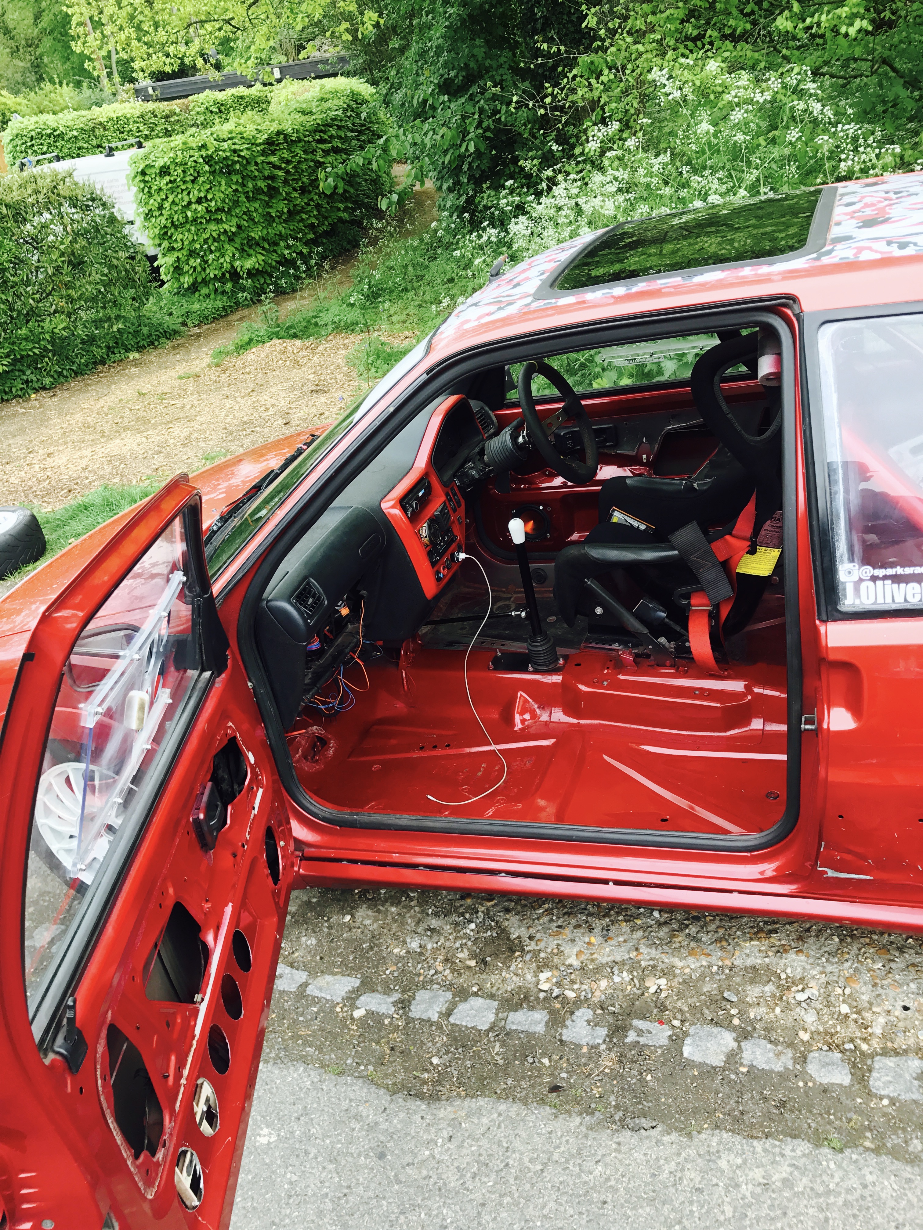

Dudes running a track-day spec. 106, moar powah and gutted to save weight.
Personally I think he should shoot for 180 BHP on ITB's, 130 BHP is horribly close to standard.
That is future plans. The entire car is track ready spec as you say, the engine was fully rebuilt this year due to piston ring failure so the plan is now to work on the engine, everything else has been upgraded! GAZ GOLDs, 266mm 206 GTi brake setup, braided lines fully polybushed etc you name it I've done it lol. Couple photos for those who care!

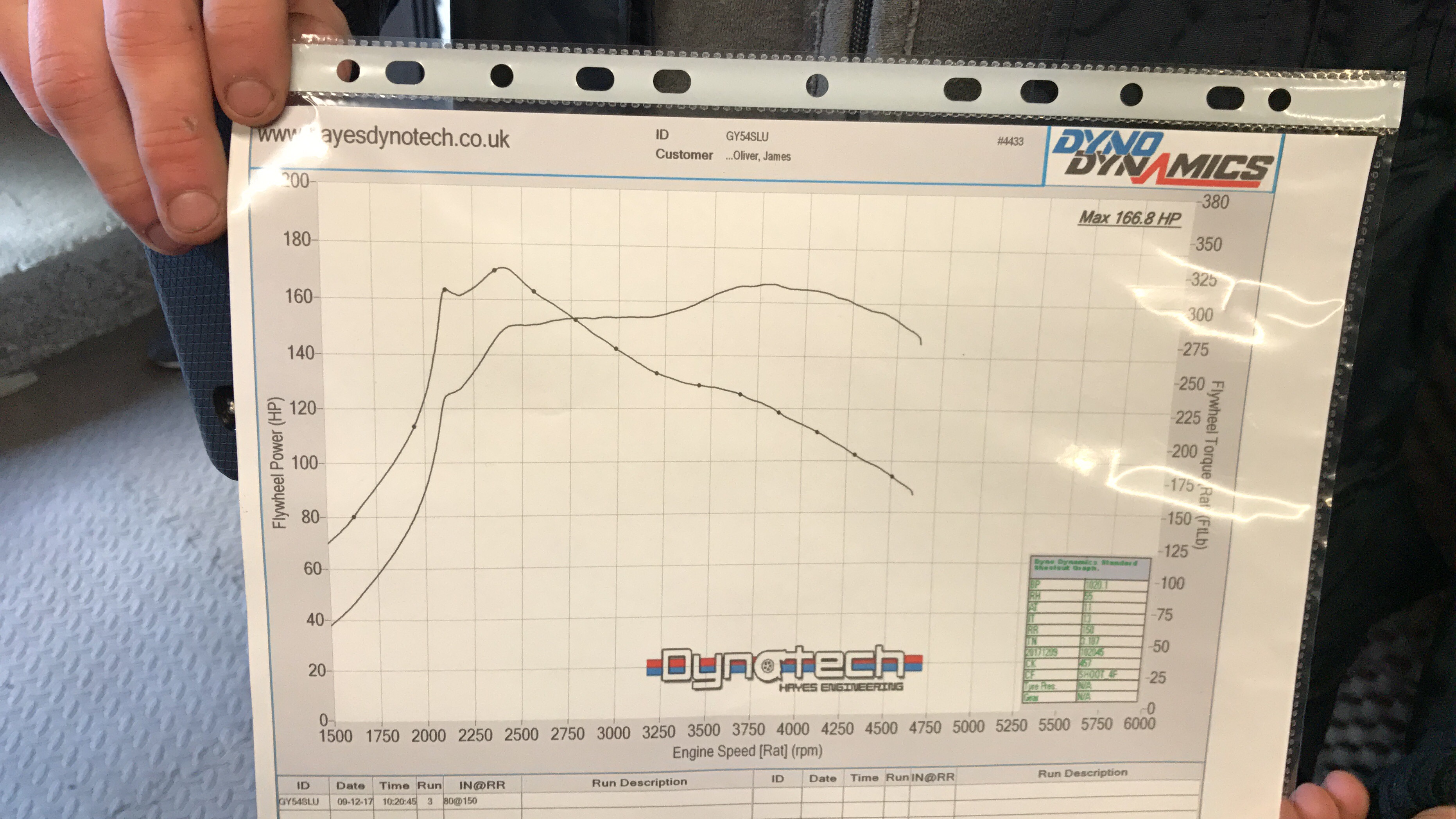

I'm not 100% sure if it has boost leaks or not don't quote me on that. May just be a boring map! My boost gauge seems to spike at about 32psi then hold at around 25/26psi roughly maybe a tad more.
Seems silly that the BHP and torque figure of the fabia are far superior to the 106, they was about even til around 70/80mph then the 106 pulled past like the fabia was going out of fashion, slight uphill too you would think the torque of the fabia would keep it upfront

Even so those boost figures look pants, are they MAP figures or boost figures, they seem to be neither, they're either too high or too low depending.
Probably down to the boost garage TBH!! Not the best in the world lol, it's connected to the EGR delete, think it spikes around 30/35 and settles more along line of 27 but I will check and report back, ill post my dyno graph too may have many of boost leaks (more than likely it's a fabia) and see what you make of it.
Oh yes 100% the 106 doesn't make its power to later in the rev range however I wasn't driving the fabia I was driving the 106 and my friend was driving my car, however we was virtually neck on neck and then around 80mph the 106 pulled past like the fabia come on the brakes!
Looking At the graph the torque drops off real quick however the power looks like it picks up again, I haven't seen any other graphs for these cars but to me the map looks awful with the graph

Sorry but 166bhp with 325lb ft, is that a stage one just a remap because that torque is rather high, looking at the graph it hits around 300 then dips and spikes to 325, I've mapped a lot of PD's in various guises, Passats, Golfs, Ibizas, Seats etc and I have never seen 325lb ft, BHP wise they range form 165-180 and torque from 270 to max 300, who did the map?
Also the torque drops rather quickly.

Yes it’s just a Stage 1 map. Was a map from a garage local to me called Boost Factory. The fella done it in there.
The torque dropping wuickly probably explains why it feels it feels so slow lol
