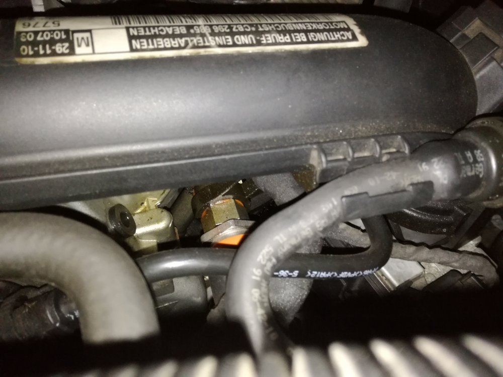

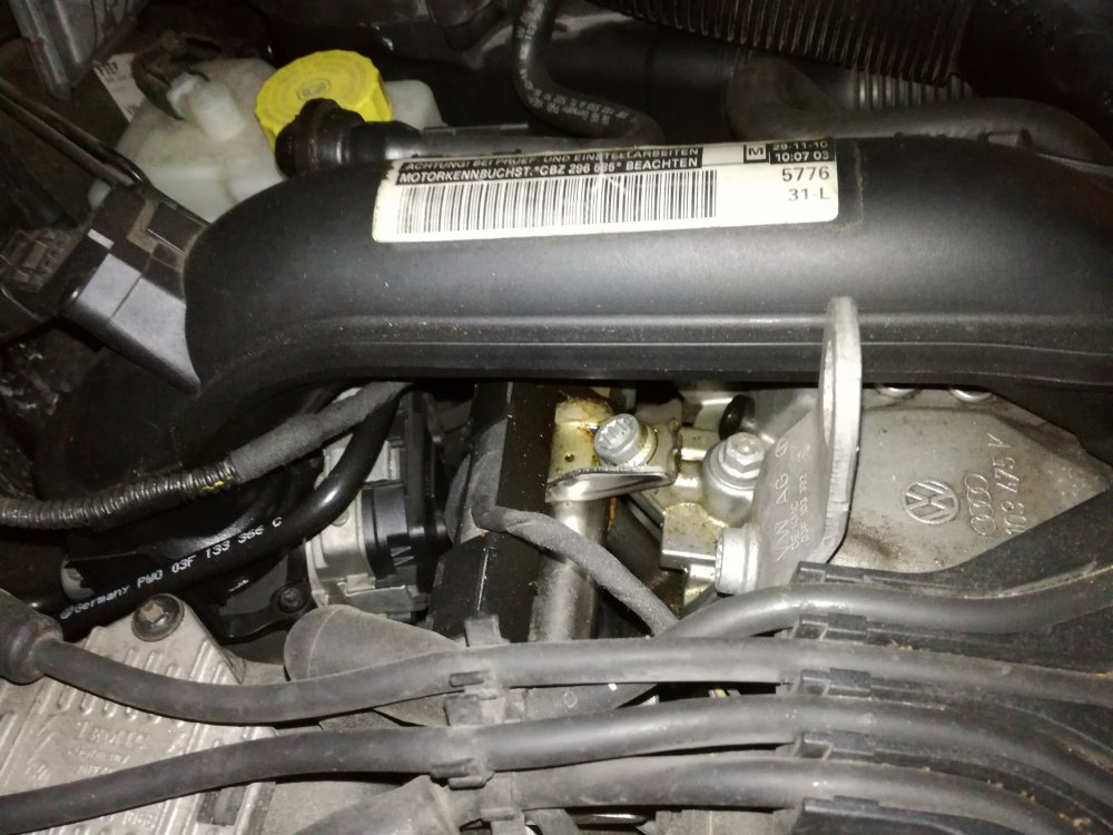

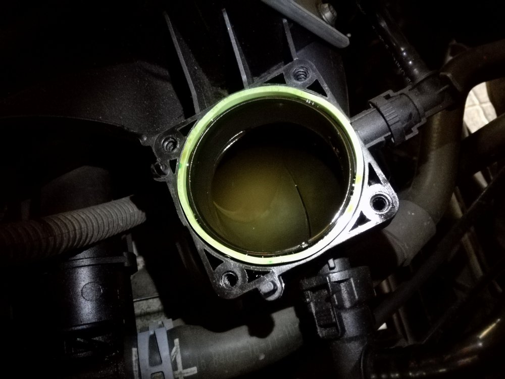

My car suffers from lots of blow by, my charge pipe that leads to the throttle body is filled with oil and the charge pipe too, it was all cleaned a few months ago and so was the engine below it, but is "dripping" again onto the engine.
Left side of pressure pipe.
Right side.

The PCV valve is missing!
It plugs into that small black rubber grommet in the cam cover. Item 21 here
http://www.oemepc.com/skoda/part_single/catalog/sk/markt/CZ/modell/FAB/year/2013/drive_standart/697/hg_ug/103/subcategory/103042/part_id/2541369/lang/e
Without it fitted oil mist blows out the grommet as per your picture!
The end of the PCV valve that plugs into the grommet often breaks off, the valve will be hanging off the rubber hose that connects to the airbox. IMPORTANT! If the end of the PCV valve has broken off, (its about 10-15mm long), use tweezers or long nose pliers to recover the broken bit lodged in the rubber grommet first. The grommet (item 24) also pulls out of the cam cover easily. This is a very important step as simply pushing in a new pcv valve (or the broken one) will push the broken bit of hard plastic left in the grommet into the head space, and is highly likely to find its way under a cam or follower and hold a valve open until the piston hits it. (Been there done that....) Not good....

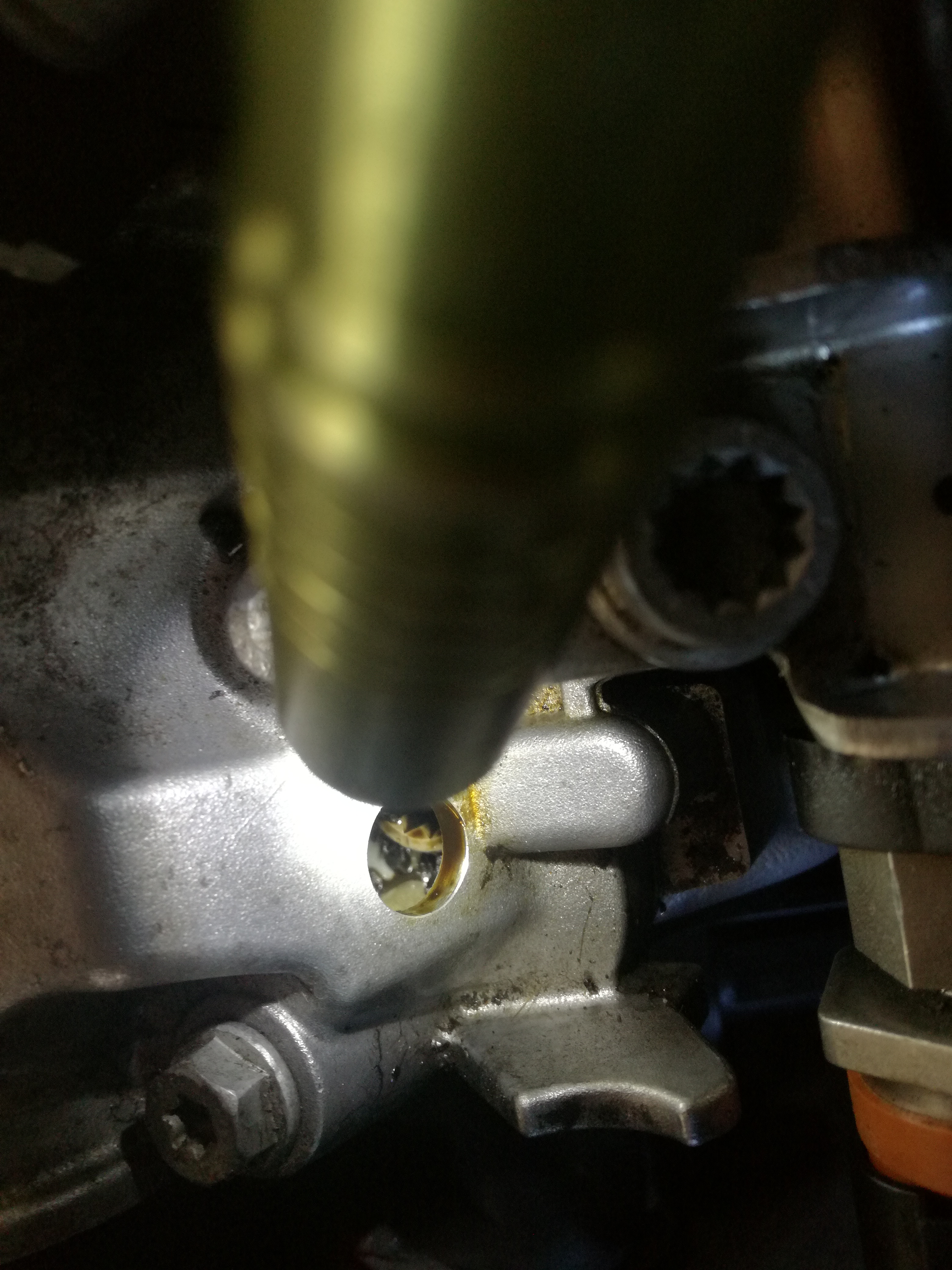

@xman well this is what I'm left with, it was desintegrated, any ideas before I put the new one ?
I've gotten a few pieces out with a tweezers but can't get anymore out.

And i take it that this huge amount of oil where the throttle body connects it's due to the pcv not being connected ?
No idea about the oil in the throttle body.
