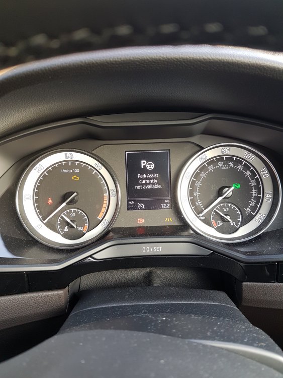

I would like to ask you if somebody used OBDeleven on Skoda Superb, Laurin & Klement mk3 or (SE L with park assist button)
I made mistake , I forgot to backup my log ins and after coding I have some issue with Park assist not working after I press button and not helping to park.(Park Assist currently not available)

Hi can't help you in regards to backups, but if you go into Car -> History, you should see a list of all changes you have made through coding and adaptations. I'd work through that list and revert back the changes. It should show previous setting and new setting.

Hi guys I just want to thank you for your help, this issue is fixed now.
