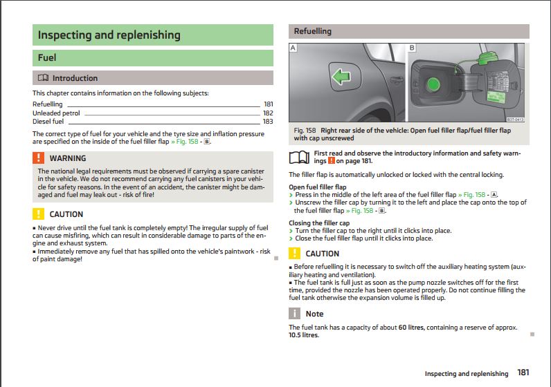

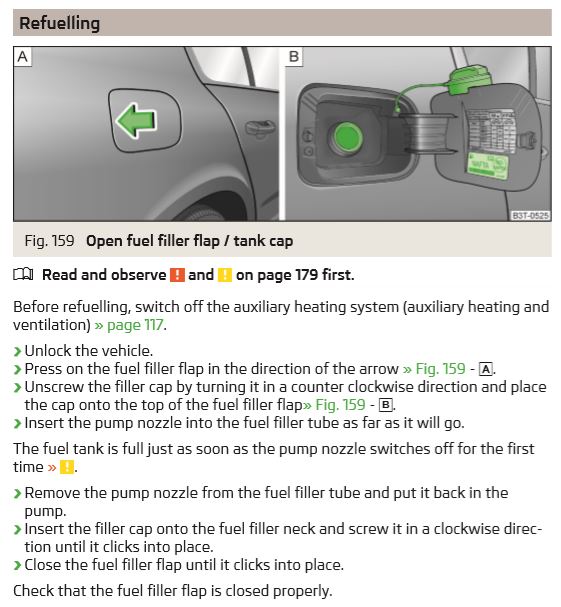

To clarify, I want the filler to open using the central locking button on the door handle, not the key, which I thought would be the norm, like any other car I've owned.
In Manual for a 2012 FROM HERE
"The filler flap is automatically unlocked or locked with the central locking."
