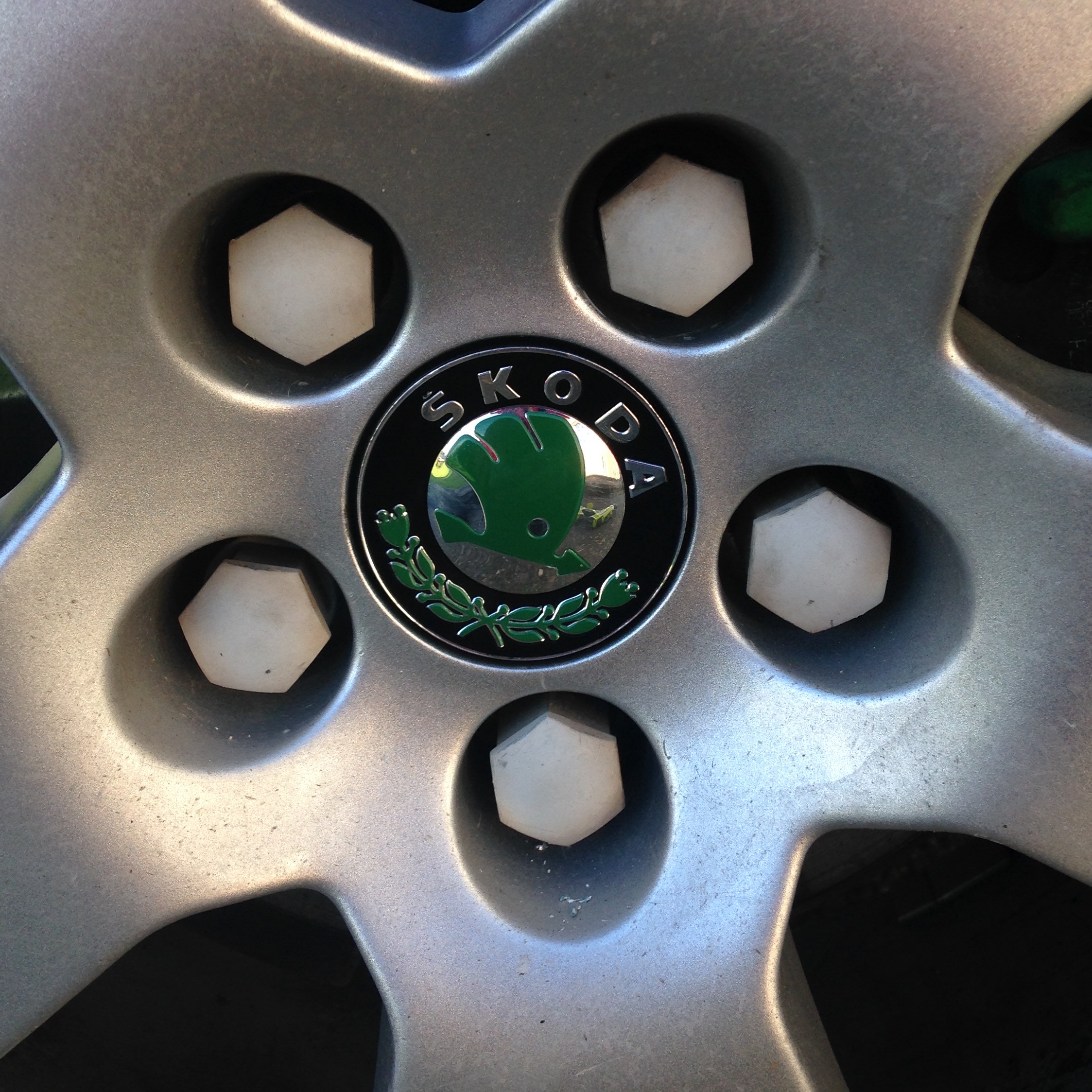

So , Since I've decided to keep this car for the foreseeable future I've decided to tidy up a few inexpensive bits and bobs that have annoyed me since day one.
1. The  Skoda badges front and rear were shocking. One was almost blank and the other one had gone turquoise -
Ordered and due in the next few days.

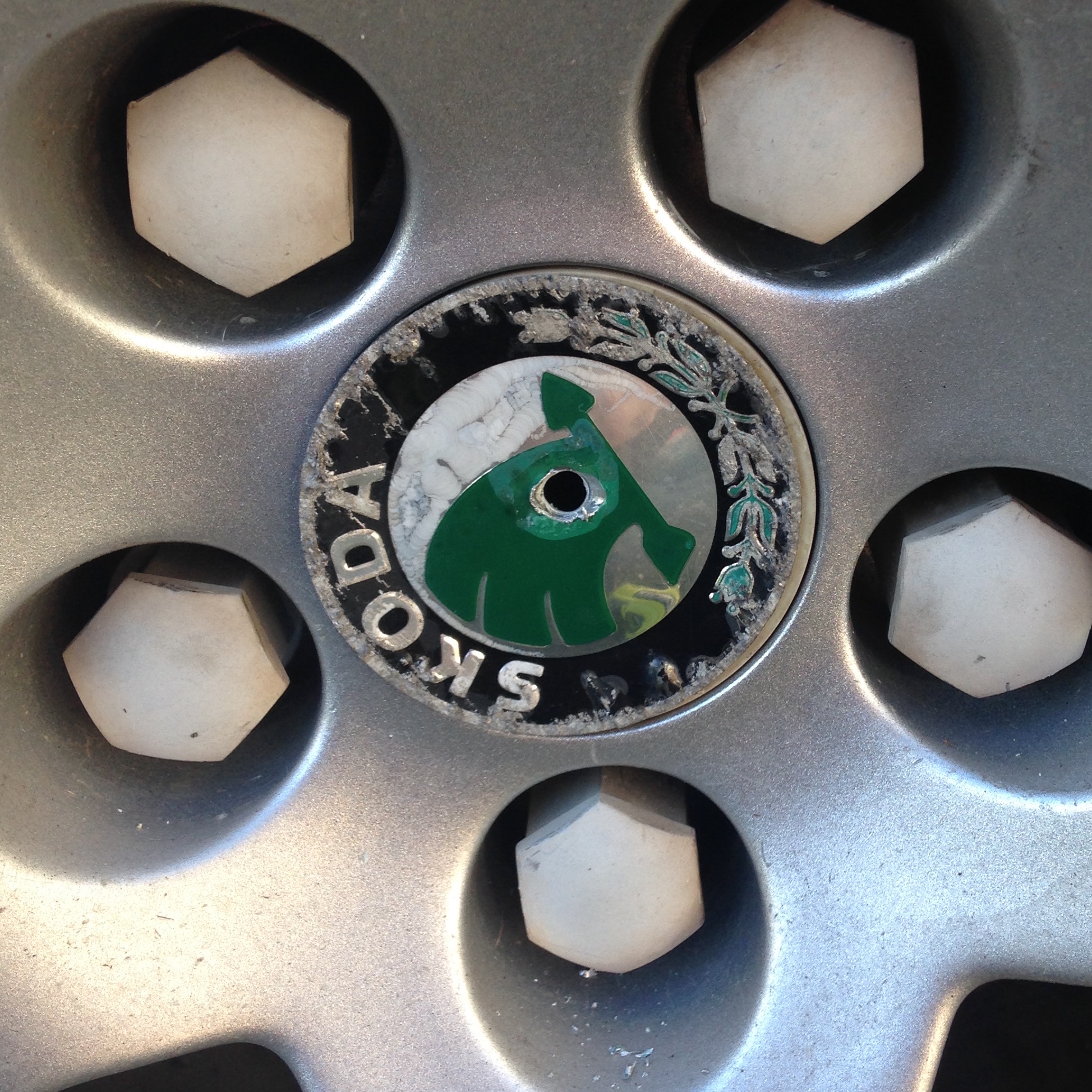

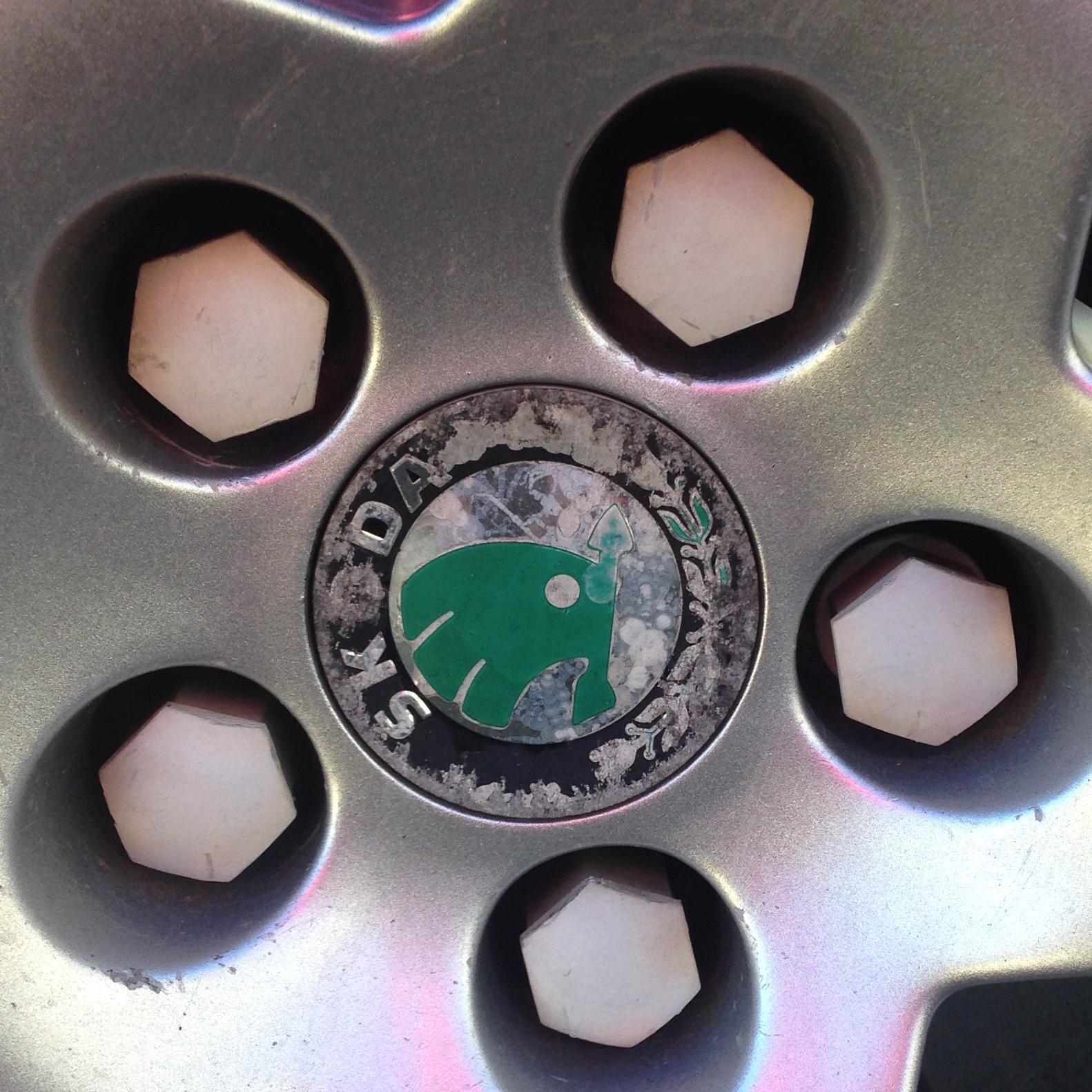

2. Wheel centre caps. Very badly corroded.
These arrived this morning but it's been freezing and wet all day.
The wheels could do with a refurb too but I can't see getting that one past the old bread winner!

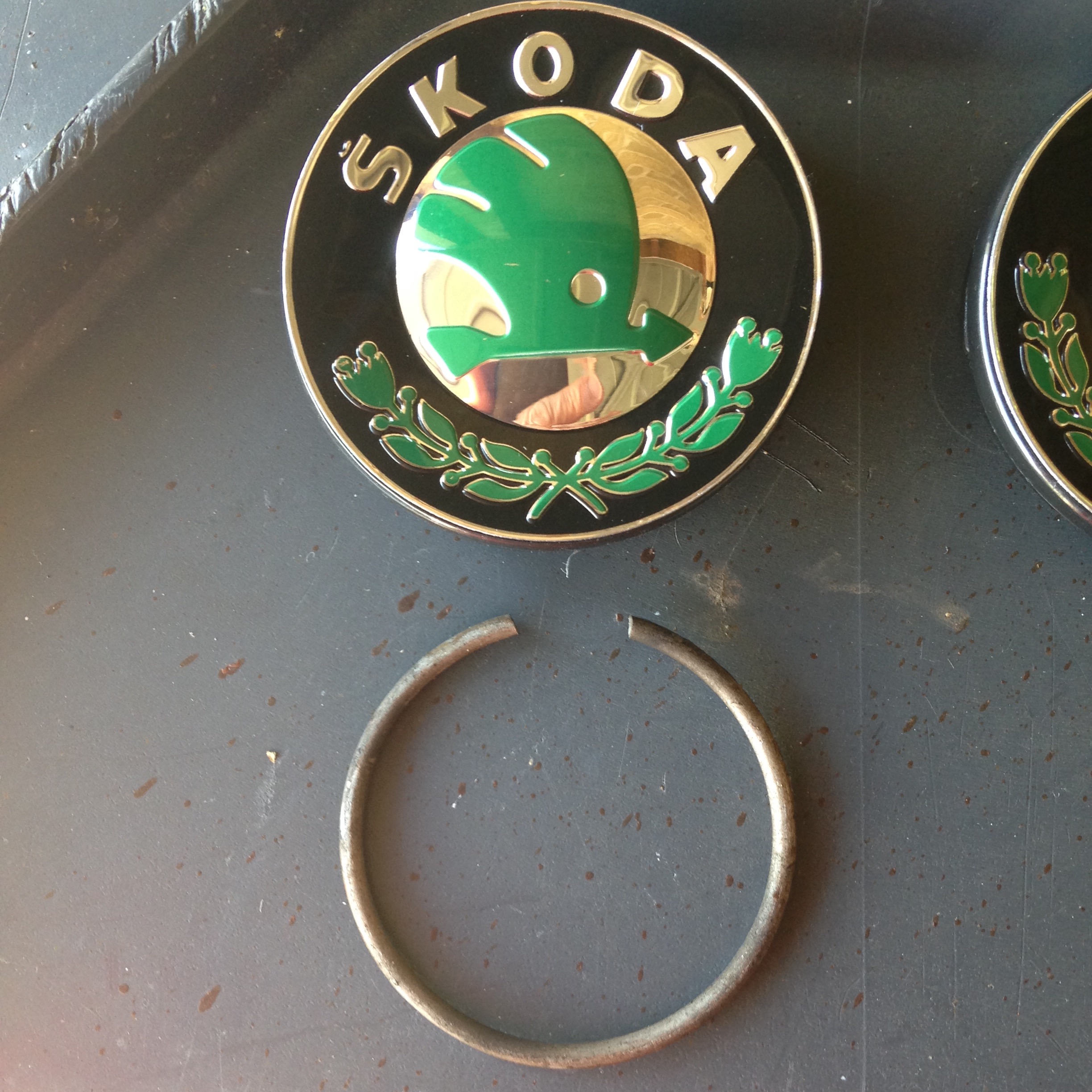

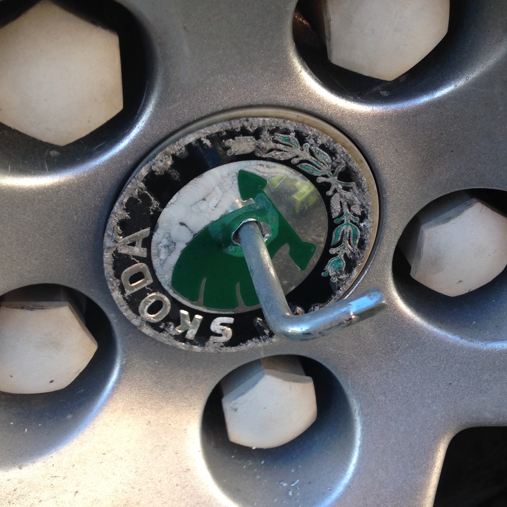

The old centre caps were a real mess.
To save taking the wheels off I just carefully drilled a small hole through each one and used an ikea Allen key as a pulling tool.
Once off , I noticed the old caps have a metal retaining ring inside so this was swapped onto the new caps.
A simple click and 10 minutes later all 4 are done.
I now need new wheel bolt covers!

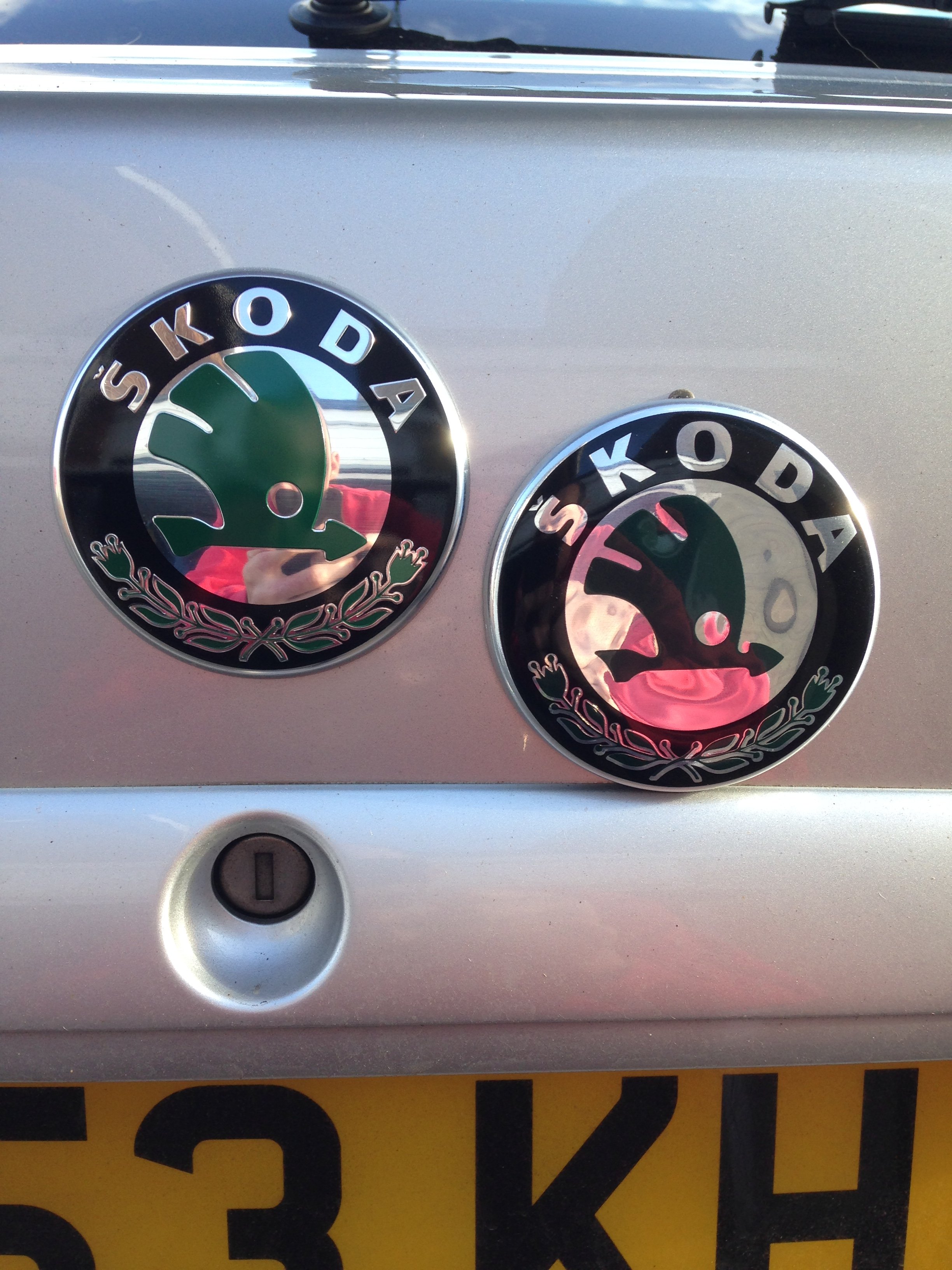

New badges arrived and fitted today.
There are no pics of the old ones as I took them off in mid December anticipating the arrival of the new ones I'd ordered off Amazon.
When they'd not turned up by last week I got a refund and ordered some of eBay after the dealer quoted £18.67 each!
So , the eBay ones arrived yesterday and went on this morning. Perfect.
1 hour later one of the Amazon ones has turned up and is garbage.
The green is very dark, the "chrome" is like brushed steel, it's all dented and bowed.
If i'd not got a refund I'd be a bit annoyed to say the least.
I'll give it to my oldest to stick on his wardrobe.
You can't really see how bad the Chinese Amazon one is in the pic below but trust me , it's cack.
