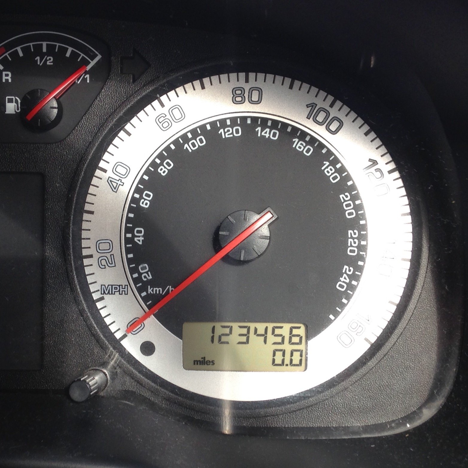

cambelt and water pump number 4 fitted today.
The car ticked over to 123000 miles on the drive home aswell.

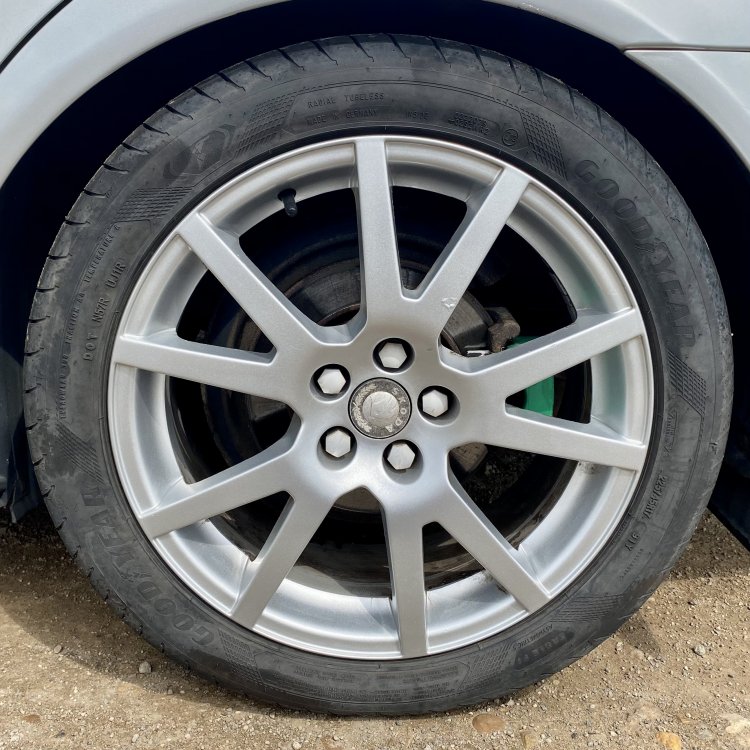

My MOT in May (passed) signalled it was tyre time.
Luckily I had a full set of Goodyear F1 Asymmetric 5 sat in the garage that I bought at the end of last year on offer somewhere, Mytyres I think.
The Avons ZV7's have done a decent job, no complaints at 18000 miles.
There was still a bit of meat on the fronts ( swapped back to front in January) but one gained a slow puncture in the last few weeks so I thought I may aswell get them swapped.
Obviously I can't report any big difference yet as I've covered 6 miles but the reviews are good so we'll see.
It also means the 17 year old bald continental spare in the boot has gone. The idea of ever having to use that didn't fill me with confidence.
So, having now put a few miles on the new tyres I can report they are certainly an improvement over the Avons, not that they were ever bad.
In the dry they just inspire a little more confidence but in the wet they're a big improvement with more of a feeling that they're providing much better grip on corners.
It may be down to to tread depth  but I certainly feel happier.

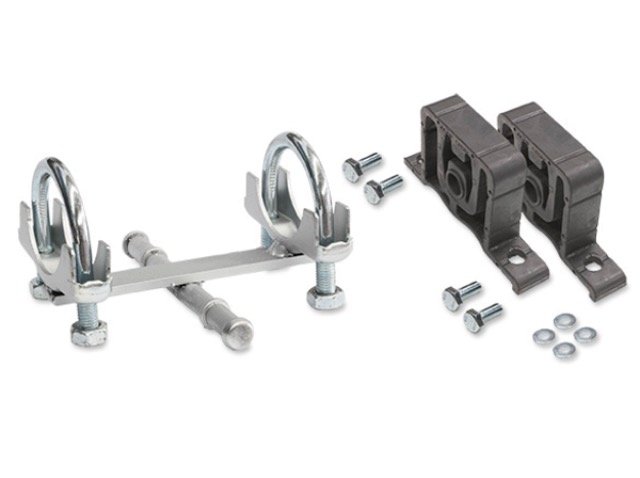

I finally got round to getting an hks exhaust repair bracket fitted to the centre pipe.
It had been welded previously but broke again last year.
Supplied and fitted for £40 at my local and excellent Dexel.
Considering it would have cost me £38 just for the part + postage I'm pretty happy.
It's a hefty bit of kit and looks like it probably provides more support than the original bracket set up.
More peace of mind.

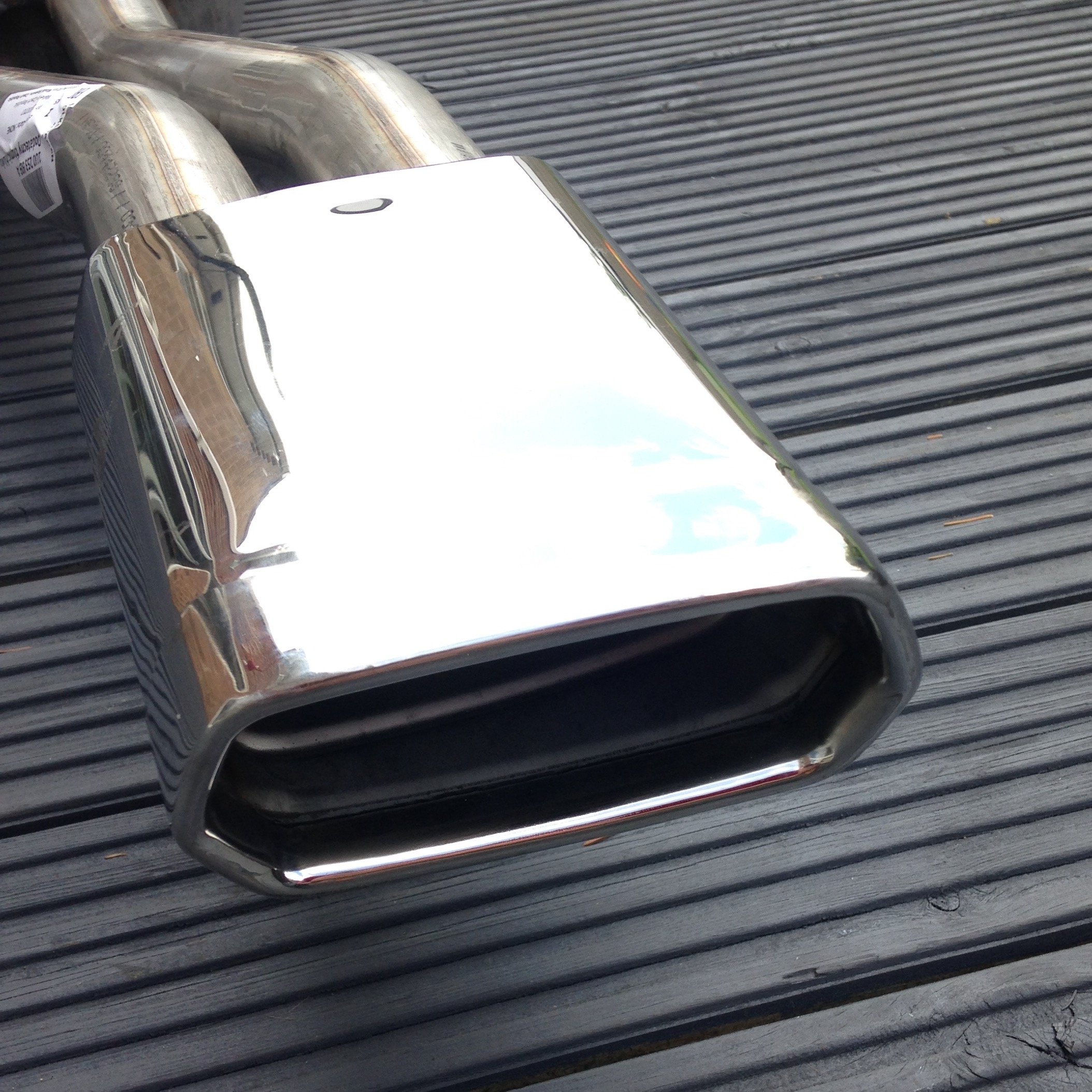

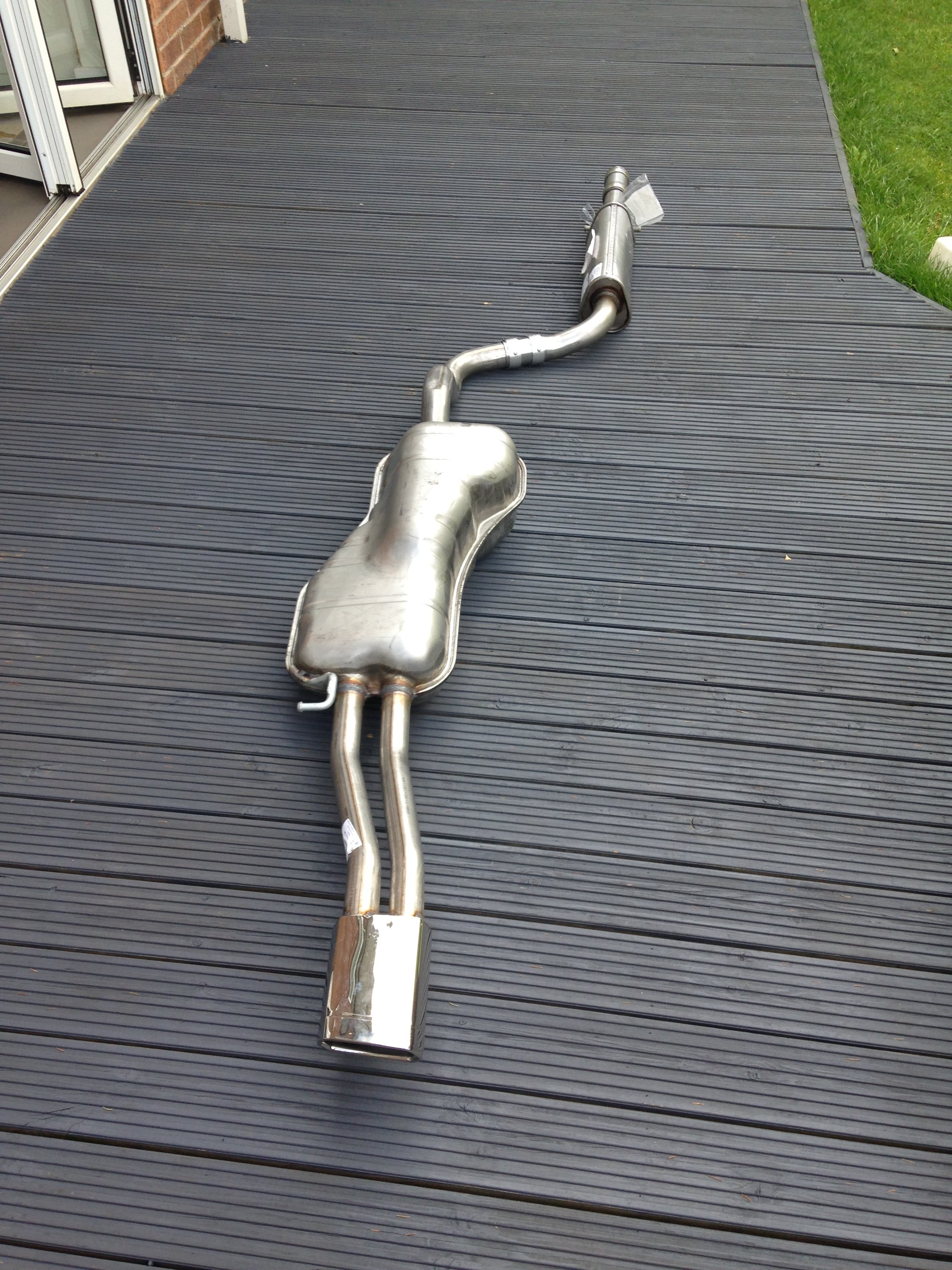

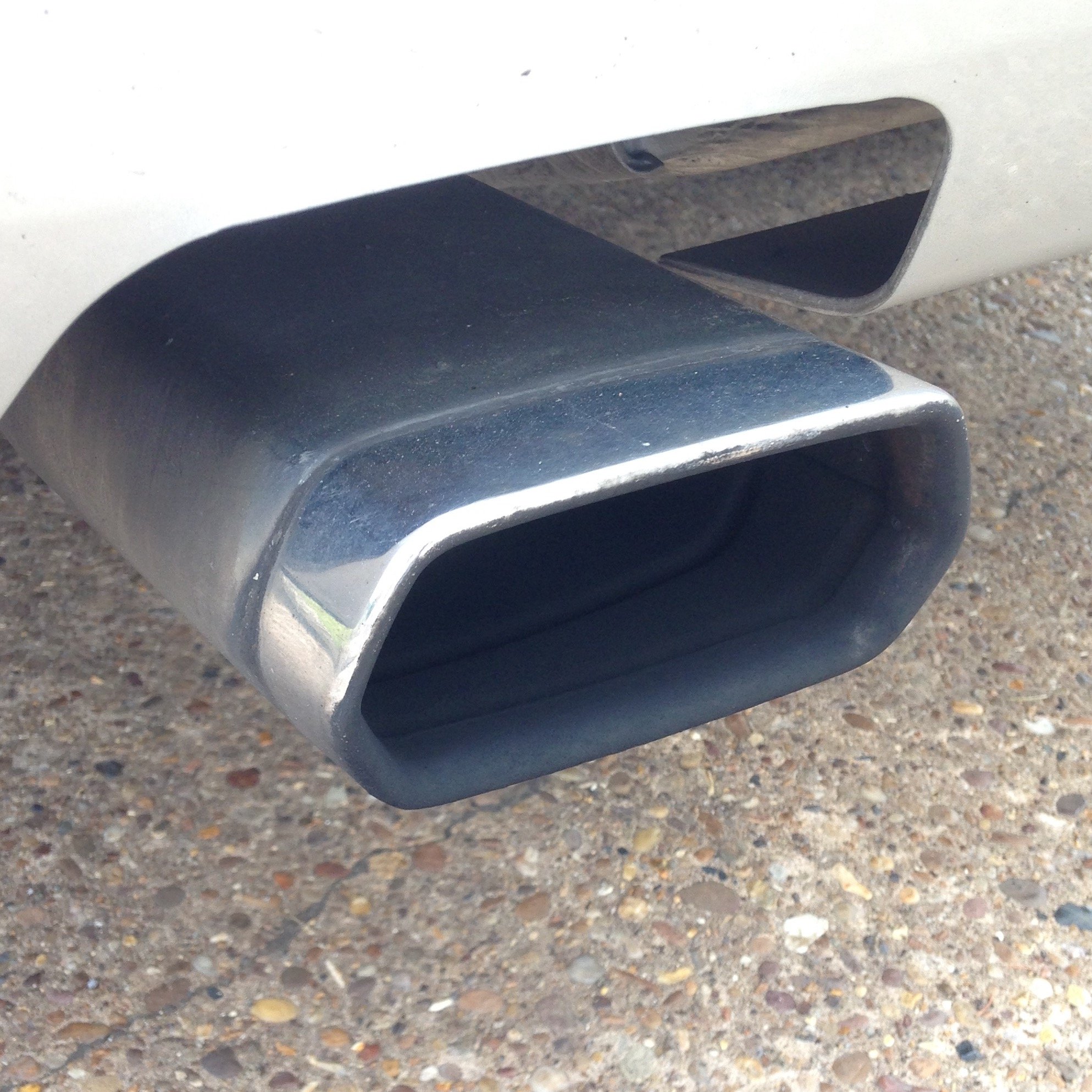

Went to collect my new exhaust today.
All good it seems.
All the part numbers match ETKA.
There were a few scratches on the tailpipe but they polished out fine.
Taking it to be fitted Wednesday.
just for information in case of people searching in future I'll list the part numbers below.
Rear silencer - 1U0 253 609A
centre silencer - 1J0 253 209Q
clamp - 1K0 253 141M
clamp - 357 253 141A
Edited by sheb

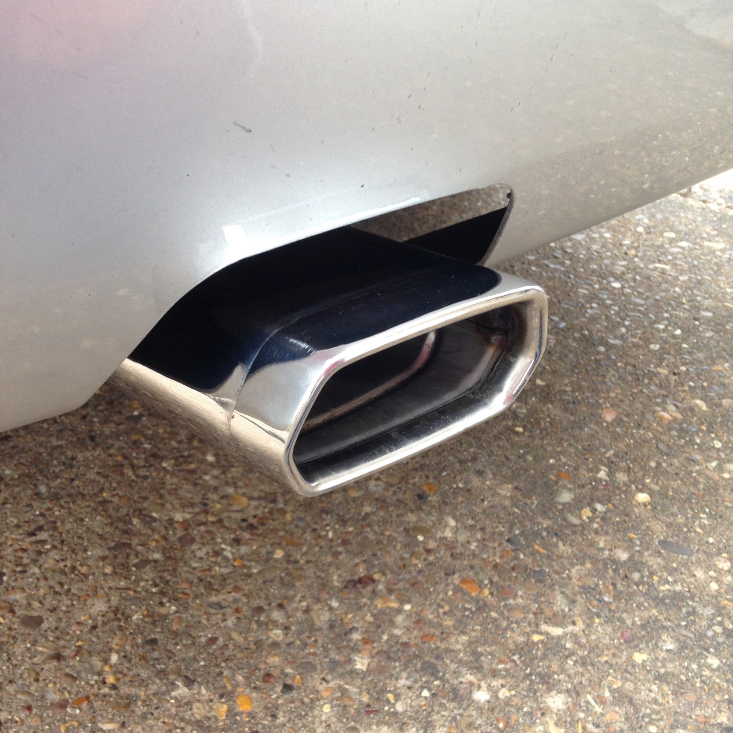

Shiny.
all fitted up ok but apparently was an absolute ****** to get the old one off.

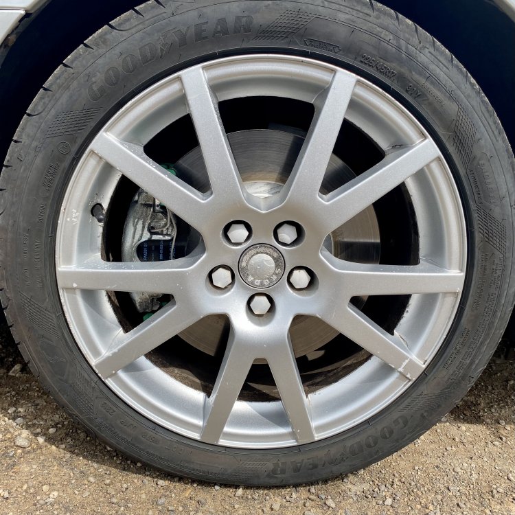

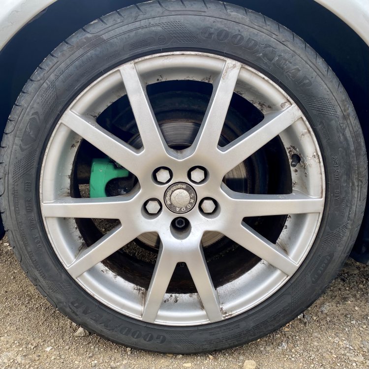

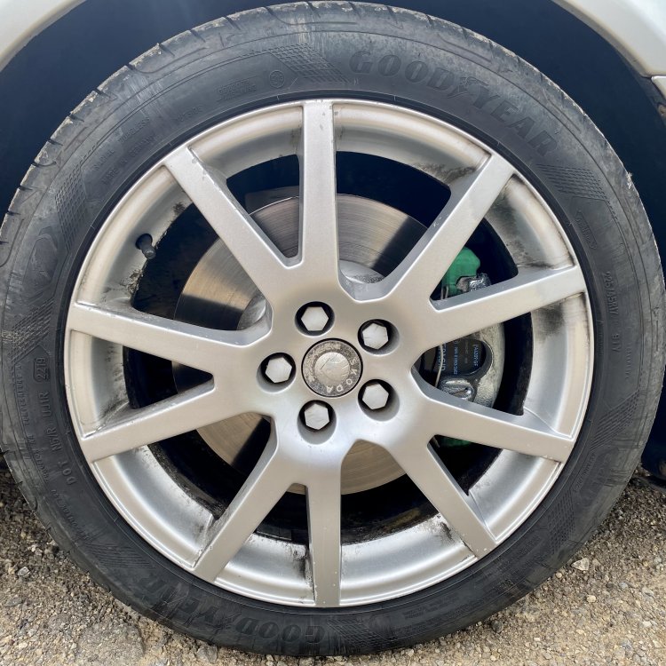

Out of laziness and convenience I've always taken our cars to the hand wash place but we just got a nearly new black car for my other half ( i30 N line 1.4 t-gdi ) so I decided to start cleaning them myself to avoid the otherwise inevitable swirl marks.
There's been a plus and minus to this as far as my car is concerned.
It's never been so clean.
I even clayed and waxed it today.
However, I'm now aware of the state of the paint and wheels.
Don't get me wrong, it's not bad for a 17 year old but it's a bit depressing discovering all those blemishes you never noticed and now have to worry about.
still, scrubs up ok from 10ft.

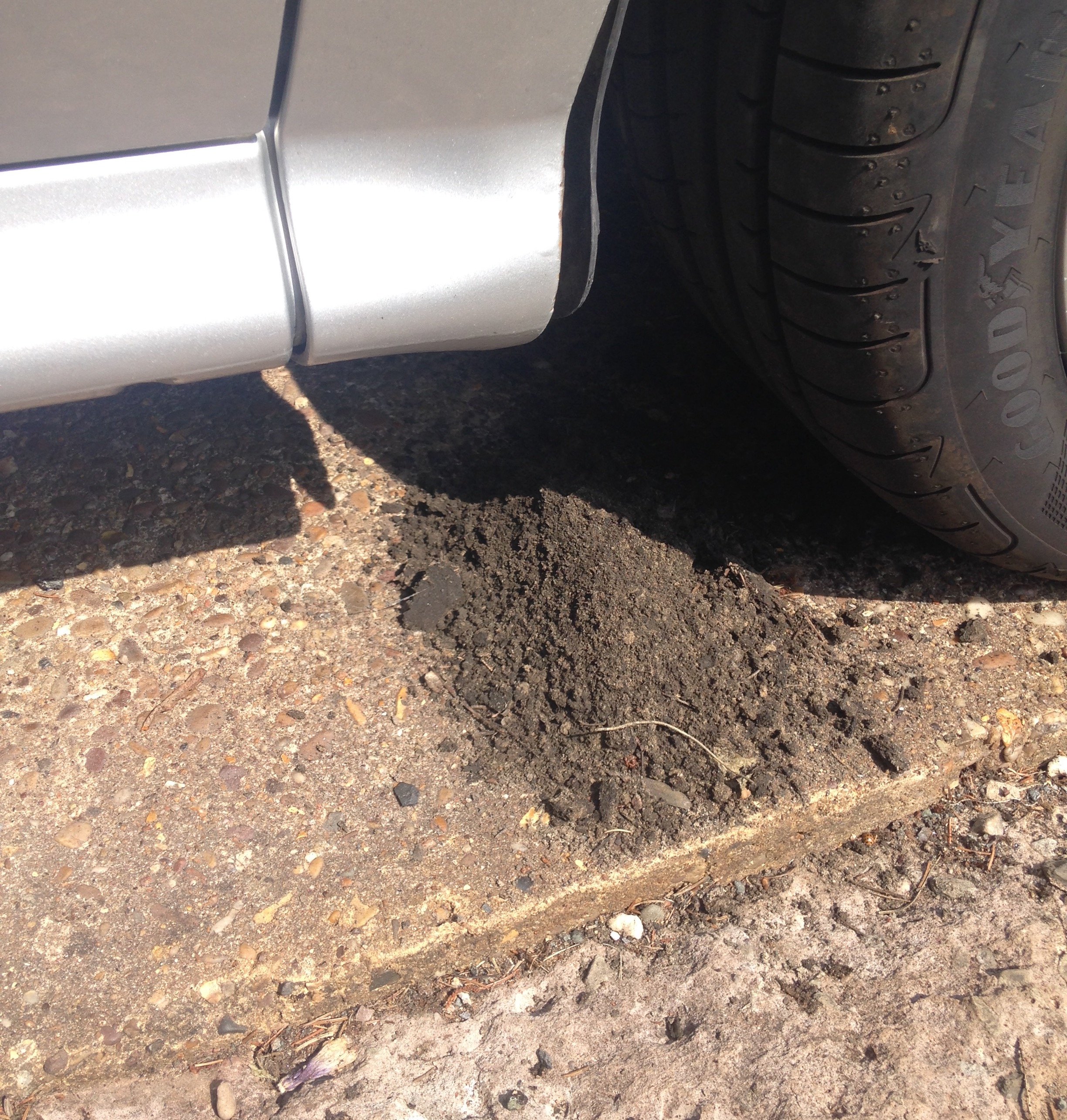

Quite the little mud trap you designed there skoda. Well done.
500g per side if you're interested.
Once well cleaned out there was no evidence of rust but I gave the area behind the flap/mud door a good coat of wax oil anyway.
I did the same job and was surprised as to how much muck had managed to bet behind the plastic.

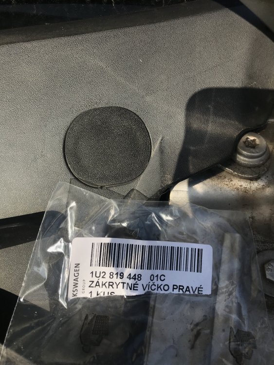

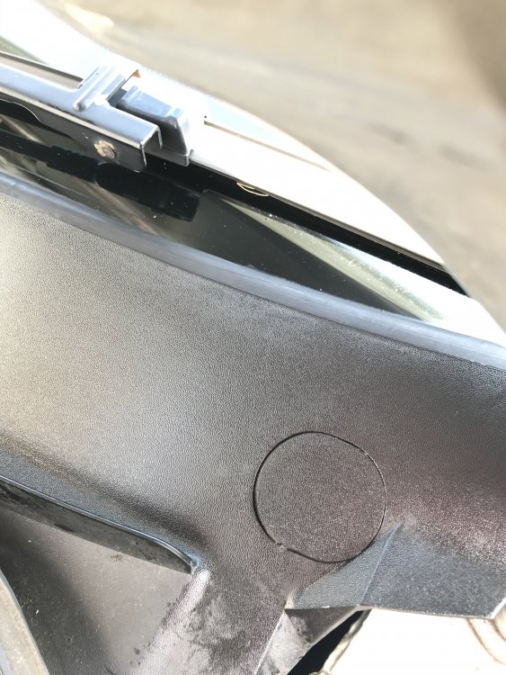

I’ve been missing one of the plastic grommet things from my scuttle panel for I don’t know how long so decided to finally rectify that.
It looked a bit odd at first but a coat of meguires black plastic stuff and it’s all good.
