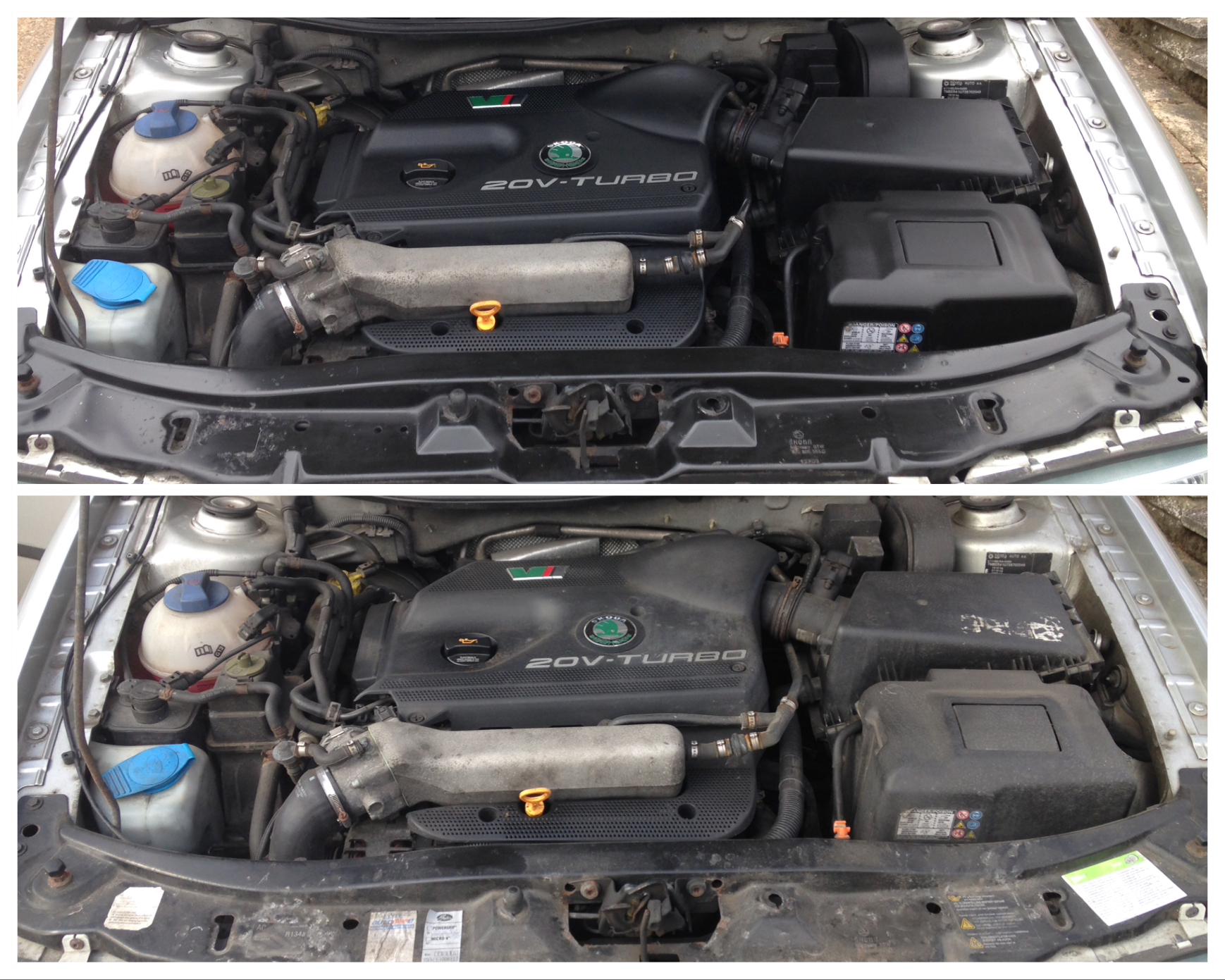

Since the sun was shining and it's  warm for the first time in what seems like about 5 years I decided to give the engine bay a quick clean. Nothing special, I'm no detailer!
The slam panel had loads of cambelt stickers etc cluttering it up so I removed them as I have documentation anyway.
Much neater.

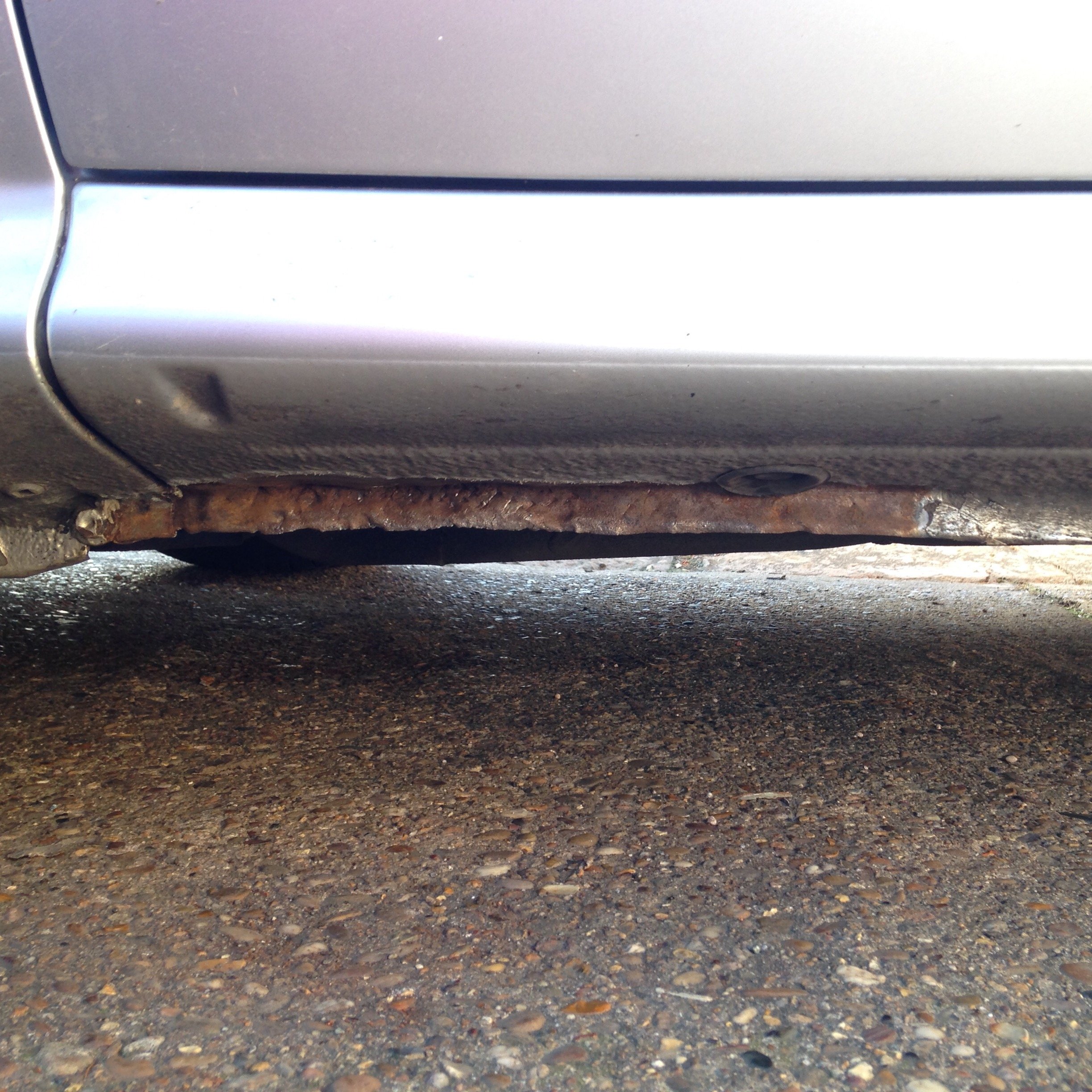

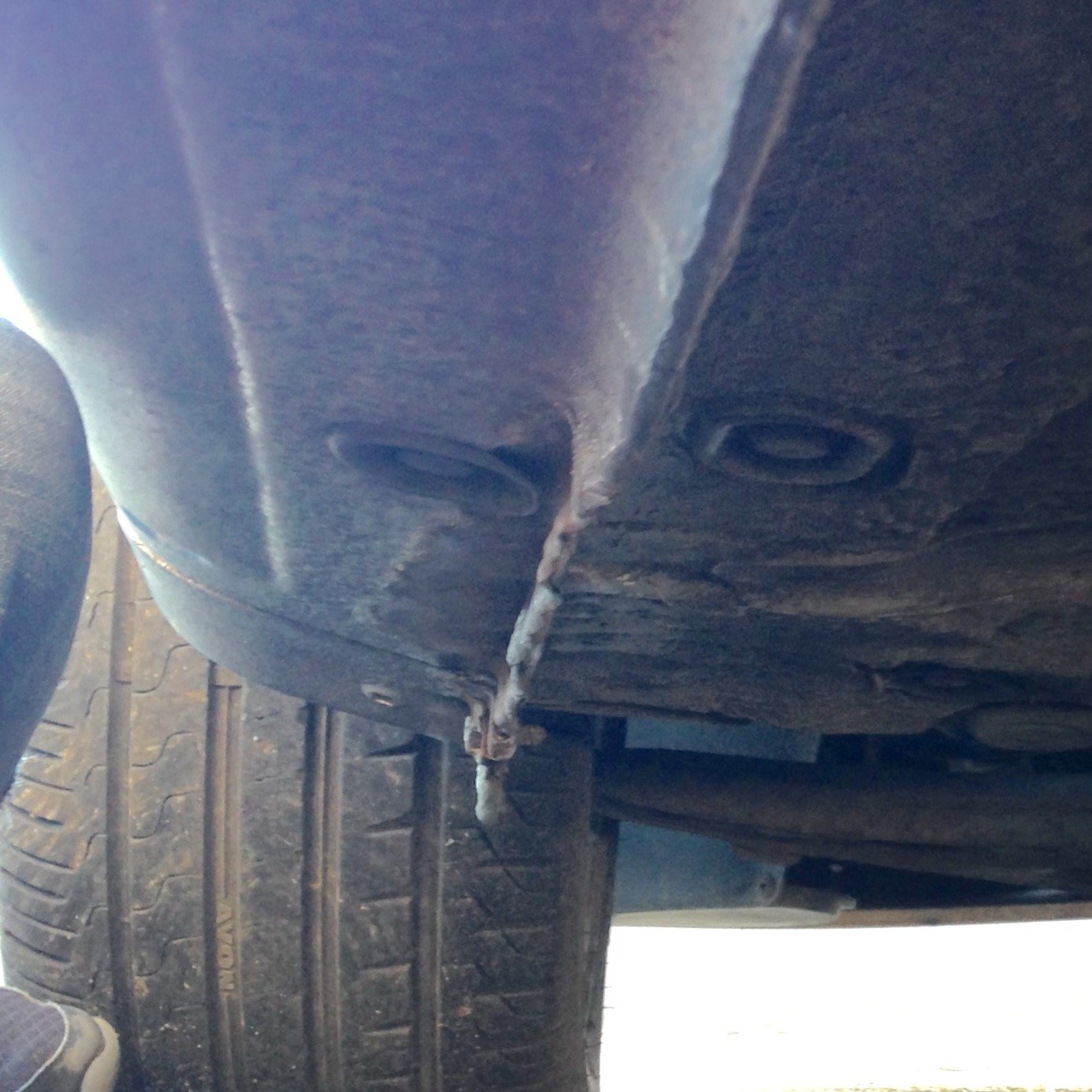

Next. Crushed sill lips.
I've only made a start straightening them out for now as I wanted to investigate what I'm going to have to deal with invade a trip to the welder was required.
Not quite as bad as expected. They're flat  over about 30cm and there is some rust but they still seem pretty solid.
This became apparent due to the effort required to get them back in shape. Jesus!
I've only lost two knuckles.
The plan is de-ox gel , rust proof stone chip spray, under seal beneath the car.
Any other suggestions are welcome as I've not done any body stuff for years.
Edited by sheb

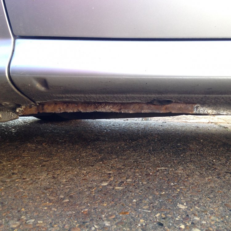

Just a couple of pics to show how the sills are coming along.
The whole area was squashed flat but as you can see the metal is still good and thick.
I've cut away all the loose stonechip stuff as it was just a water trap.
I'm pretty pleased with how it's turned out so far.
good job with the sills.... mine are squashed on both sides,  surface rust has always been there, but never got worse in three years, and never mentioned on the mot .... may leave them until they need cutting out and replacing! lol..
Yeah, mine have been like that since I bought it but you couldn't really tell as the stonechip stuff had peeled off but stayed hung down if you know what I mean?
They were never mentioned on an mot until last year so I thought I'd have a look. It wasn't that bad. Just bent and surface rust.

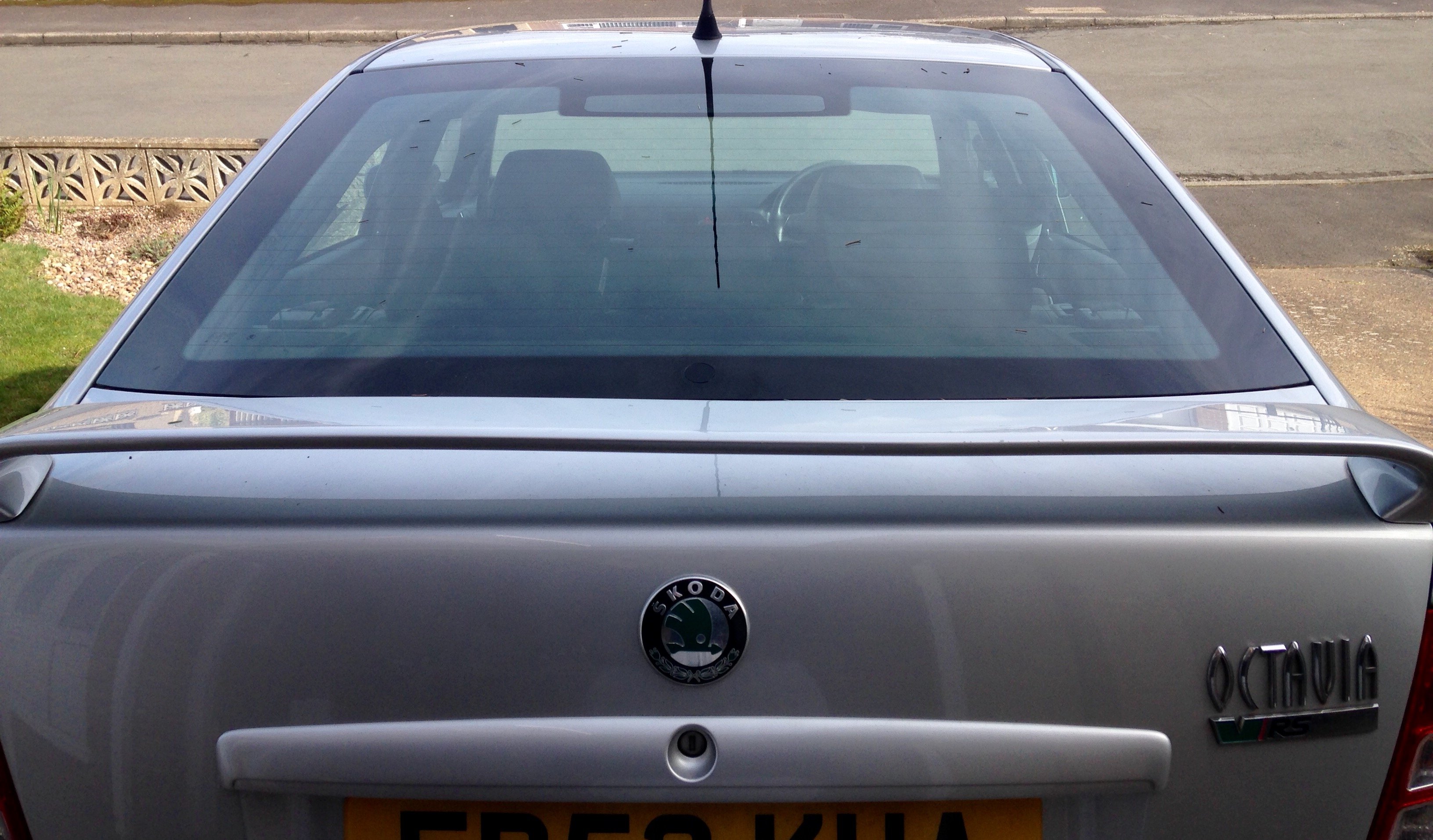

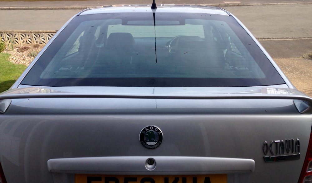

Rear wiper delete.
After almost 5 years of ownership and 3 failed motors I decided to just get rid.
The rear wiper always annoyed me anyway as the cap bit was missing.
I think it looks much smarter.
I estimate that with the weight loss and reduced drag it has to be worth the equivalent of at least 60 bhp!

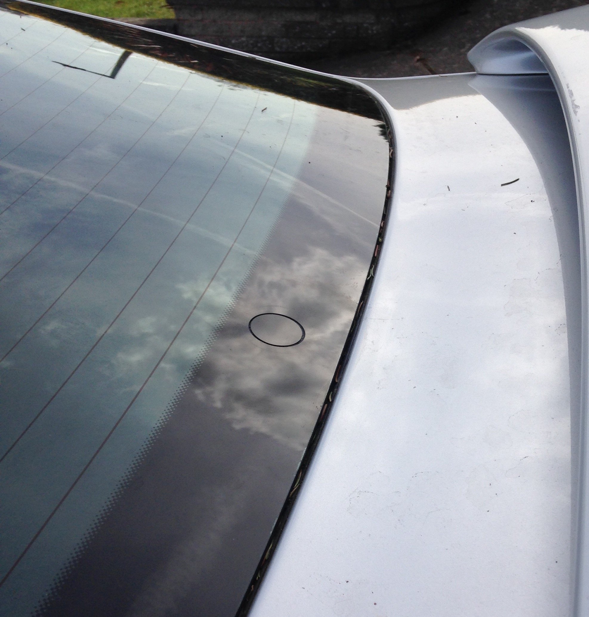

The windscreen chip (3mm outside zone A) that was an issue last year is ok this year but the rear brake backplates (light surface rust) and slight fraying on seat belts are new to the list even tho they're obviously not recent wear.
Oh well,  a pass is a pass.

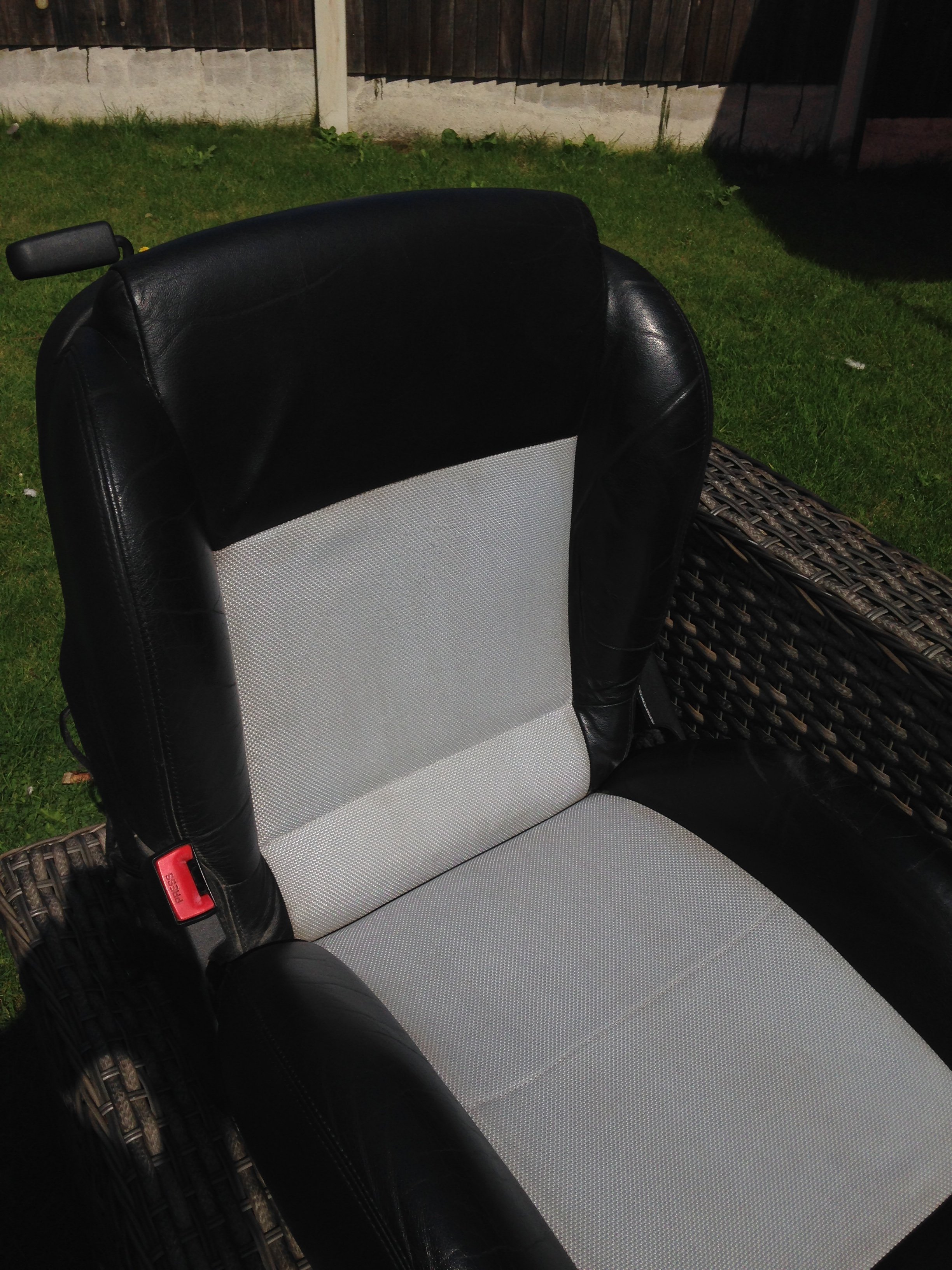

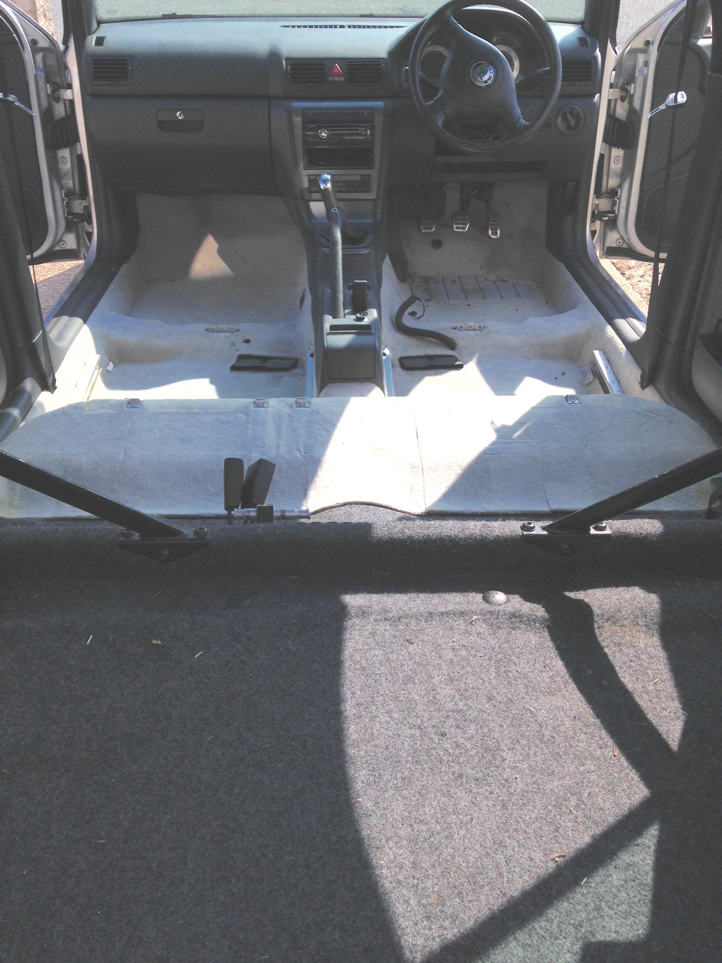

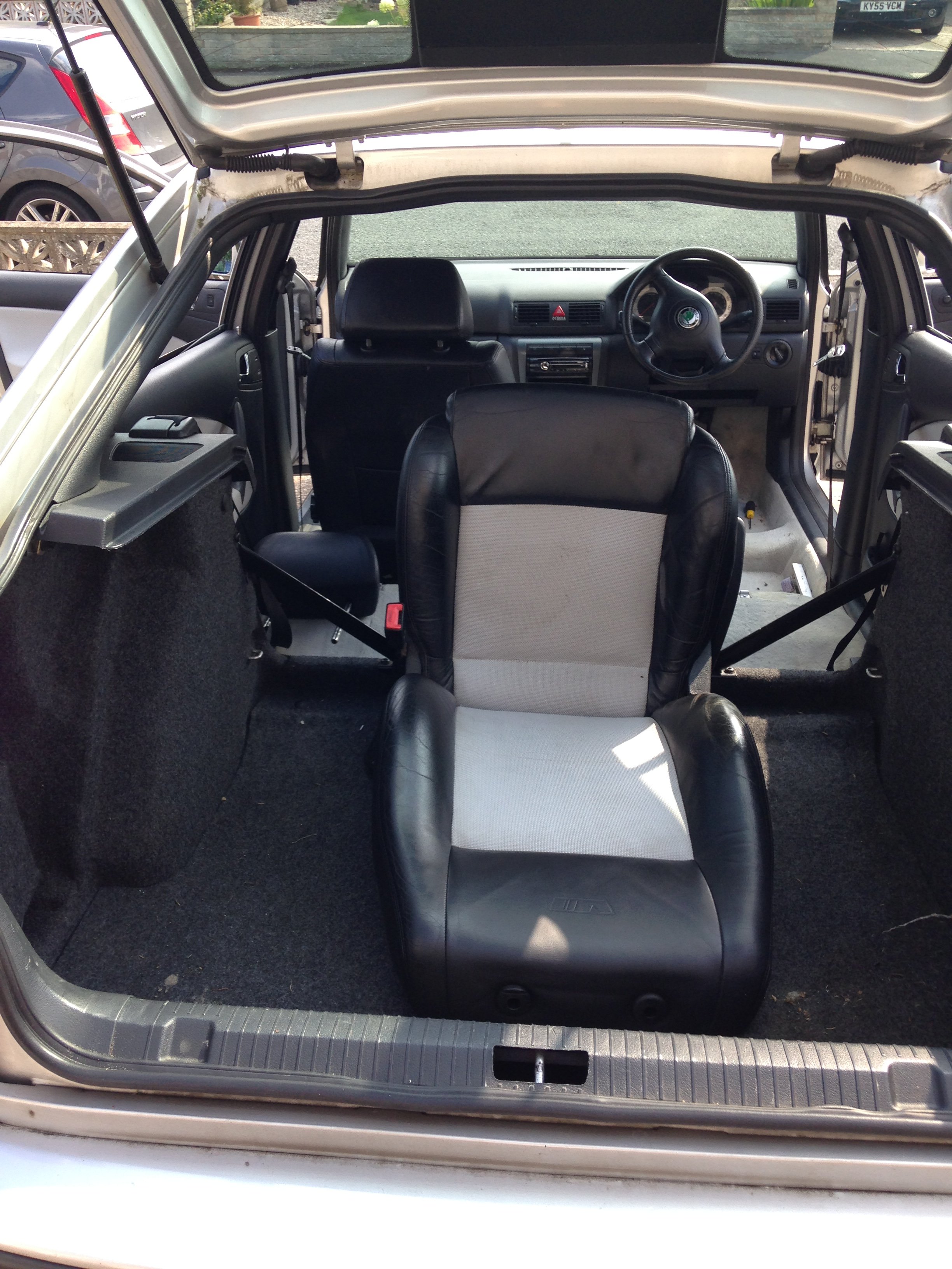

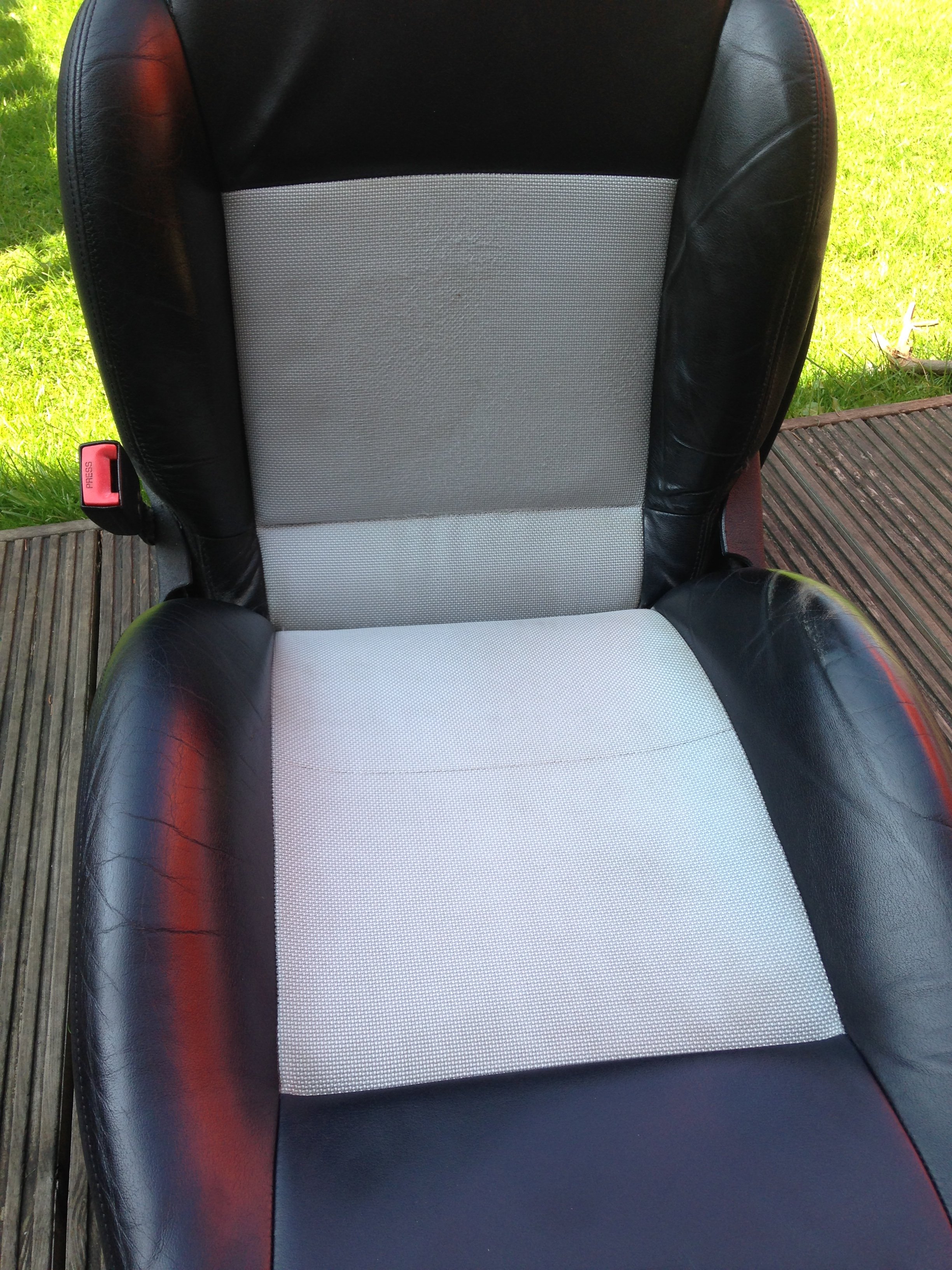

I took the seats out.
its so much easier wet vaccing with no seats in and getting them out is a doddle.
The rears basically pop out once you push the retaining hook back.

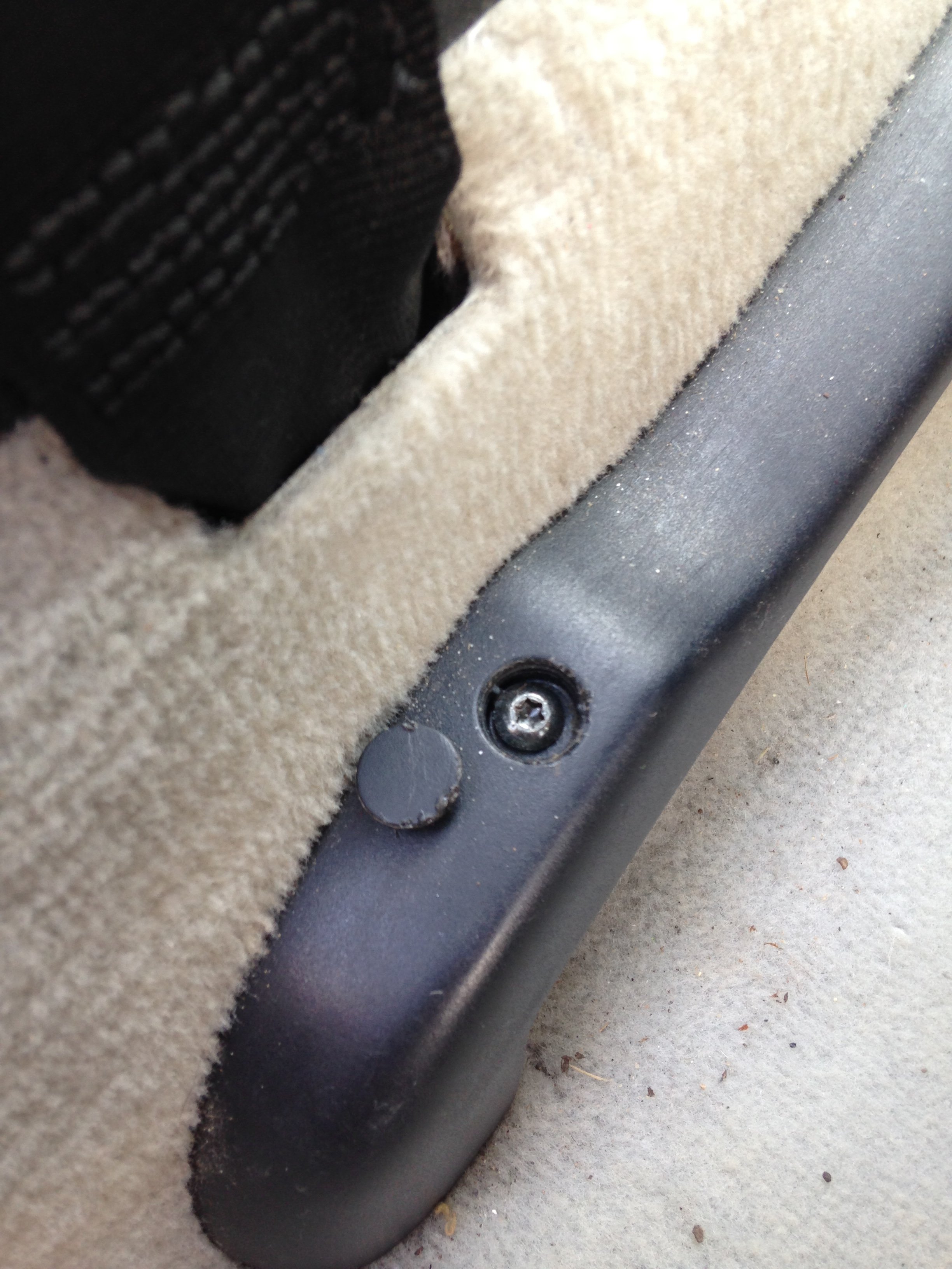

The fronts just require the runner trim removing (t20 torx) and two 13mm nuts. Once they're off push the seat back and unclip the seat belt wiring under the drivers seat.
Instead of struggling to get the seats ot of the doors I just pulled them out of the boot. It seems to make more sense.
In case you're wondering, the seats weigh about 21kg each.

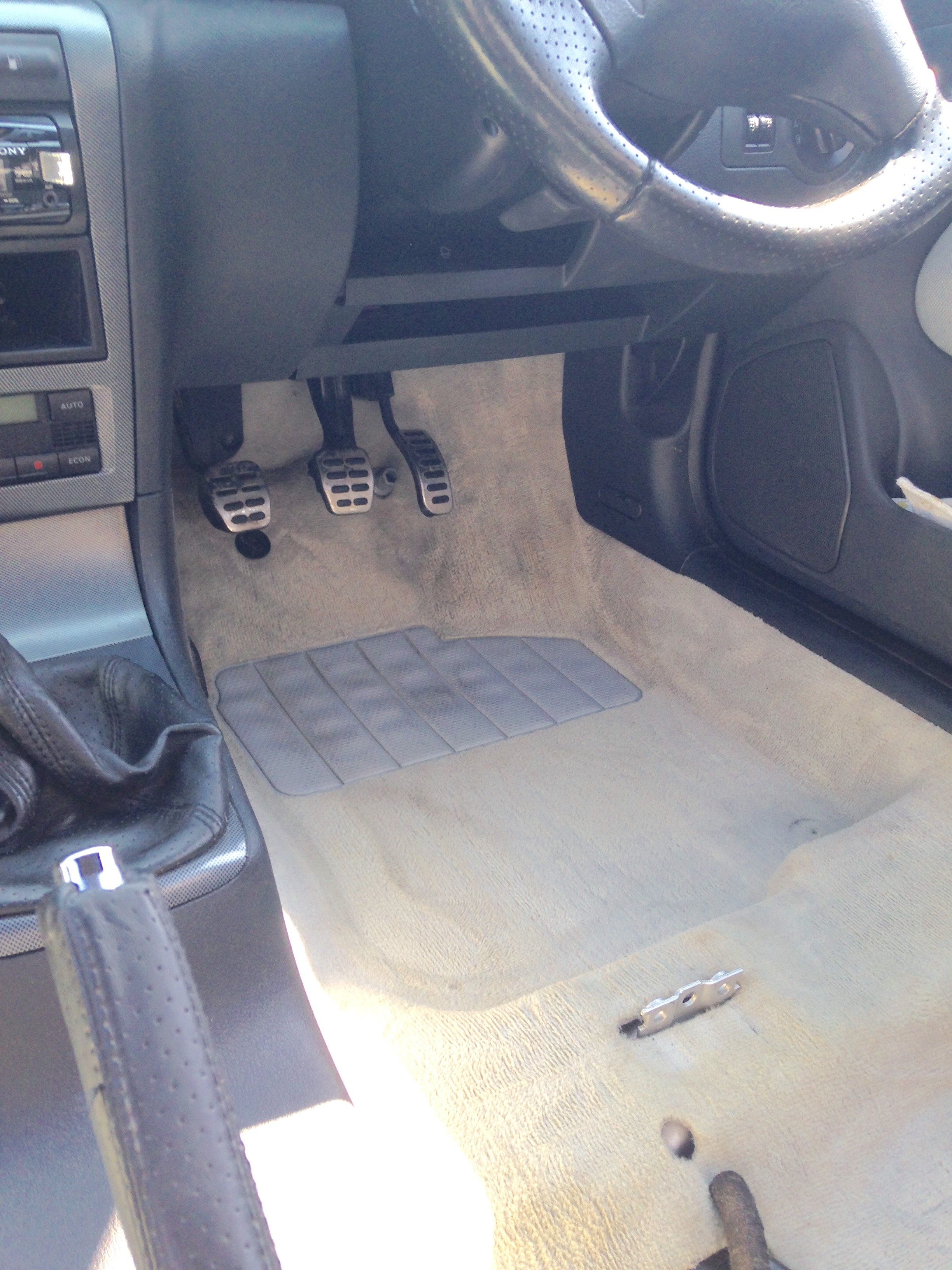

Anyway, I vacuumed then carpet shampooed the carpets then wet vacced them.
The area around the fast pedal was really stubborn and could be better but I'm too lazy to make any more effort and the missus is losing it with the kids so.......
the seats weren't too bad and are currently drying in the garden.  Should take about 10 minutes in this heat.
Here are some pictures.
