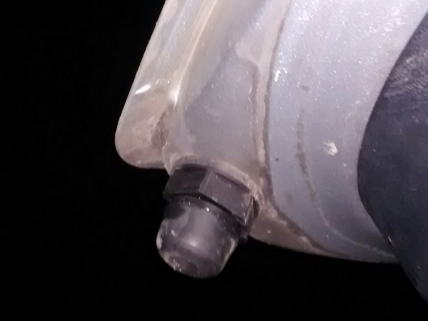

PS: I also noticed that I am missing a small nylon/plastic part from the underside of the tailgate. Not sure what it's called or its purpose but I want to replace it anyway - photo attached.

the rubber thing is:
6Q6 827 499 C stop buffer, adjustable
for rear lid
  2 pieces
for rear lid
  2 pieces
Many thanks Octavio. Must get one ordered
