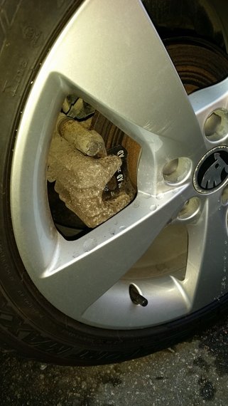

6. Any things to watch out for? I testdrived it and it seemed nice enough. The only thing I notised was that all four break calipers (is that the right word?) looked kind of old. But the dealer told me that this is normal and its because of the chemicals they use when cleaning the wheels. The car has also been sitting for a few months at the dealer.

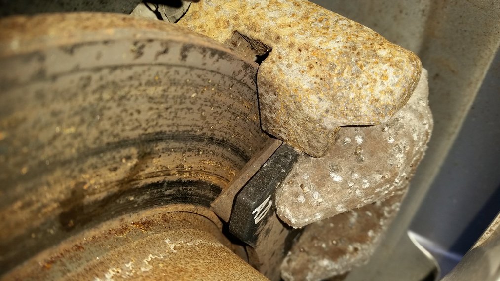

I didn't mean the rust on the brake discs, I know that is normal, but the calipers look kind of corroded or something as well. I have attached two pics.

I see what your concerns are now , regarding the brake calipers - they do look very corroded for a standing vehicle ! I would ask to see the underside of the vehicle umder a ramp, and ask has the car been subjected to water immersion, as I have only ever seen that much corrosion on something that has been really exposed to the elements, looks like its been standing in a field doesnt it or left with the wheels off somewhere ?
